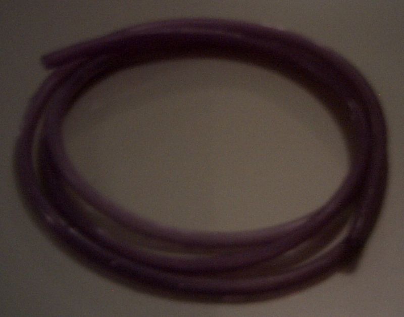

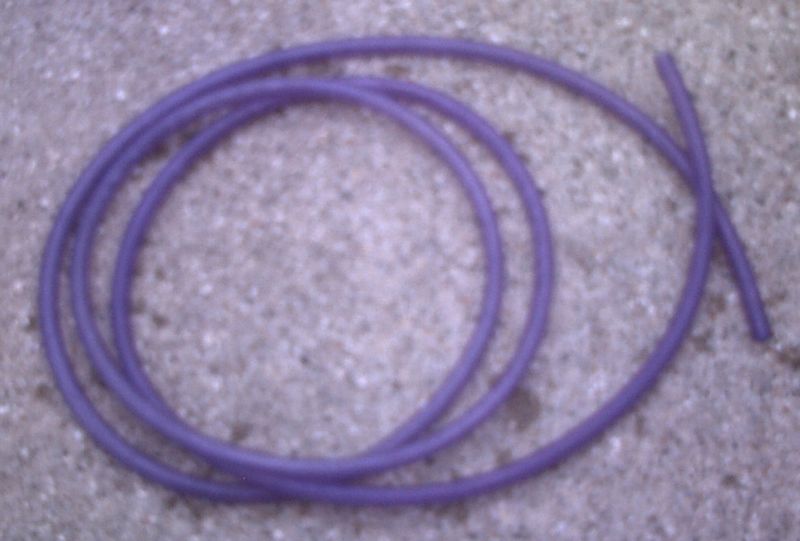

Post by groupleaderzeta » Sun Sep 04, 2011 7:27 pm
What do you get with 2 liters of boiling water, tablespoon of salt, a cap of RIT dye, and 10 feet of vinyl hose?......... Purple hose :lol:
I soaked the hose in the dye for 2 minutes for the final tube.
In the first pic the hose was in 10 sec... next 20 sec... next 30 sec... last test was 1 minute.
The final tube inside, normal light.
Then final tube outside.
tube test.jpg (9.5 KiB) Viewed 5832 times

Re: I.L. Series head build
Post by Red Eye » Mon Sep 05, 2011 10:10 am
Simple genius! :wtf:
But will it be enough to fill out one complete cranium?
Post by groupleaderzeta » Mon Sep 05, 2011 12:53 pm
I am not sure until I get to actually putting it inside the head, but it looks close.
The tube is 10 feet now and I can add more if needed.
