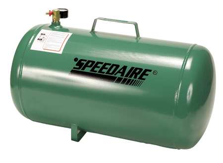

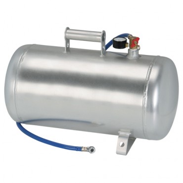

Ok Next up is my recomendation for aircans or airtanks!
Aircans or airtanks are great because you pull a vacuum on a can and store the vacuum. Mine is a converted 25 gal air compresser tank on wheels. and because it was a compressor at one time, it also has a steel mounting plate that my gast fits on perfectly! :!:
This is a 11 gal and is top of the line from W.W.Grainger.
This one is nice but spendy! comes with a air gauge you will have to change it out to a Vac Gauge. :ugh:
[attachment=3]Portable-Air-Tank-3EUJ9_AS01.jpg[/attachment]
You can get more specs on the tank here. Grainger Air Tank
This one is alot cheaper from Harbor Freight. this one is also 11 gal but is only $ 34.95 :grin:
[attachment=2]HF Tank.jpg[/attachment]
Here is the Link for this one Harbor Frieght Air Tank

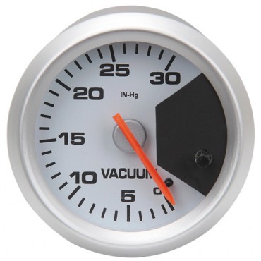

Next is the vacuum gauge pretty simple.
this particular one is kinda flashy but cheap any vacuum gauge you can fit on your pump or plumb into your system works fine!
[attachment=1]Vacuum Gauge.jpg[/attachment]
I think the colors change as the vacuum increases and decreses. Very Cool!
[attachment=0]Vac Gauge Colors.jpg[/attachment]
Harbor Frieght Gauge

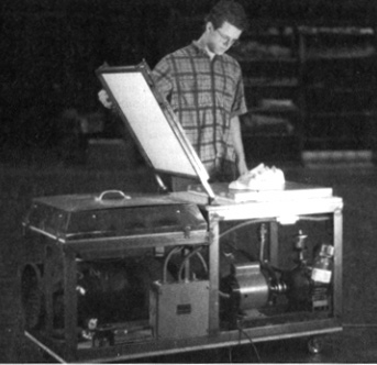

This is Thurston James's Vacuform machine from "The Prop Builder's Molding and Casting Handbook"
[attachment=7]James Thurston.jpg[/attachment]
You will see that this machine isn't far off from what we want to make! and the companion book to this book is "BUILD YOUR OWN VACUUM FORMING MACHINE by James E. Egner II"

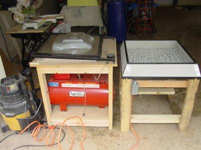

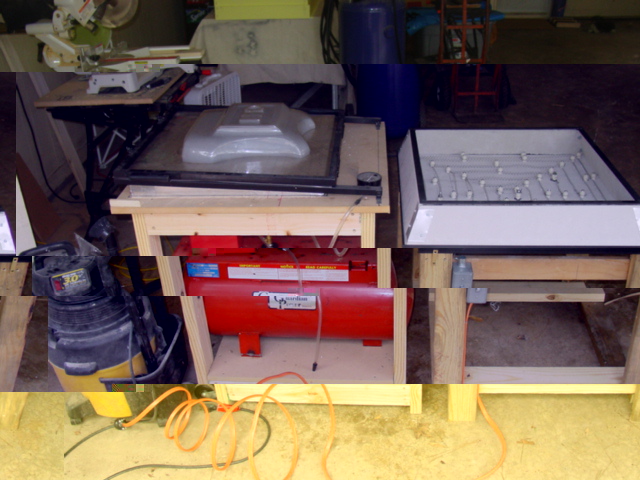

If your going to build one of these you will utilize a two stage vacuum system!
The real neat part of this build, is creating the oven and using Nichrome wire and little porcelain insulators because making the heat even is half the battle here and it works Great! :smile:
This is a Awsome Web Site and has a complete Photo Essay on building the machine in this book Complete with production pics showing the use of the machine to make Storm Trooper armor.!

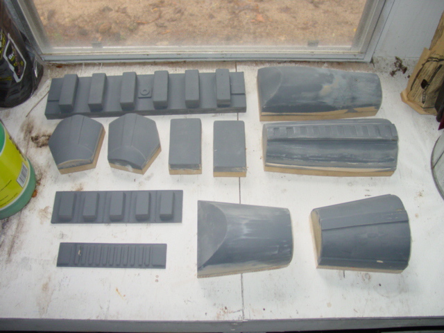

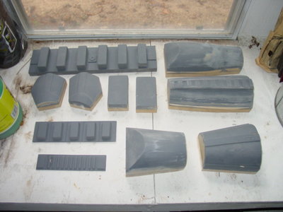

TK560 Vac Table
Here are a few pics from that site of Storm Trooper Armor created with a Flop over machine.
[attachment=4]Storm Trooper 1.jpg[/attachment]
[attachment=3]Storm Trooper 2.jpg[/attachment]

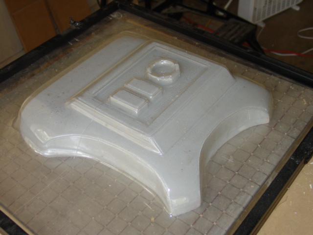

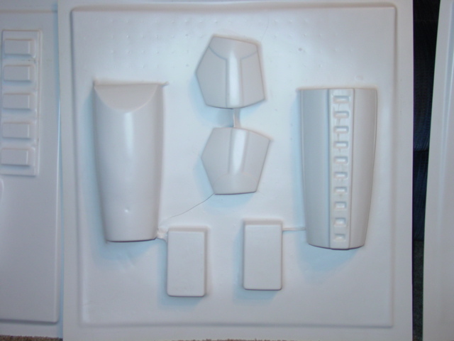

This pic is a good example of pulling multiple parts with one sheet.

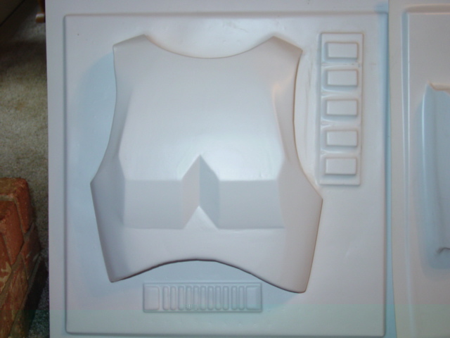

[attachment=2]Storm Trooper 3.jpg[/attachment]
Notice the webing between the parts we will talk about webing later and why this webing is acceptable.
[attachment=1]Storm Trooper 4.jpg[/attachment]
These are his Plugs
[attachment=0]Storm Trooper Plugs.jpg[/attachment]

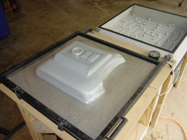

:arrow: 1. "FLOP OVER or FLIP FLOP TYPE". (Center Hinged Frame that flops over from heater to platen) Very good machines but they do have draw backs!
[attachment=1]Biy Vacuum Form Flop Over.jpg[/attachment]
The most common (and easier to build) among hobby guy's, is the "FLOP OVER or FLIP FLOP" method.
This method works great but again has definite draw backs. :ugh:

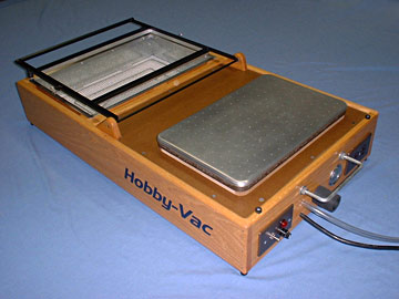

This is a Castcraft Hobby Vac. I have the plans for this one too but I never built it. My friend that I work with on these machine builds, has built this one and it works great! Unitil it doesn't! and that's what I will talk about here.
[attachment=0]hobplanphoto.jpg[/attachment]
The Flop type has been used for years and is a great machine! The dissadvantage of this machine is that the heater is under the plastic! and this can cause you all kinds of Felger Carb! :shock:
:arrow: First if you overheat the plastic, and is sags to far it will melt into your heater!, ruining yor plastic!, gumming up your heater!...and the most dangerous is that it can catch on fire! :erk:
:arrow: The second problem is when you flop over, you must flop at just the right speed and motion! If you flop to fast and hard, you risk the Balooning effect... Air gathers in your saggy plastic like swinging a grocery bag in the wind except that your plastic is hot and will stretch prematurely and begin to cool from the air and not pull properly over your plug.
:arrow: Third, If you flop to slow, gravity will pull down lateraly on your plastic shifting the sag from the center of your plastic when you reach the 90 degree point with your frame. This is not pretty :sad: the plastic starts to slide to the hinge point wrinkling and piling the whole way! The plastic get's destroyed before it ever touches the plug!
:arrow: The fourth problem is that the transport design is hingend between the heater and the platen so the geometry of movement is an arc, thus your heated plastic enters the pull at a 45 degree angle and can cause webbing and uneven pulling and cooling. This makes your part thick on one side and thin on the other depending on the gauge of plastic you use.
Even with all of these challenges, These are awsome machines and with a little practice and a willingness to waste some material learning how to do it, you can make some bitch'n parts!

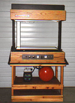

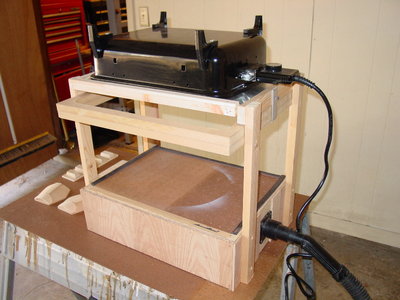

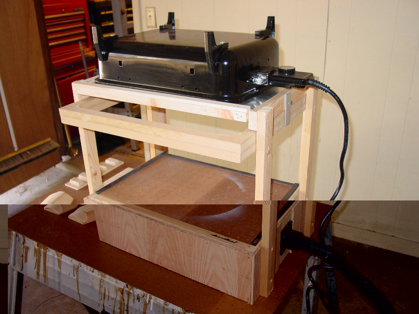

:arrow: 2. "PLUNGE TYPE". (Overhead Heater, and Plastic is Plunged down over plug and platen). These are Great! and this is the type I like best! :salute:
[attachment=2]Home made 2.jpg[/attachment]
The straight down method makes verry happy parts! :grin:
and what I found is that a single stage works good for pulling small or shallow parts but your machine is limited. Large parts, taller parts or Deeper parts are a challenge untill you decide it's time for a 2 stage sytem.... :smile:
With a two stage, the shop vac starts the pull and the high vol. vac is dumped just as the plastic starts to form. It all happens is a split second but the secondary High Vol. is strong enough and has enough force to pull the plastic over your lager or deeper parts!.
Also highly detailed parts require the Higher Vol. Vac to pull the plastic into all of the nooks and crannies.
The only problem with this method again is with the speed you transport your plastic and the distance between the heater and the platen. :erk:
Because these machines are manual, it's up to you to make a smooth transition from the heater to the platen. but it's alot easier to plunge straight down rather than an arc. However if you move to slow, you will get premature cooling resulting in webbing. :erk:
Moving to fast really isn't a problem here like in a flop over and the most important thing here is to be smooth but swift.
I mentioned the distance between the heater and the platen. Believe it or not even though the distance is only a foot to 3 feet depending on the size of your machine, that short distance can cause you a butt load of trouble! because the second the plastic leaves the heater it begins to cool. And the travlel time, (as fast as you can make it smoothly from top to bottom) still has an effect on your pull.
Just like before, Practice and wasted material is the only way you can reach near perfection.
The Proto Form Machine has a mechanical transport with an external handle and makes it almost flawless!
[attachment=1]proplanphoto.jpg[/attachment]

i pretty much made the plans, and assisted with the build. I have been wondering how well a rotocasted cylon helmet would chrome
Re: Basic Vacumm Forming and Vacuum Machine Building
Post by Big Al » Sun Jun 26, 2011 12:52 am
Huttman wrote:i pretty much made the plans, and assisted with the build. I have been wondering how well a rotocasted cylon helmet would chrome
I'm not to sure because I have never had to chrome anything for my planes.
I have created chrome looking parts starting with clear plastic and using a high gloss metalic paint from the inside of the part. and it works pretty good but I would consider it stand off scale. Because up close you can tell it's plastic but from 3 feet away it looks chrome....Anyway that's another subject....LOL
Do you have plans drawn up for this machine? and if so how much would you charge me for a copy? that is if you would be willing to sell me a copy.....I dunno maybe you want to mass produce them or somthing....
Just a thought....I collect plans for machines like yours and anything I can get my hands on for Home brew machinery that relates to my hobbies.
I have Vacuum Chambers I have made for removing bubbles from silicone when making resin casting molds.
I have made mechanical Hot wire tables for cutting large wing cores for my planes from blu foam.
I did have a print for a DIY CNC cutter for balsa. and I was working on getting the plans for a cnc laser cutter for balsa then my last lap top craped out :erk: and I lost the plans...but I'm going to do the research again so I can build those machines as well.
That machine you have is a work of art! :P
While I was watching your video I was thinking how in motion it does look like a small version of the Giant machine they used in the Jody Foster movie Contact! :cool:
If you speed it up maybe you can open up a worm hole!...LOL :lol:
