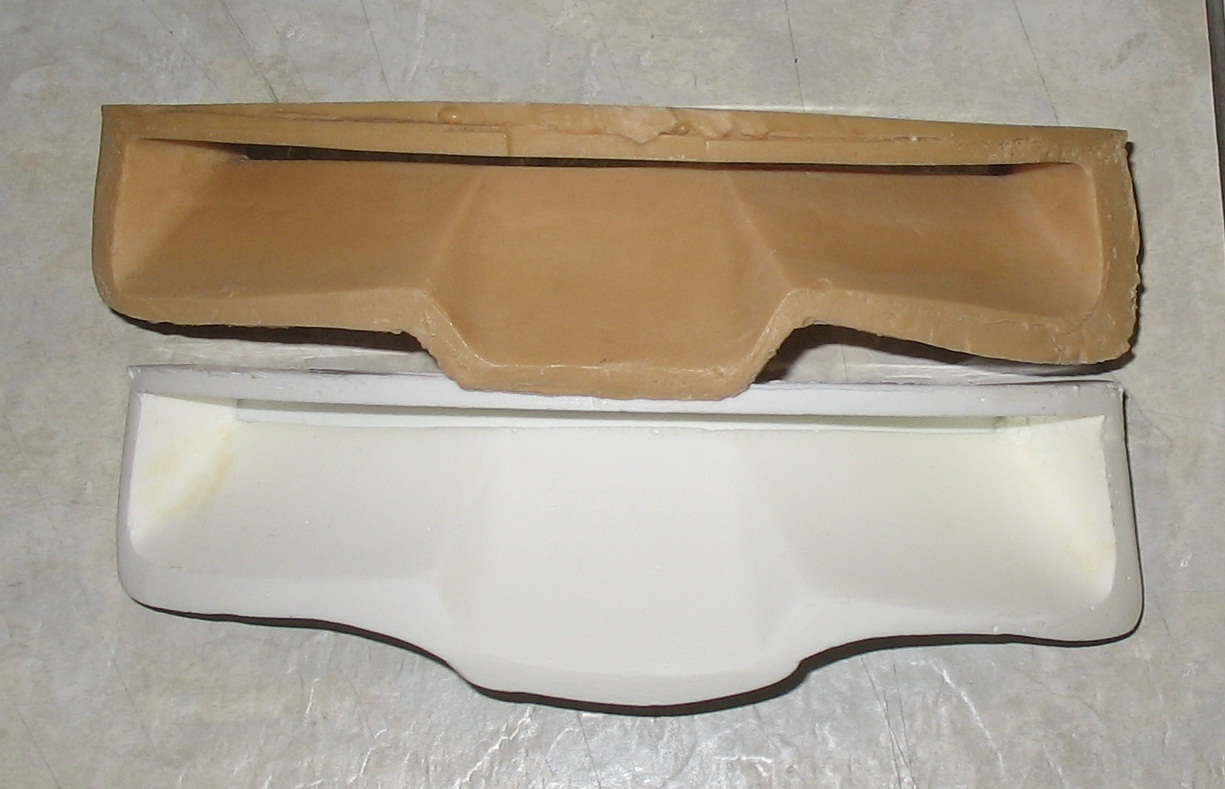

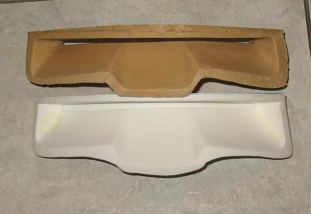

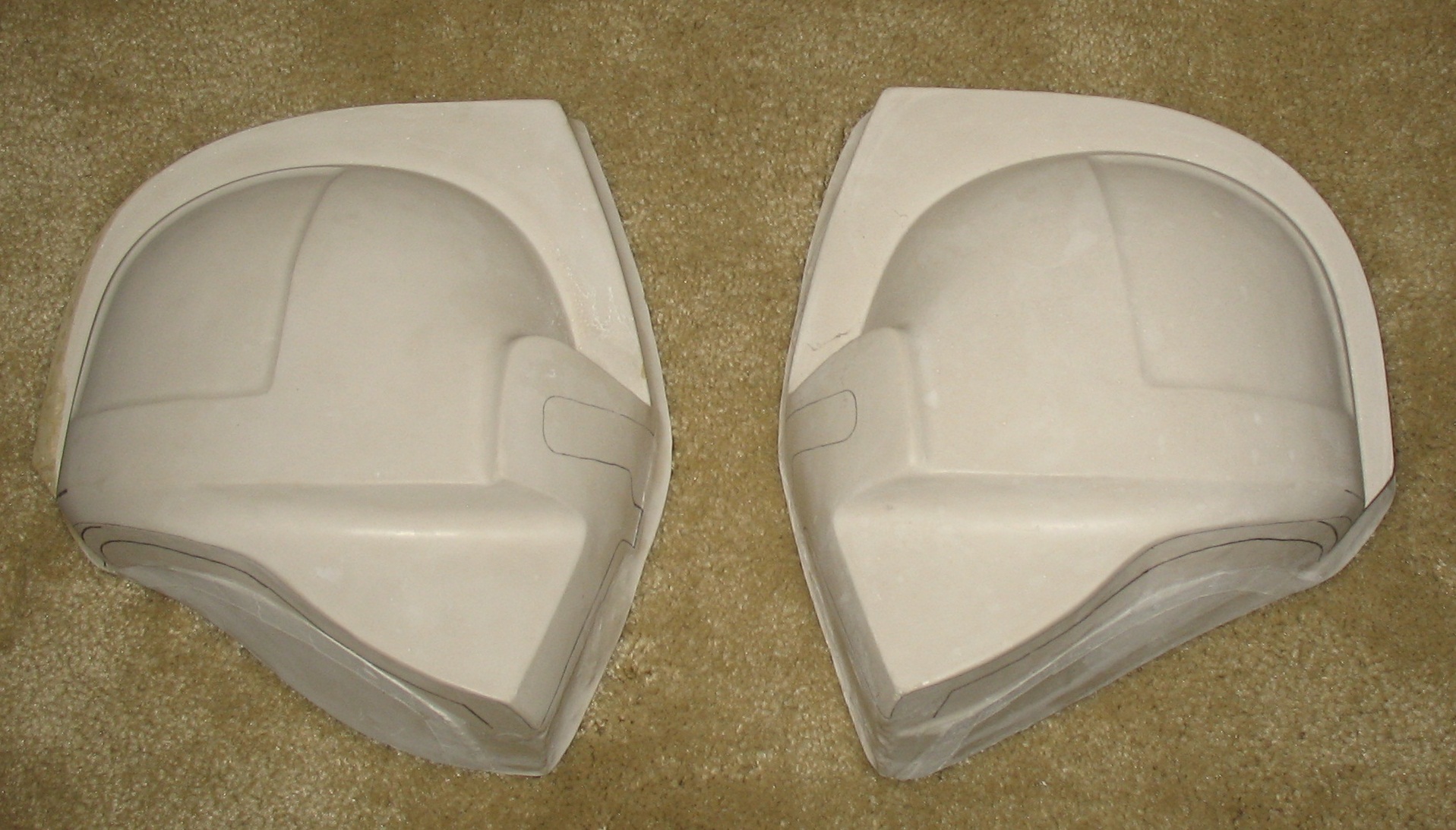

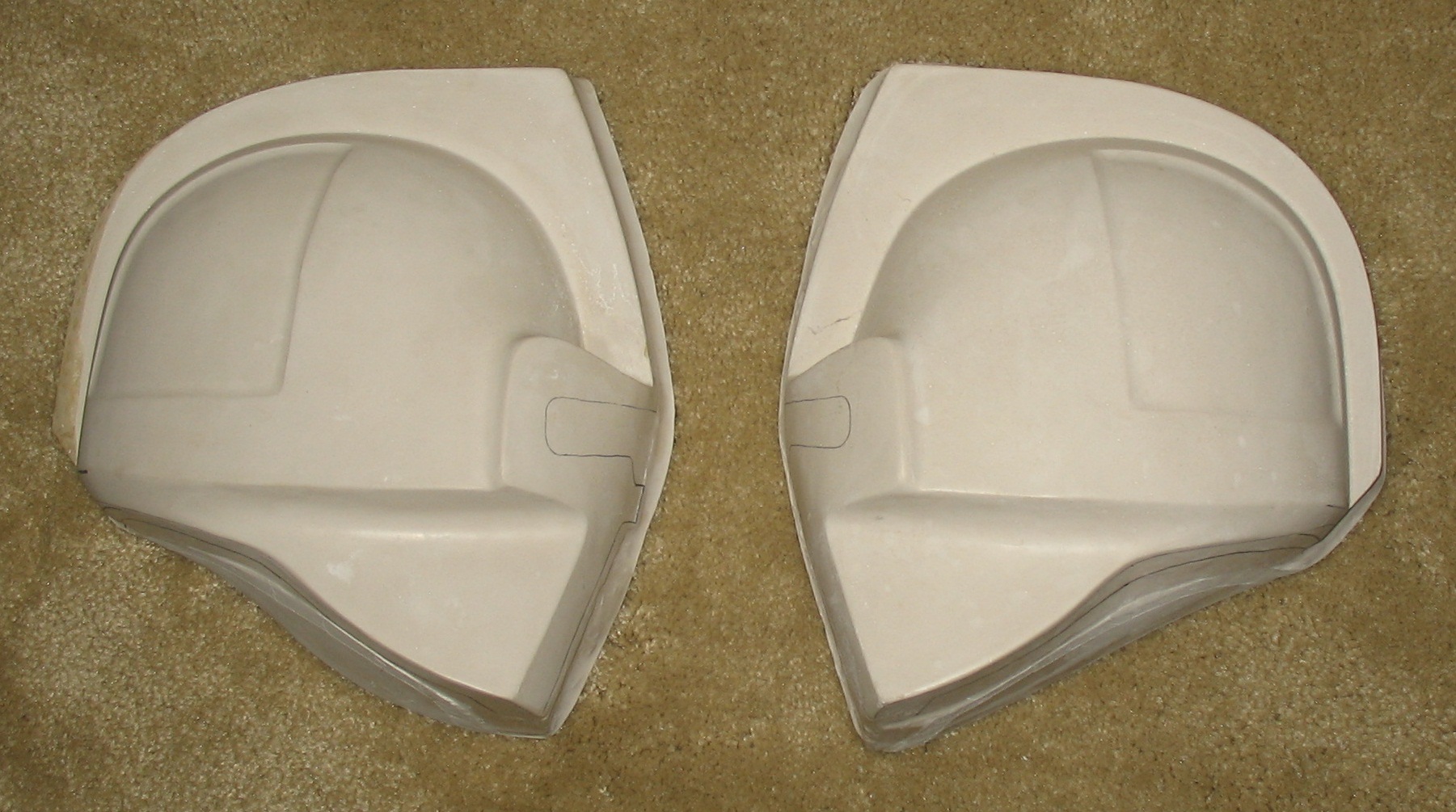

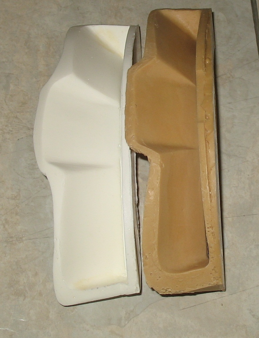

I can tell you that there were two helmet types. Thr Cylon helmet on the left has the common eye frame. The one on the right has the less common eye frame. I have added some pics of the two types of frames side by side. The yellow unit is from the helmet you see on the right. This casting came from an origional set of armor back in the eighties.

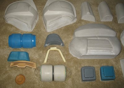

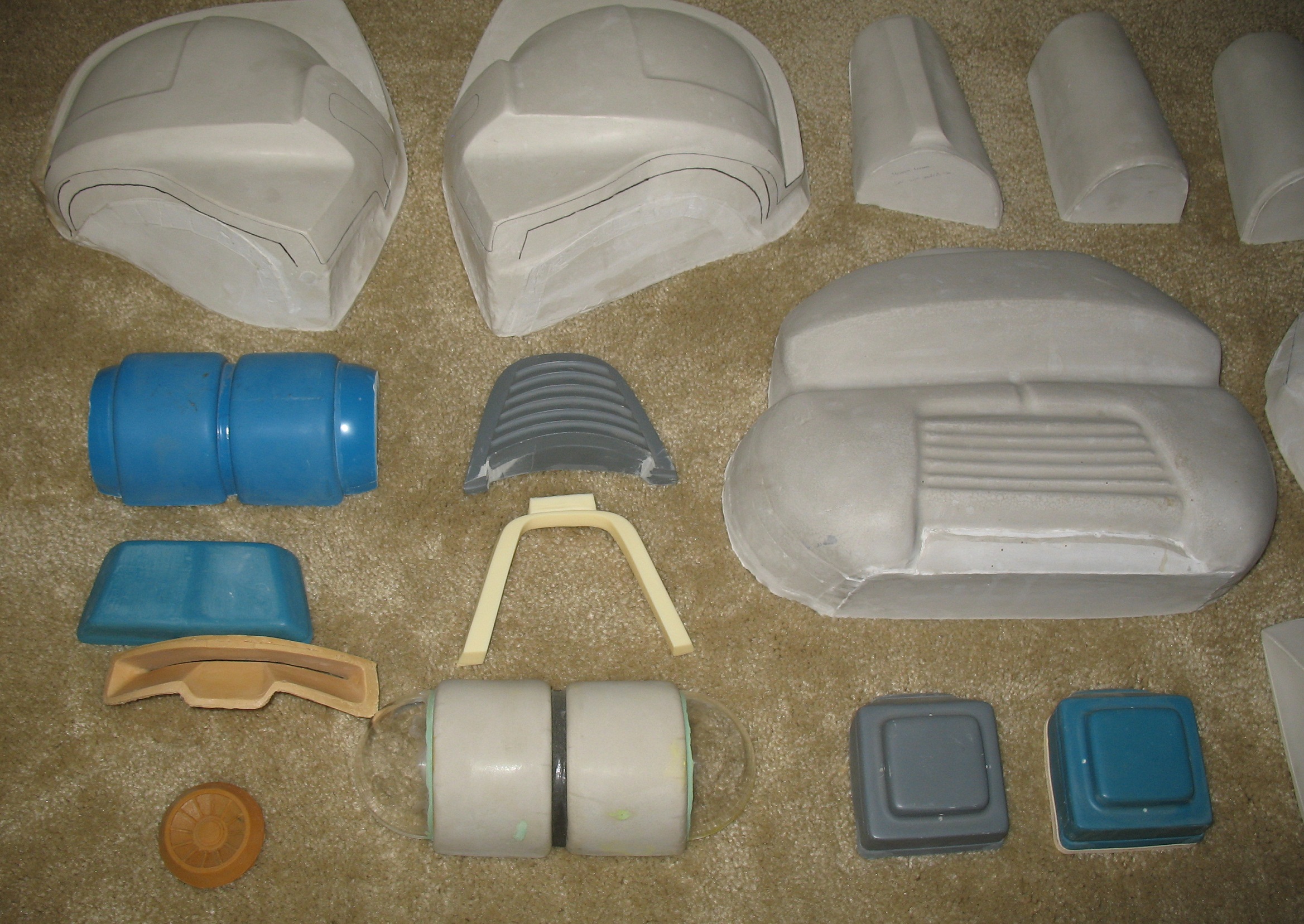

Here's the bucks I have for the more rare helmet.

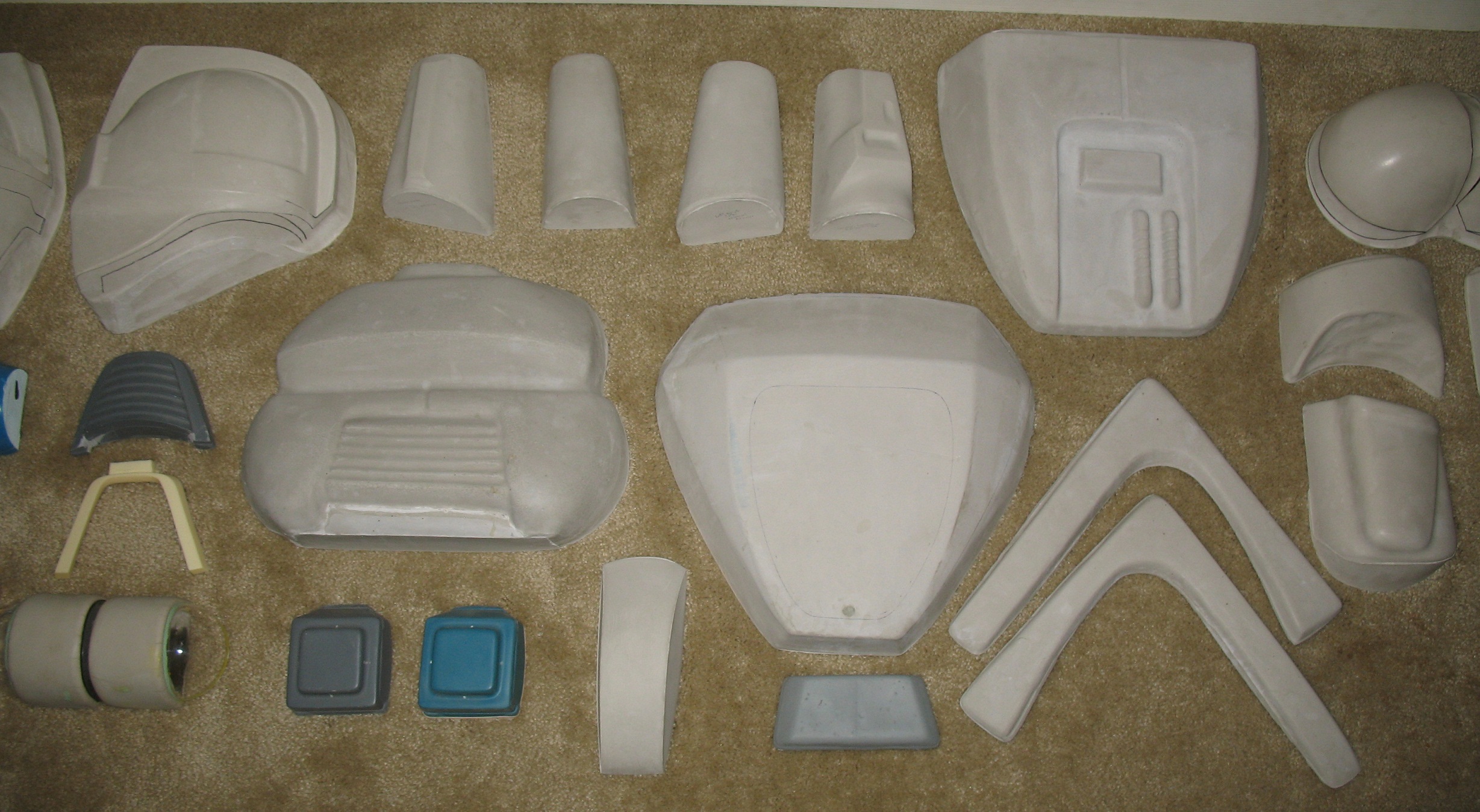

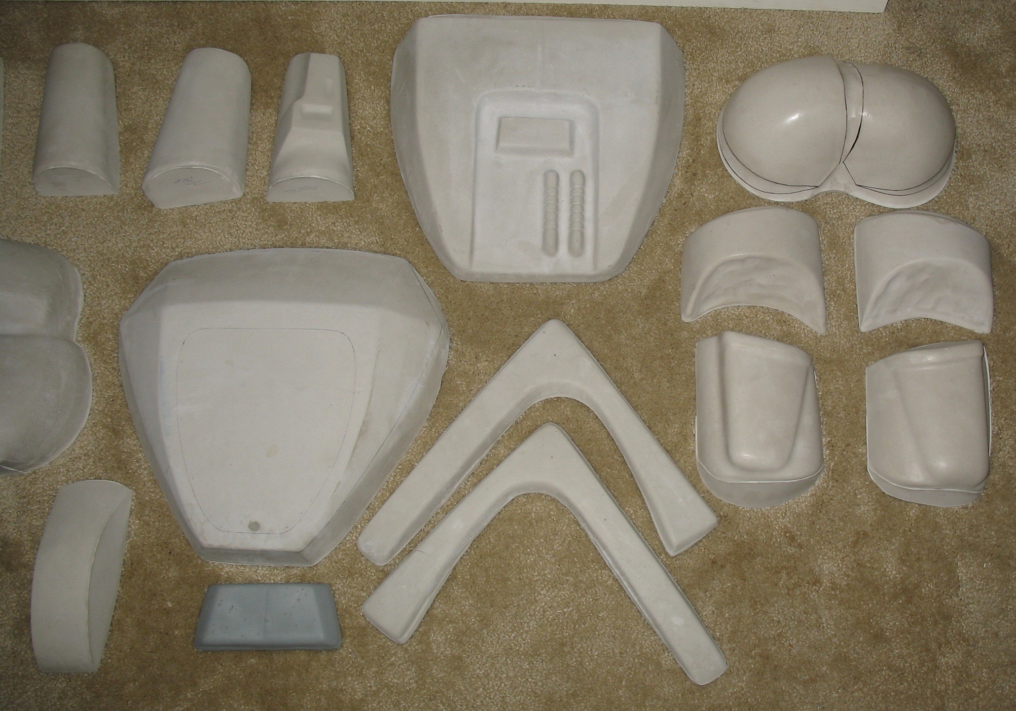

Yup! It is actually larger then Jim Sleeths helmets. I have all the parts bucks made of utracal 30. I was planning on molding those and making the bucks out of tooling resin to vacuform them. I have had these since the mid eighties.

I recommend 1630 from bjb for everlasting bucks.

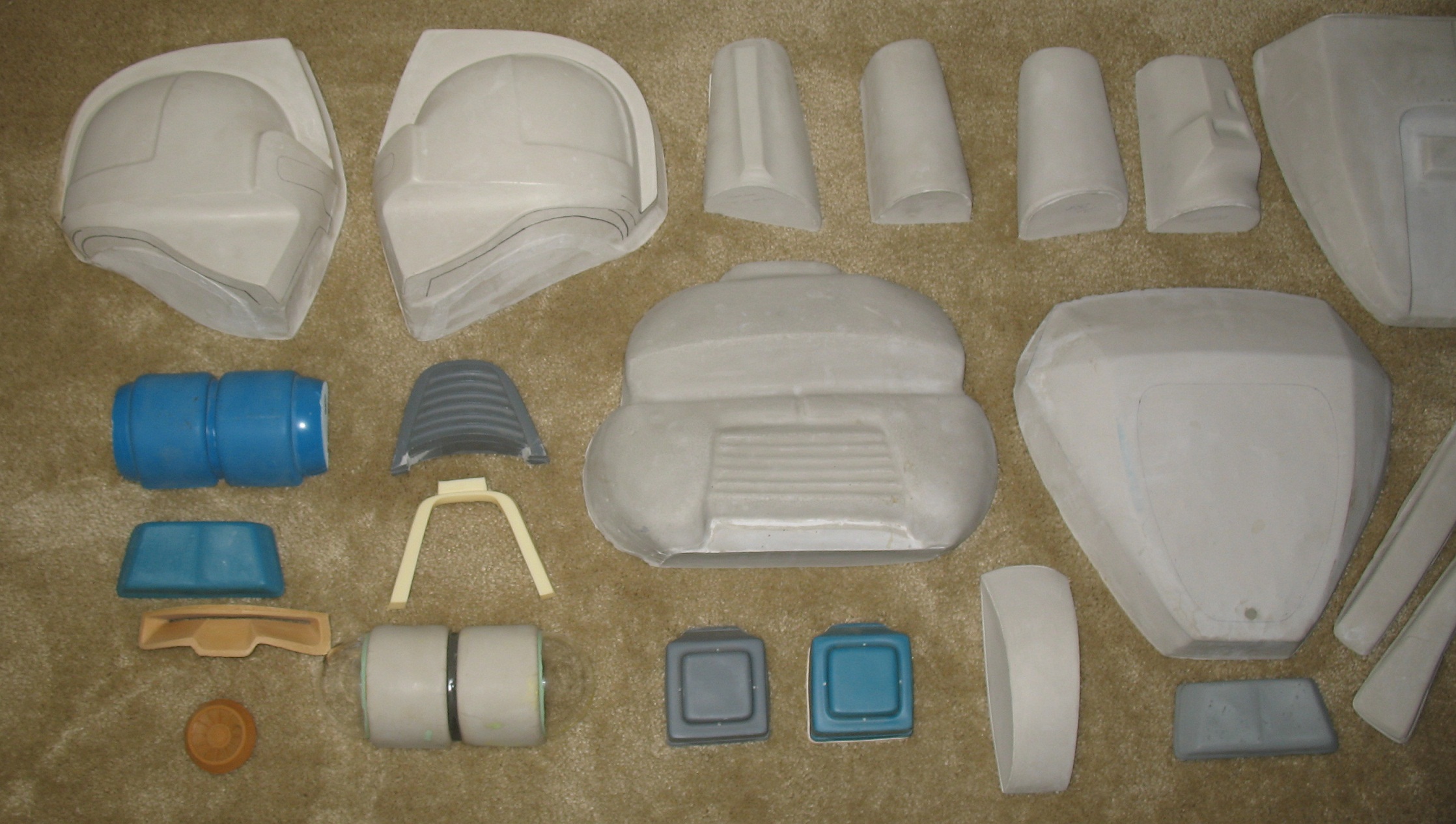

Here's the rest of him. The resin pieces have already been used as vacuform bucks and it works great. This project has been sitting for years. I just need a copy of an origional sword with the detailed knob on the end and a Cylon pistol and rifle.
Whats the shrinkage on the 1630 from BJB. The blue stuff in the picture is Freeman Manufacturing - Perfect Tool. It can be a bitch to stir because the fillers settle densely on the bottom of the can, but it does'nt shrink.

None, it's the same as perfect tool. that's what I used to use on the east coast.
