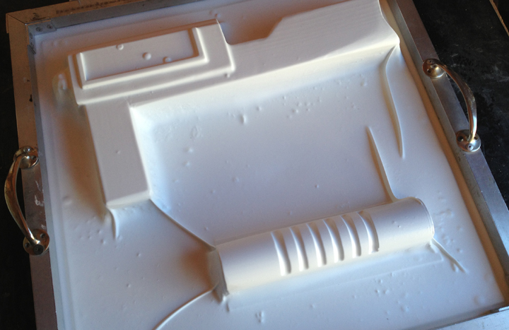

I *may* do a three part vac mold though, because I found the plastic doesn't suck in around the back of the receiver where the stock meets it.

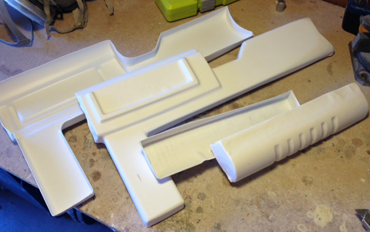

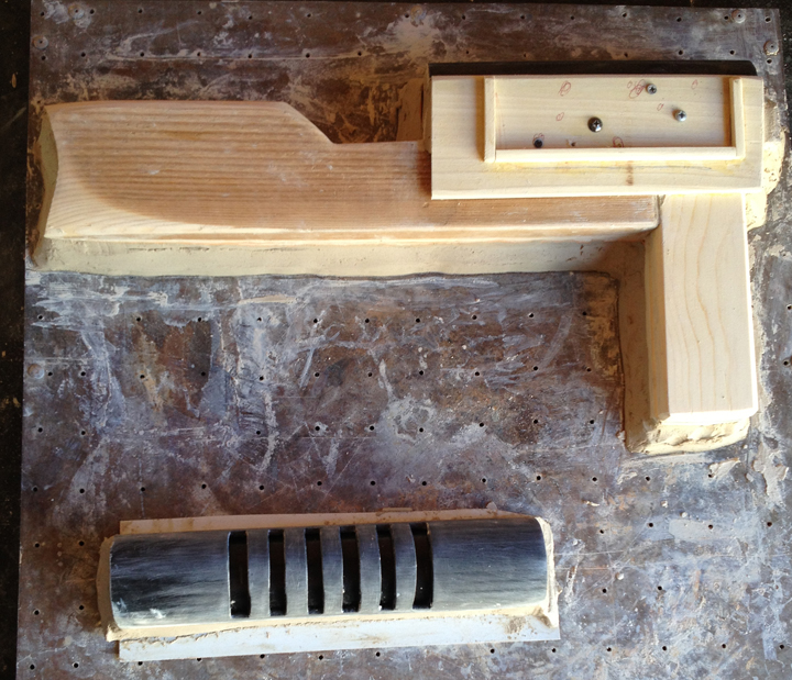

So the above it the prototype tooling. From here I can cast stone or fiberglass tools which can further be refined. I plan to fix the lines up (there are a few crooked ones) and of course get rid of the grain effect. But I'm pretty happy with what I have so far.

very nice, good work

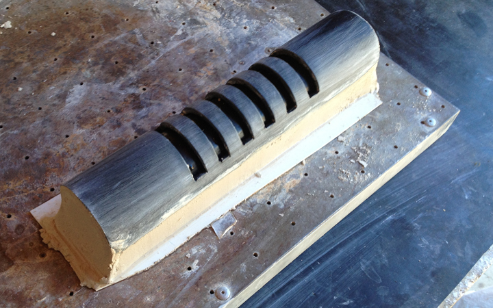

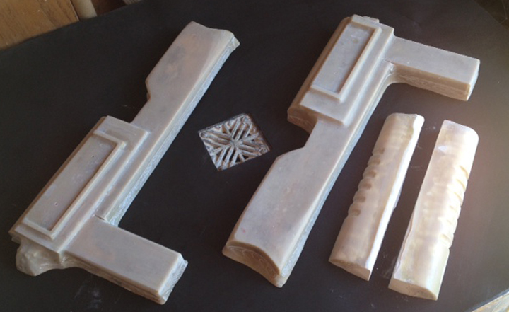

I have the tools cast in fiberglass and will extract them tomorrow. I can tweak them and hopefully have some new test pulls and possibly a built riffle (minus bayonet) by the weekend. Project is going well.
As a side note, I did cast up the lower tube in two parts. I looked at some samples and know I need to cast it in two halves in order to get a "shelf" for the clear tube to sit on. I'll show in pictures tomorrow.

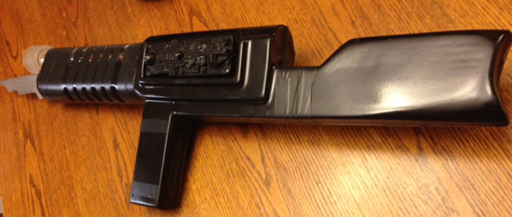

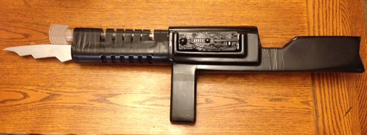

BIG UPDATE!

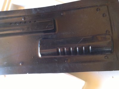

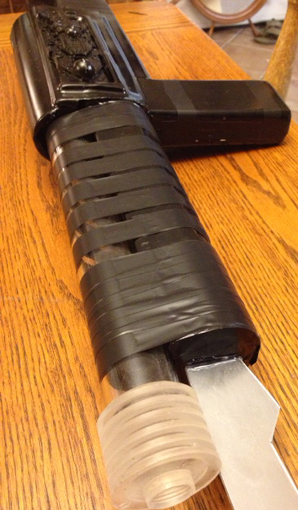

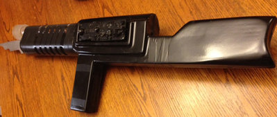

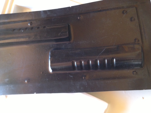

Prototype 1 is complete. Today was a very busy day. I took the fiber glassed tools out of the 'mold' and refined them. I streamlined the profile and tweaked a few small things. I vacuformed some new halves and was pretty happy with the results. I also tried some black ABS plastic which worked out pretty well. I only had 12x24 ABS sheets so I could only test it in the barrel shroud. I will try the whole rifle in ABS when I get some more.
SO... there were a lot of problems in construction. For the first one it went together ok... but not clean. The barrel shroud is a separate piece which causes issues in construction and I think I need to revisit the approach again. My machine only does 24"x24" so I am limited which is why I can't get the entire gun in one shot (like the originals are I believe). I may decide to make the butt stock a separate tool because I can make a strong junction at that point... better than the barrel.
Those who see detail will notice the barrel is shorter than it should but this will be corrected.
The muzzle tip is one I got a while back and I will need to have someone turn me new ones on a lathe. The bayonet is also a stand in as it is just a piece of cut plastic painted silver. Kind of looks cool actually...
So, I do intend to offer some of these to the board but I want to correct the construction issues I had which will in turn correct some accuracy issues as well. But for the most part... I have a rifle!! And yes, I was going for 'background stunt version'.

Perfect or not, it looks great so far! My compliment.
Somehow, I like the simplicity of how these things were constructed. Simple but effective IMHO.
