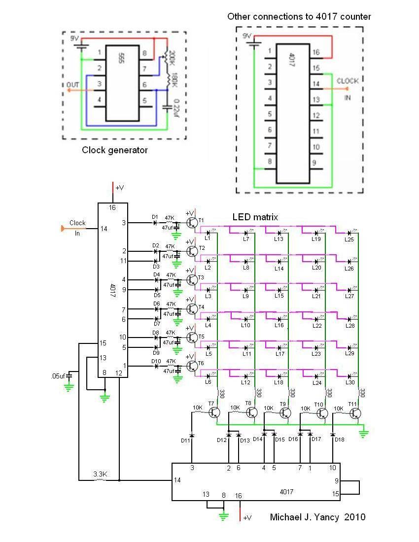

I have been thinking about the scanner idea. I am working on a concept schematic now, would anyone like to build a prototype to test it? One problem I need to work out, the circuit I have designed uses 30 or 36 LEDs, I am have much difficulty getting 32. Would 30 LEDs be good enough to work with a helm?
So far it uses just 3 chips and a small handful of other components.I will update this post with the schematic when its done.
EDIT... Schematic added.

Hello everyone,
That particular one uses the CD4017 decade counter as the main chip.
As to the micro-controller eye scanner, I am still working on it. To answer the above question, you would have to write the program.
Sean, If you are referencing the post with the schematic, Its for a different eye scanner.sean wrote.. Way cool!That total on parts doesn't include the chips right?I may be able to do this.so I would need those parts.the chips.and an interface and a program. is that about right?and were would we get this program? thanks for all the interest groupleaderzeta.

@ groupleaderzeta - Does your design allow for the "speed" of the scan to be adjusted?

Cylon-Knight, In the schematic, on the clock diagram there is a trimmer, this will vary the speed a bit from about 25 to 15 pulses per min (my calculations may be off).
