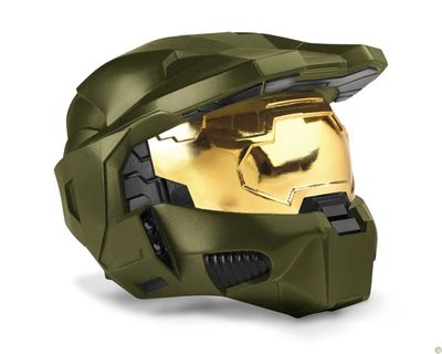

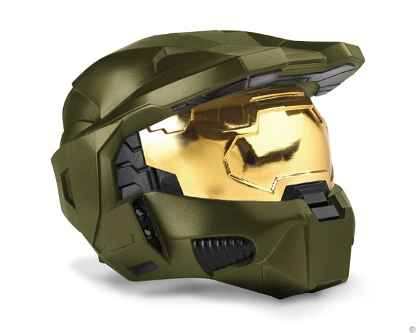

This is a Halo helmet made of HIPS (High Impact Poly Styrene)
[attachment=2]Halo Hips.jpg[/attachment]
High Impact Poly Styrene is very similar to ABS. and is very tough! and It is easy to form. :cylon:

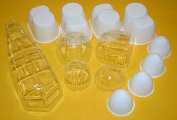

Most common use for High Impact Styrene is commercial products such as fast food containers.

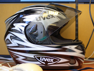

Also known as UVEX, This is a trade name for Eastman Corp. (Formaly Eastman Kodak)
It's most common use today is as a film coating in the manufacturing of safety glasses, Sun glasses, Helmet wind screens, cd, dvd's etc.
Uvex Helmet
[attachment=2]Uvex helmet.jpg[/attachment]

:cylon: Here are some links where CAB can be purchased
:cylon: Calsak Plastics
:cylon: Emco Plastics
Next up: PET-G (PolyEthleneTerephtalate Glycol ) :wtf: I'm glad we shorten these names. :lol:
