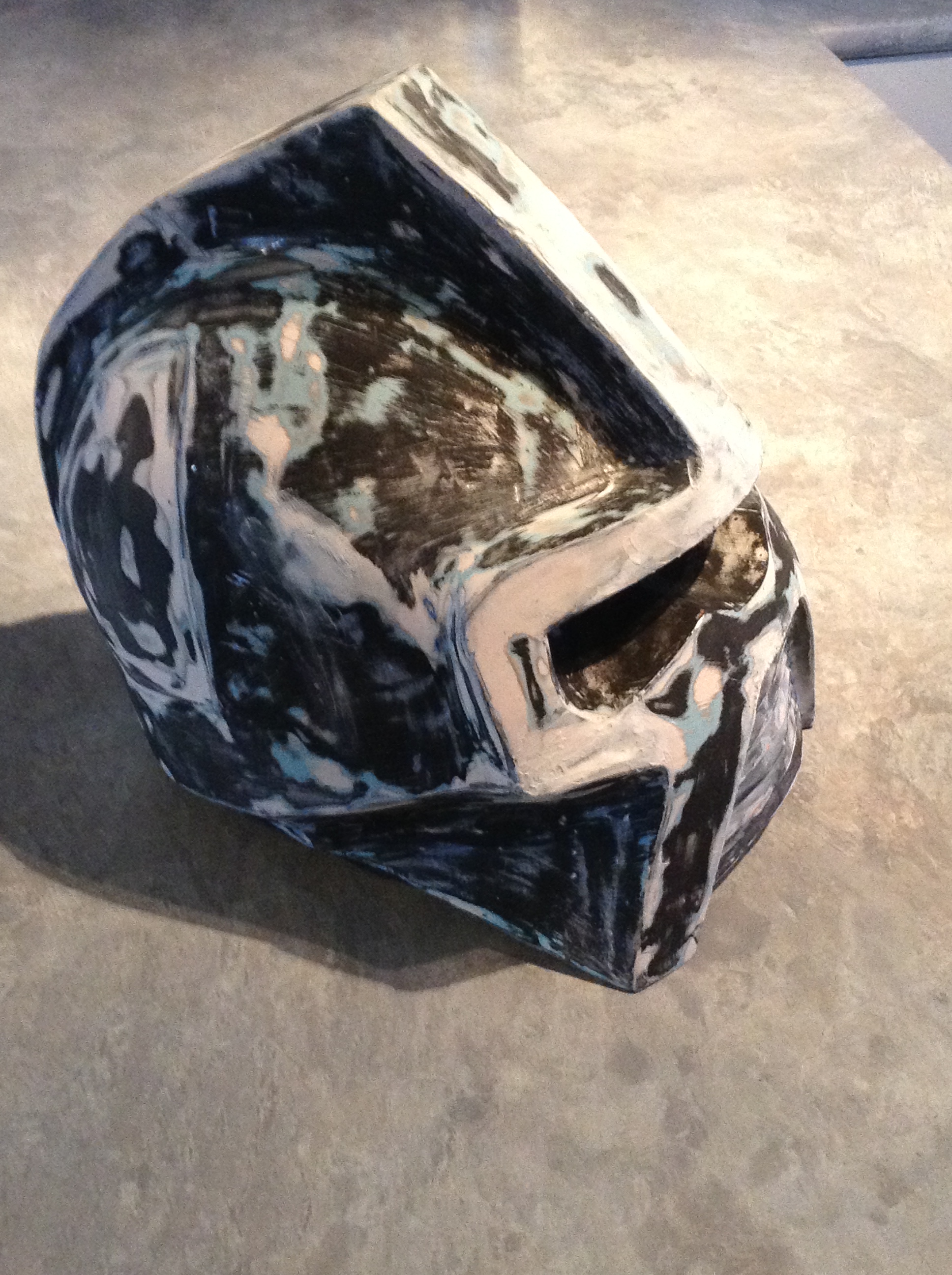

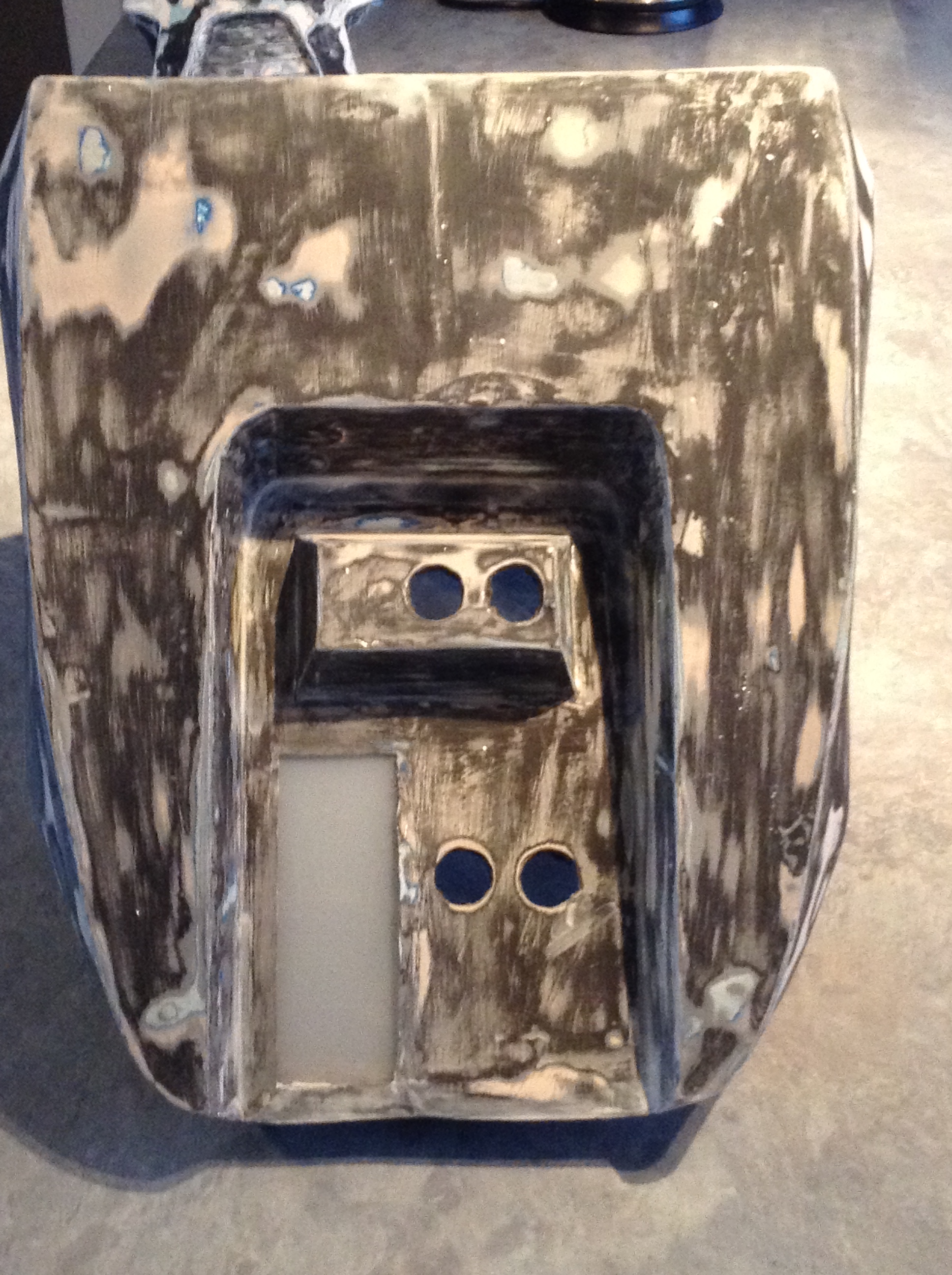

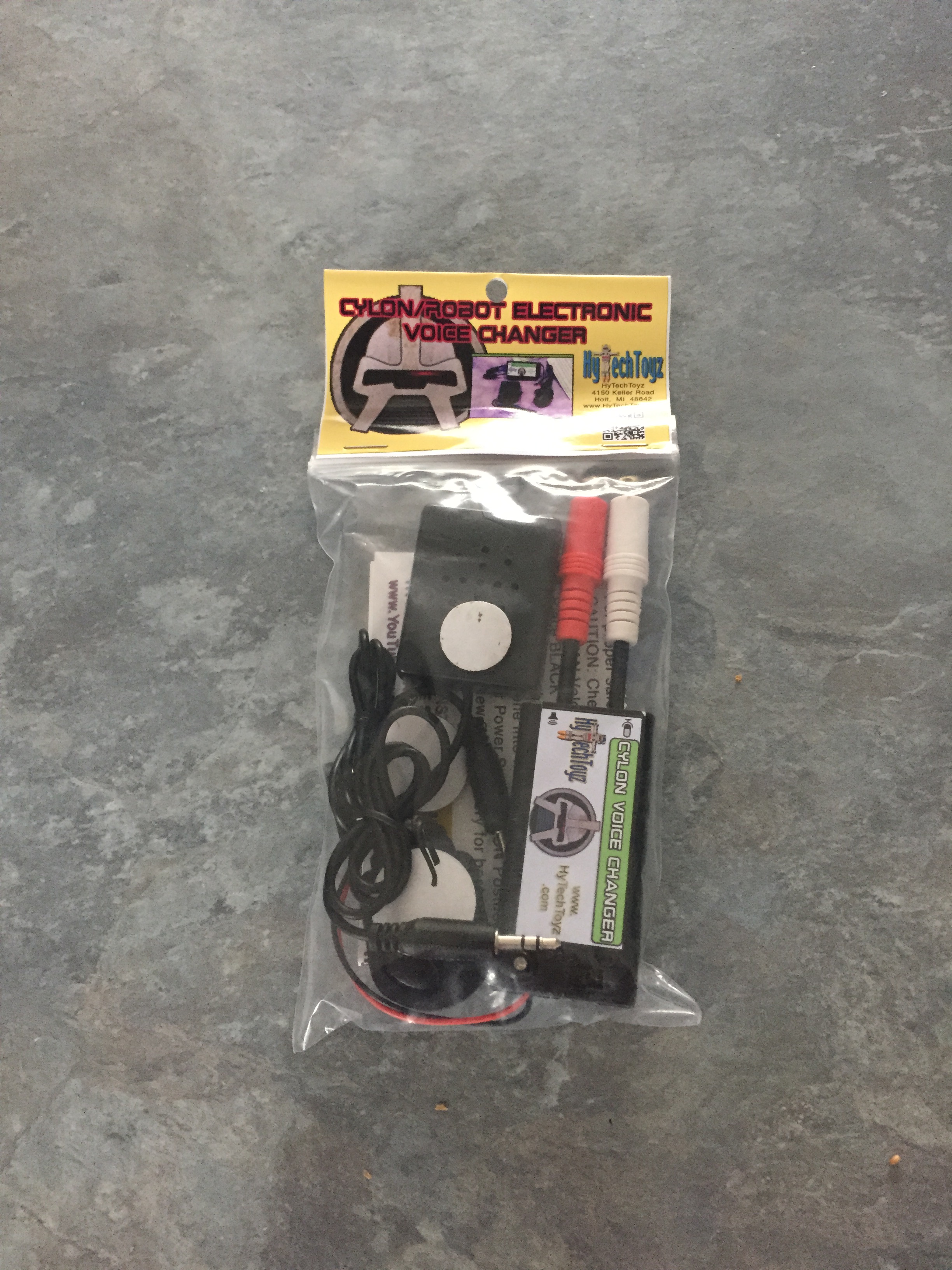

G'day, it’s been a little while since I last posted, however I have been busy with the other two builds and re-doing the first one after Supernova Melbourne.
That was a great run and showed me what I had to improve on. A small fix turned into a big overhaul with everything being sanded right back, applying more body filler and strengthening sections. Over all it was a blessing in disguise as the finish quality now is a lot better. I added the bits for the boots and also added a Cylon voice changer which isn't great but a lot better than nothing. The only issue I really had with the voice was that the speaker that came with it isn't powerful enough so some bigger and better speakers are next. I also repainted in a silver metallic instead of the chrome and it came up a lot better than expected. Now it won’t rub off and turn grey. we also undertook a lot of stitching and didn't rely as much on Velcro.

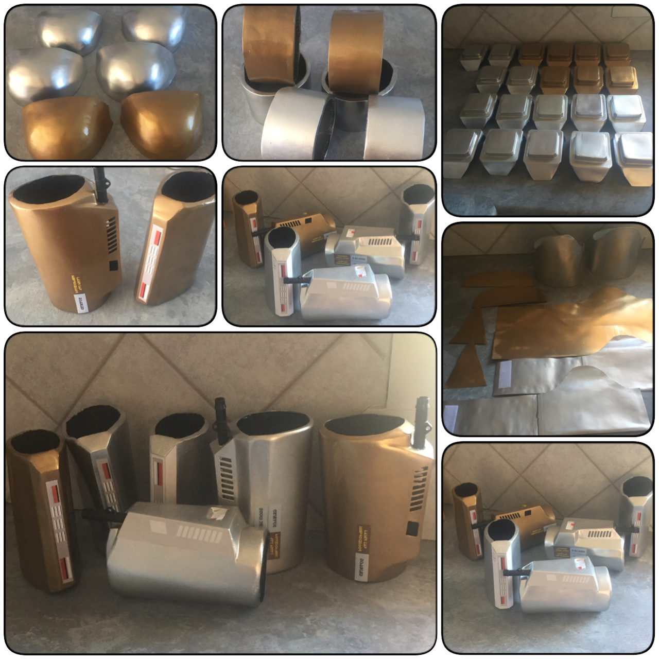

Work in progress, and enjoying it...

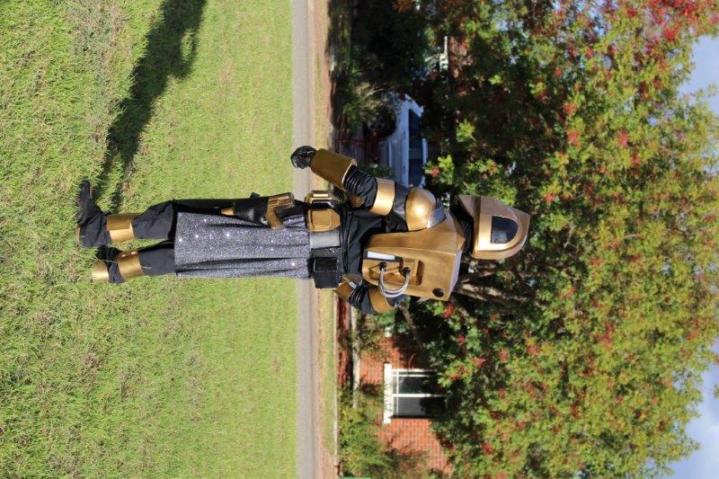

It has been a while since my last post, however I haven't had much to report back on. I believe I have now finished my Cylon builds. This has been a long build but I have now got something that is solid and works great. It took a number of Cons and many hours wearing it to workout what needed to be improved. So this is mark 3. Some of the improvements I made which had to be striped right back was increased thickness (Body filler) on the side of the backpack and on the mohawk of the helmet. extra thickness on the inside of the chest. Reinforcing at certain locations on the armour where you handle it the most by lifting it on and off. Because its made of paper it did flex a little which caused cracking in the body filler, when I say extra thickness I increased the 5mm body filler thickness to 10mm.
I also added lots of padding which only wearing for long periods could get it right. Firm padding on the shoulders for the backpack, soft padding on for the gauntlets and median padding in the helmet, the padding points in the helmet was tricky, and have added permanent fixing points for all the electronics, eye, voice and batteries in the helmet. added permanent fixing points for large speakers (for voice) in the backpack and one small speaker in the belt for the sweeping eye sound.
Also added some straps between the chest and backpack which really stabilised everything.
The biggest issue I had was connecting the chest to the neck section of the backpack, I tried lots of different ways such as Velcro, tape, steel clips, magnets which nothing worked and always resulted in extensive repairs needed to be made to the chest piece. I now have a fixing method that works great and was recently tested at Supernova Melbourne and that is to bolt the two sections together through two 5mm wood panels. You may not like it as its not correct however it works...
I also had paint issues, and got my hands on some Spaz Stix Chrome paint which worked great and was able to seal it.
I also painted one Gold, which took a number of tries with different types of paint. still not sure if I like it or not but it was popular at Supernova.

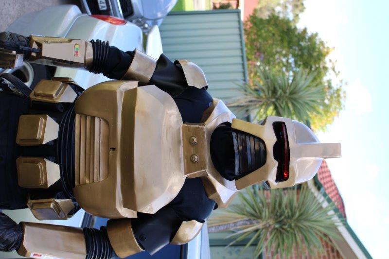

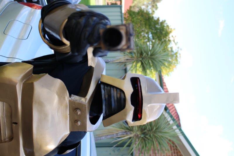

Some Photos, not sure why they are displayed sideways. The mouth grill has white parts on it which only come up through the photos and is not evident when looking at it, I think it might have been un-buffed wax.

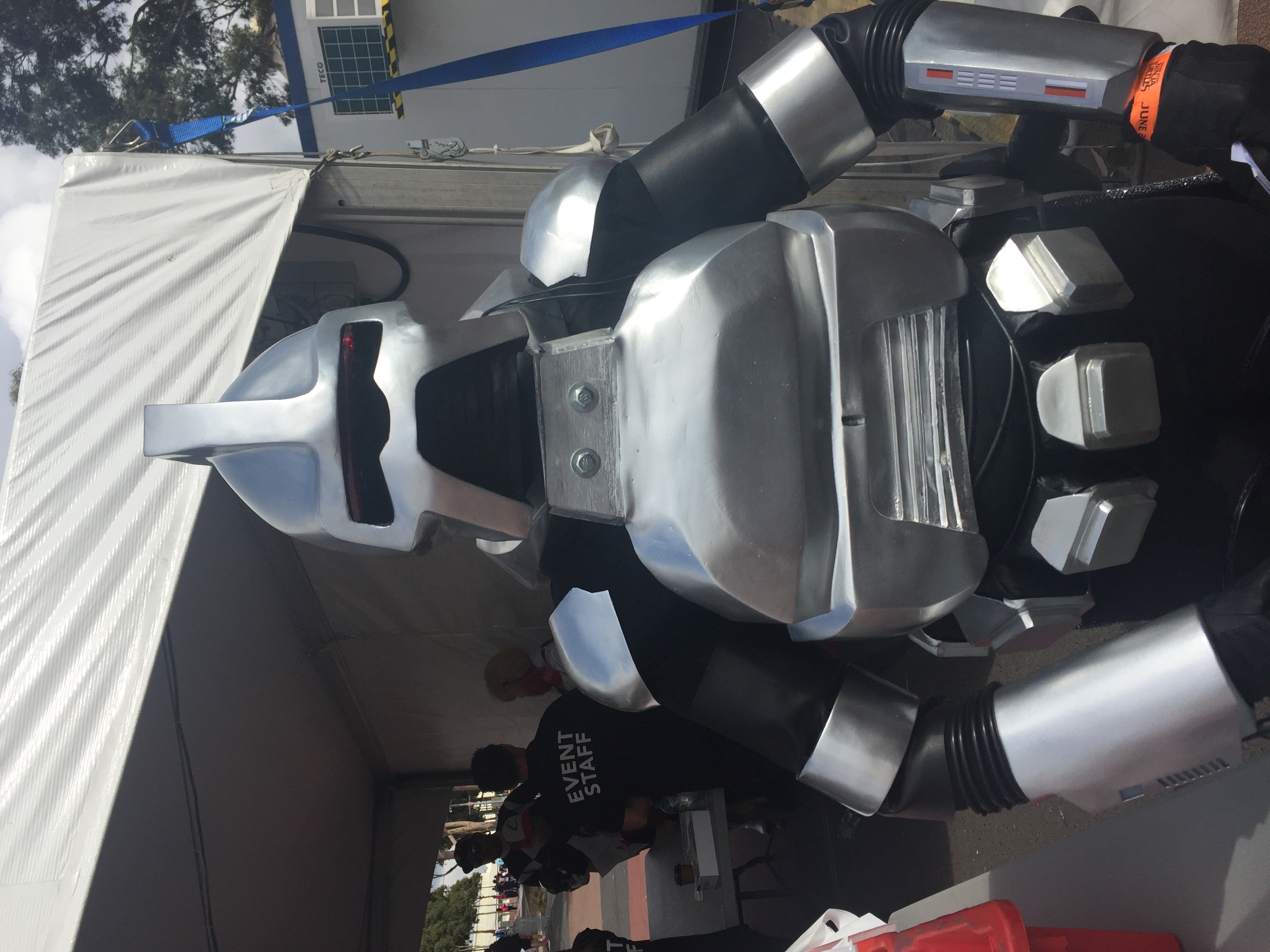

Supernova last week, unfortunately with both in character I didn't get many photos. We were an awesome sight and very popular.
