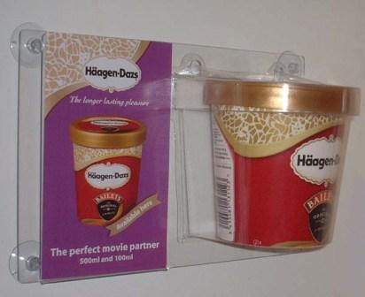

Displays
[attachment=4]Pet g display.jpg[/attachment]

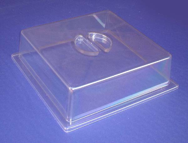

Food Covers
[attachment=7]petg_food_cover_1.jpg[/attachment]

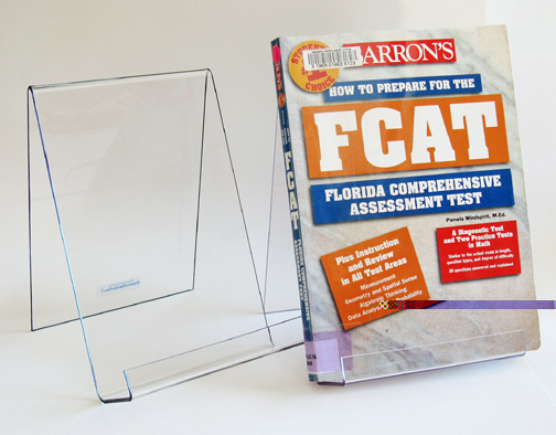

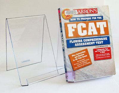

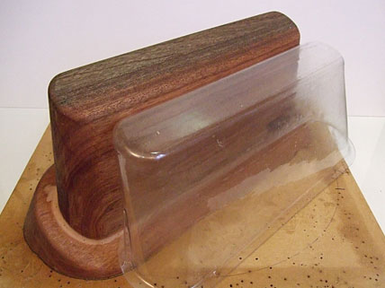

Universal book/ catalog stand
[attachment=6]Pet -g stand.jpg[/attachment]
It is also widely used by hobbyists like myself to make parts that require clear plastic. :wink:

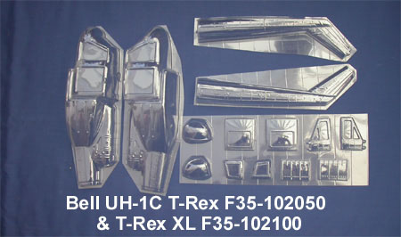

One important reason we use this plastic is because it has great Detail Retention.
I think this is a canopy for a B-17 ...hard to tell because the pic is there but the site is gone :huh:
[attachment=5]pet g canopy.jpg[/attachment]

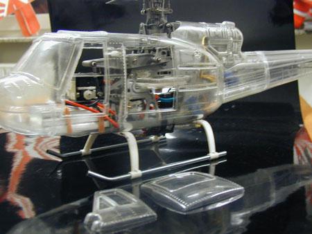

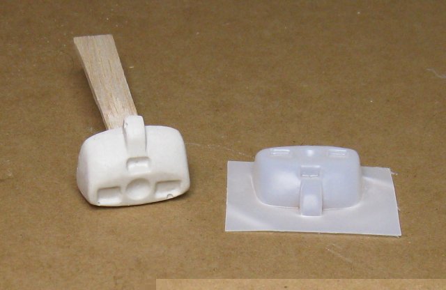

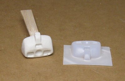

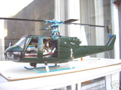

This is a Huey Helicopter body with doors
:patch: Notice the rivet details :patch:
[attachment=3]Pet G Heli 2.jpg[/attachment][attachment=2]Pet G Heli.jpg[/attachment]
And here is the finished Heli with paint
[attachment=0]Pet g Heli 3.jpg[/attachment]

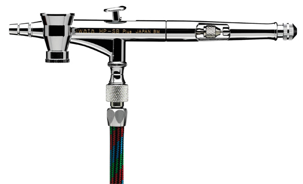

I know I bosted earlier about Keep it simple stupid...(Meaning myself) but I never do anything easy! LOL :ugh: another advantage of airbrush is that you can control the Paint flow, amount of air and the fan thickness from a super fine line to a wide fan.
Of course you can only get these features on a med to high end brush such as an IWATA
These are the guns and brushes we use
This one is a general use gun and is very adjustable
[attachment=2]IWATA HP-CH240w.jpg[/attachment]
This one is a detail brush[attachment=0]Iwata HP-SB-Plus600w.jpg[/attachment]

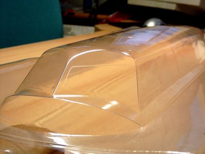

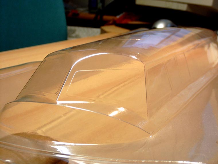

Post by Big Al » Fri Jul 01, 2011 2:04 am

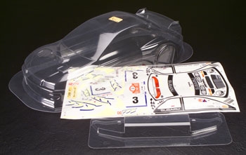

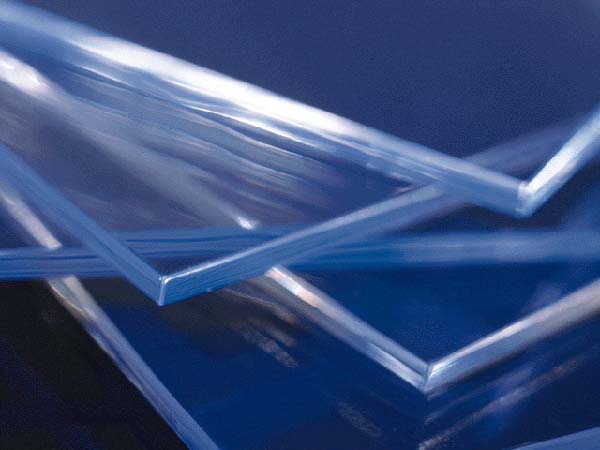

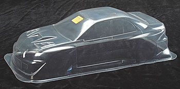

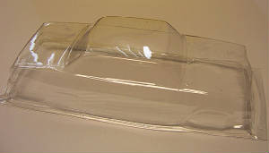

:cylon: Polycarbonate
Once again Polycarabonate is of those very universal plastics and is used in thousands of our modern day objects and products.
[attachment=4]Polycarbonate_Film_Polycarbonate_Sheet_PC.jpg[/attachment]
Polycarbonate is Very Very Tough and difficult to form and is the most expensive. Polycarbonate is however the most impact resistant Plastic you can form and is most commonly used in unbreakable windows and signage.
It will withstand Continuous temps up to 250 degrees and for these reasons is exactly why we use it to make 1/10 scale R/C Car bodies
[attachment=3]Poly Carb Car.jpg[/attachment]
[attachment=2]Poly Carb Bodie 3.jpg[/attachment]
[attachment=0]Poly Carb Body 2.jpg[/attachment]
:salute: Polycarbonate is alot harder to form in that you need higher heat starting at 350 - 400 degrees and some brands even higher 450 or more. The book recommends that you start at 400 and increse if needed.
You need quite a bit of vac for this one because Polycarbonate cools so quickly and Single stage vacs do not work very good on Polycarbonate. The 2 stage high vol is the only way to go here because the High Vol provides the BIG SUCK FAST!!. :wink:
This plastic comes in clear and tinted colors from .005 to 1/2 inch in thickness.
When heating and pulling Polycarbonate you may have to pre-dry it first and this can be done at a temp of 200 to 225 degrees for about an hour. Polycarbonate begins to sag at 250 so keep the pre dry lower
The sag starts at about 250 but if you poke it with your finger it will still be hard.
Polycarbonate is one of those plastics that cools and hardens fast! so you have to work quickly! If you are using a large plaster plug they tend to be on the cool side and your Polycarbonate will set almost on contact so with a plaster plug, you can pre heat your plug at about 200 to 225 at the same time you are pre drying your plastic. Use a cookie sheet to set your plug on the inside of your oven before you make your pull.
Polycarbonate sags at a moderate rate and is almost the same as PET G. You can use this to your advantage as you can pre stretch your plastic for deeper pulls. :!: But be careful :!: Polycarbonate speeds up as it sag so you have to watch it closely :police:
A quick note: Though Polycarb is used in unbreakable windows, It can indeed crack! :nah: I have seen many car bodies crack after a crash or run away car into the wall. Not that this would be a problem in a cylon suit but I think the reason this happens is because way it was cut. If you have a nick or a chip from an unclean edge or in the case of a car, a drilled hole for a body post and then it is impacted hard it will crack! :evil:

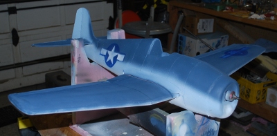

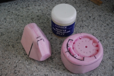

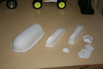

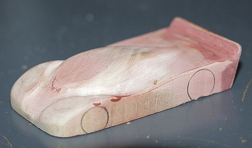

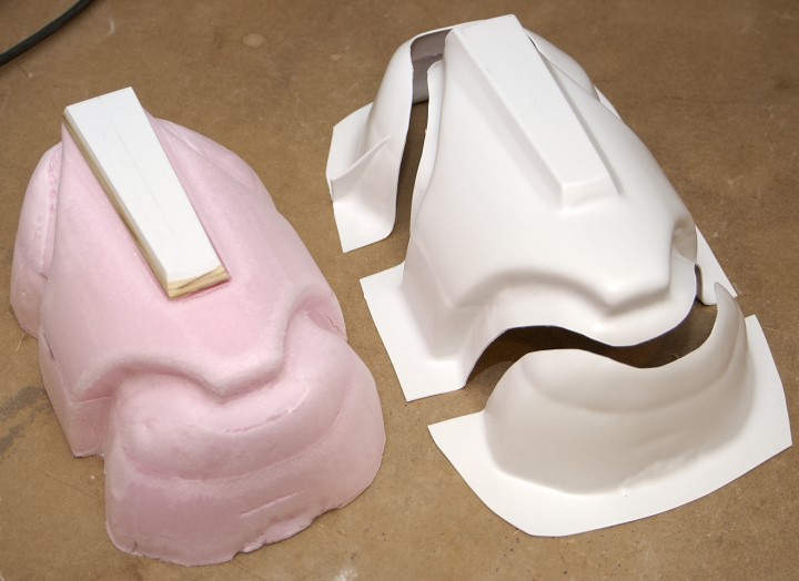

Post by Big Al » Sun Jul 03, 2011 4:25 am

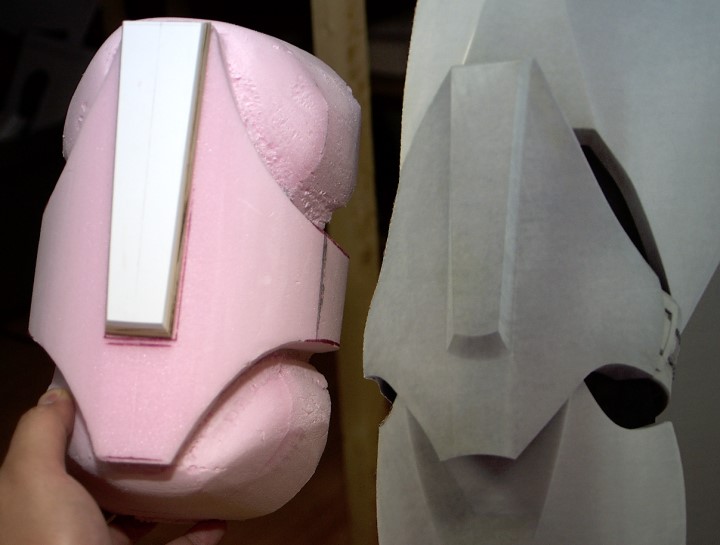

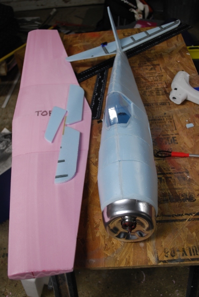

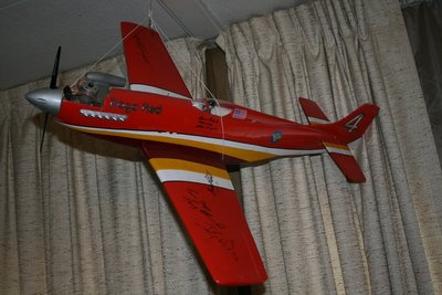

:cylongold: Plug and Mold Making
This one is a little involved and I will try to be as precise as I can be without being to long winded.
This is the part of the process where your you will need your craftsmanship and artistic abilities as well as ingenuity. Being a little clever helps too! I call it (The MacGyver Mode!) :ugh: well maybe not that extreme.
The only reason I say that is because you will use a variety of materials, tools, and machines to achieve your plug! The MacGyver part is the home brew implements you can make, in order to construct your home brew plug! :wink:
It seems every specialty tool or machine I would like to have,...is usually out of my price range so I seek alternatives like building my own! Ergo MacGyver! And the reason for this thread.
Plugs and molds can be made from a lot of things. Plaster, Wood, Fiberglass, Foam, Cast resin, Metal, and just about 10 million other materials you can think of!

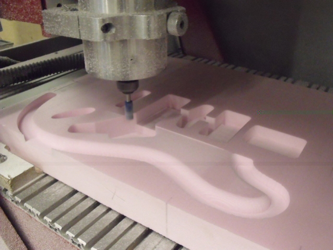

Post by Big Al » Tue Jul 05, 2011 1:40 am

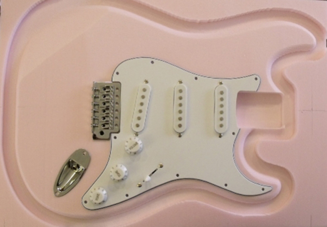

:cylon: Blue Foam (Extruded PolyStyrene)
Blue Foam is an insulation product and is called Bluecor Styrorfoam and is a trade name of Dow Chemical and is the exact chemical make up as Styrofoam (White Foam) also a Dow Chemical trade name.
[attachment=9]Dow%20Blue%20Foam.jpg[/attachment]
Blue and pink foam comes in different thicknesses and if the desired thickness is not available, you can stack and glue just like with balsa.
I didn't post any source links for the Blue or pink foam, although I'm sure you can find an internet source. The reason why is, you can get this from any local insulation company and some times you can find it at a local Home Depot or Lowes or any home center you might have in your town.

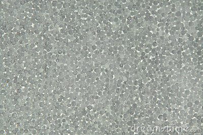

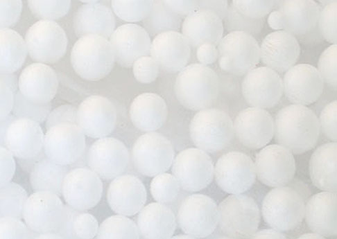

:cylon: Expanded Polystyrene (Styrofoam) beads
[attachment=8]Styrofoam Beads.jpg[/attachment]
The difference is that the common Styrofoam we all know that is used to make everything form coffee cups to packaging, is made from (Expanded Polystyrene) these are the little foam balls that fly everywhere like a dandelion when you break a molded piece apart!
Expanded Polystyrene, are little foam balls that are filled with air and are placed in between a 2 piece mold (male and female), Heated with steam or other heat sources sometimes heating the mold itself.
Then the air in the balls expand against each other and are formed and pressed with a great deal of pressure to create a part.
Expanded polystyrene,

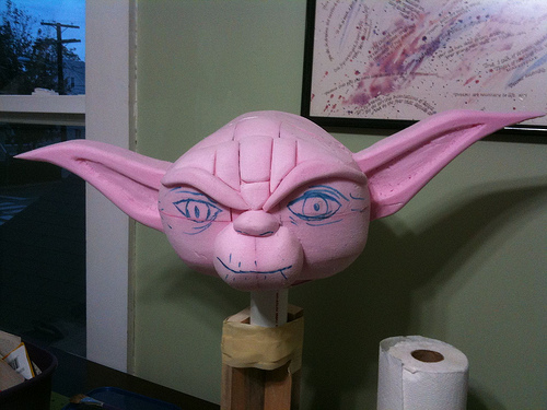

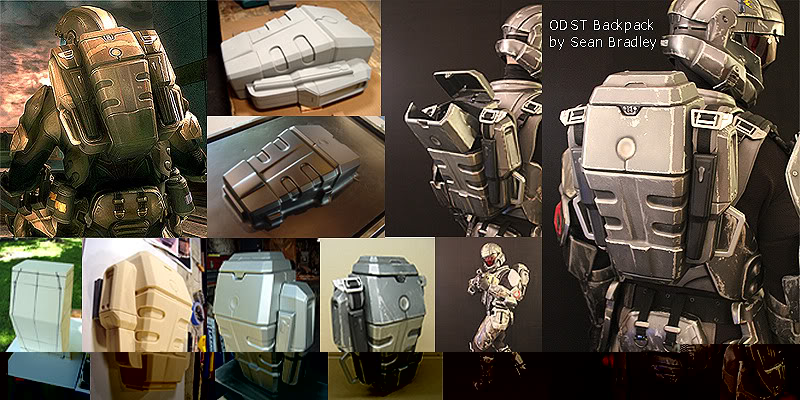

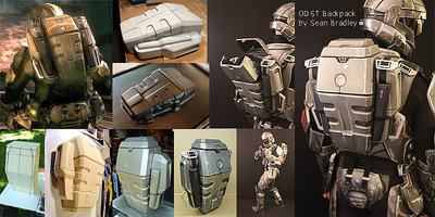

This next example is a stunning photo essay of Sean Bradley's ODST actual working Back pack build
and how to achieve a highly detailed plug from plaster or resin with a Male to Female to Male process.
He starts by making a detailed master plug from a polyurethane block , Then pulling a thicker plastic to make to make a female mold and pouring plaster or resin in the mold cavity of the plastic, creating a highly detailed, perfect plaster replica slave of the foam master.
This project could have as easily had been done in blue or pink foam with the same results.
The next step is to use the Plaster slave plug to pull your part and you have created a plug that will withstand a med to large production run.
This is a great artical and is right up our Cylon alley! One thing I found interesting is that He discusses different ways he could have done things for certain reasons to achive different results as well as his process and outcome.
:cylon: Here are some pics from his web site Blue Realm Studios, Sean Bradley's ODST
[attachment=0]ArticleCoverImage.jpg[/attachment]
Please visit this site and read his artical it's a treasure trove of info on the subject and takes you from the making the master plug to the finished product! :cylon:
