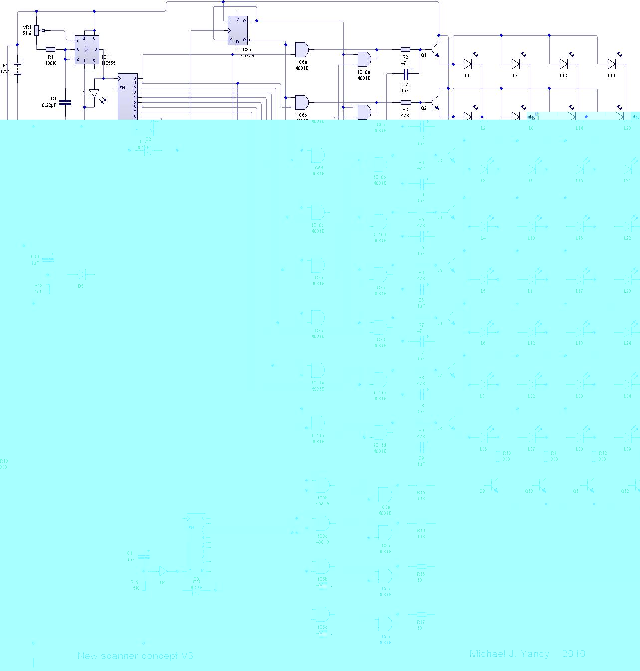

Hello everyone,
Heres something new to play with, eye scanner V2.0 with 32 LEDs

Re: Eye scanner contest $50 or less
Okay.
Do think I did find one major problem.
The sweep. It sweeps from L1 to L6 and then sweeps back from L1 it jumps to L7.
Now for L1 to L6 and L25 to L30 there's supposed to be a return sweep there, but for the middle 3 rows of leds, the sweep shouldn't happen. If you know what I mean?
I'll make a vid of the simulation. That is, when I have the cam battery charged.

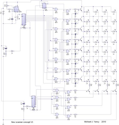

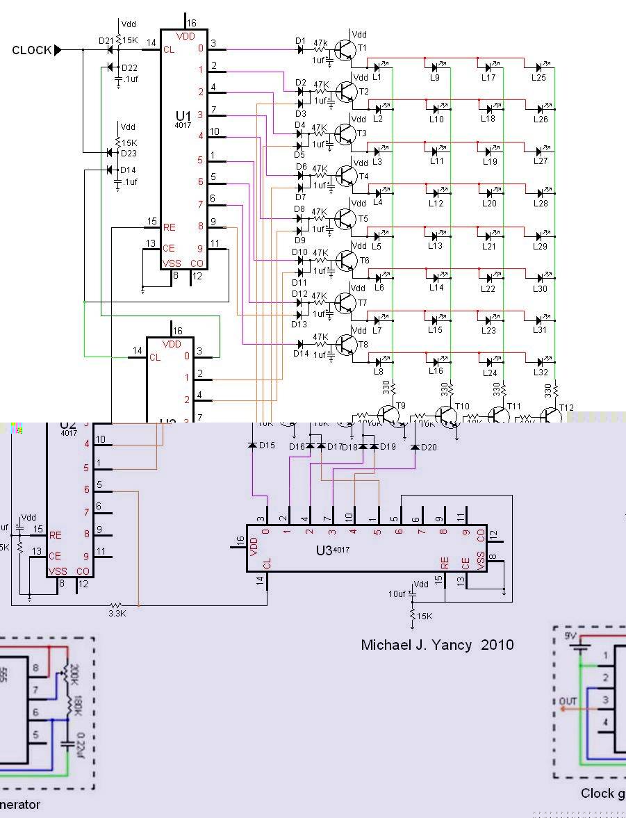

Hello everyone,
Heres V3, and it works but has many parts. and it does go back and forth.
Am I reading it right? It has 39 LEDs?
UPDATE: I counted and there are 32... the numbering just got me... seems around 25ish the number system skips a few? I dunno, it is LATE here and I'm nearly cross eye'd tired...
COOL COOL COOL STUFF MAN. Keep at it! THANK YOU
When you work in CW, sometimes the numbering gets screwed up a bit. In a final design, the logical numbering of leds will be corrected I'm sure.
Founds some minor things (trailing on the leds), trying to iron them out. Zeta did an awesome job though. Working with the gates etc. is a higher kind of math.

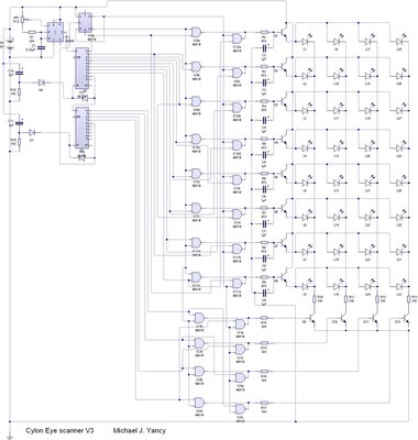

Hello everyone,
I will do some final tweaking of the scanner tonight. The parts I ordered will be in Monday the 6th, So I should have a prototype done by the 10th.
Here is the final version of scanner circuit...
