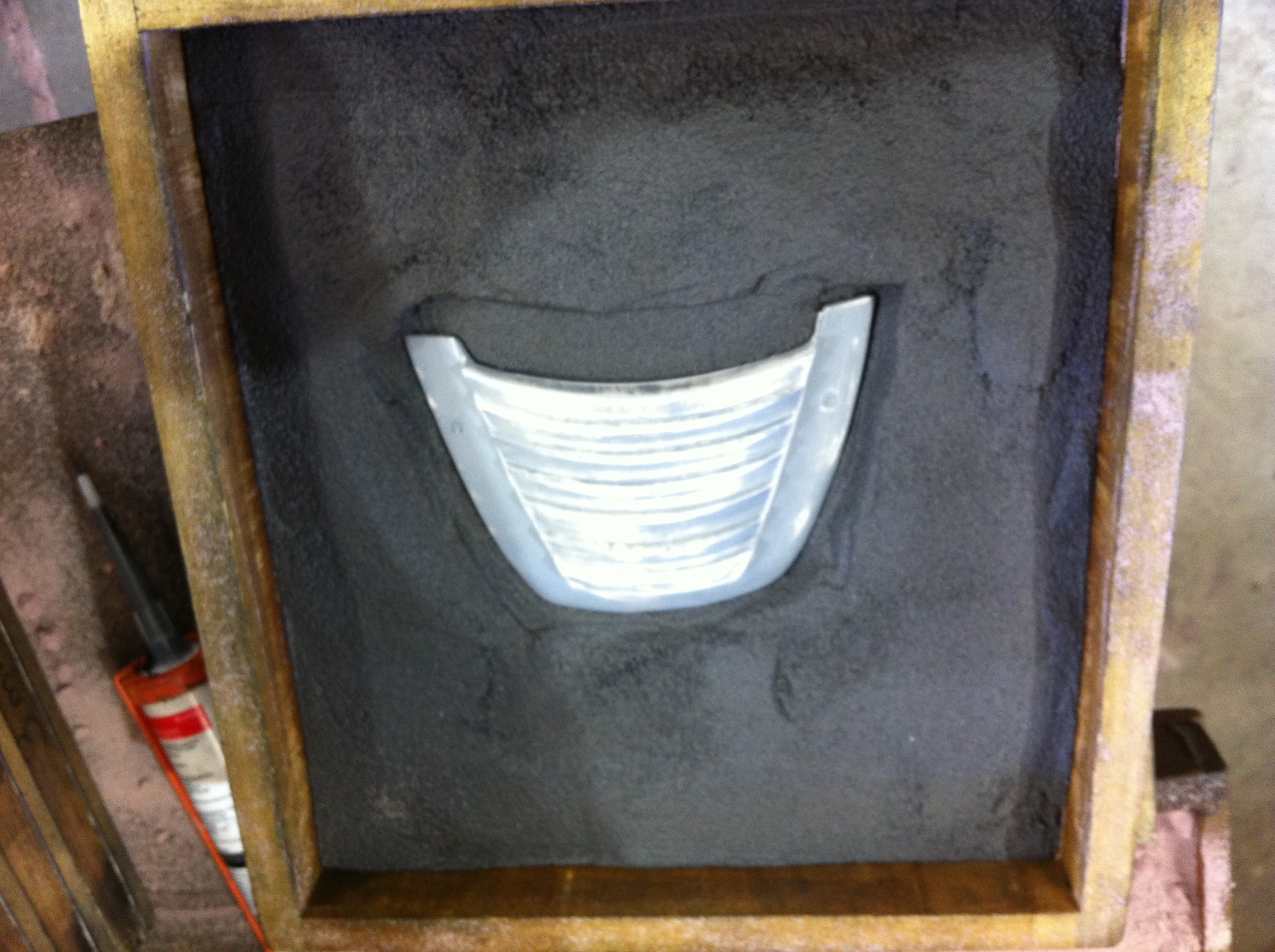

This is the one I have. will post some pics in a couple of day once I pour it.
Pic is not very clear but the grille does have nice sharp detail. It will just depend how well I can remove it from the sand mould when I do it. Cheers Terry

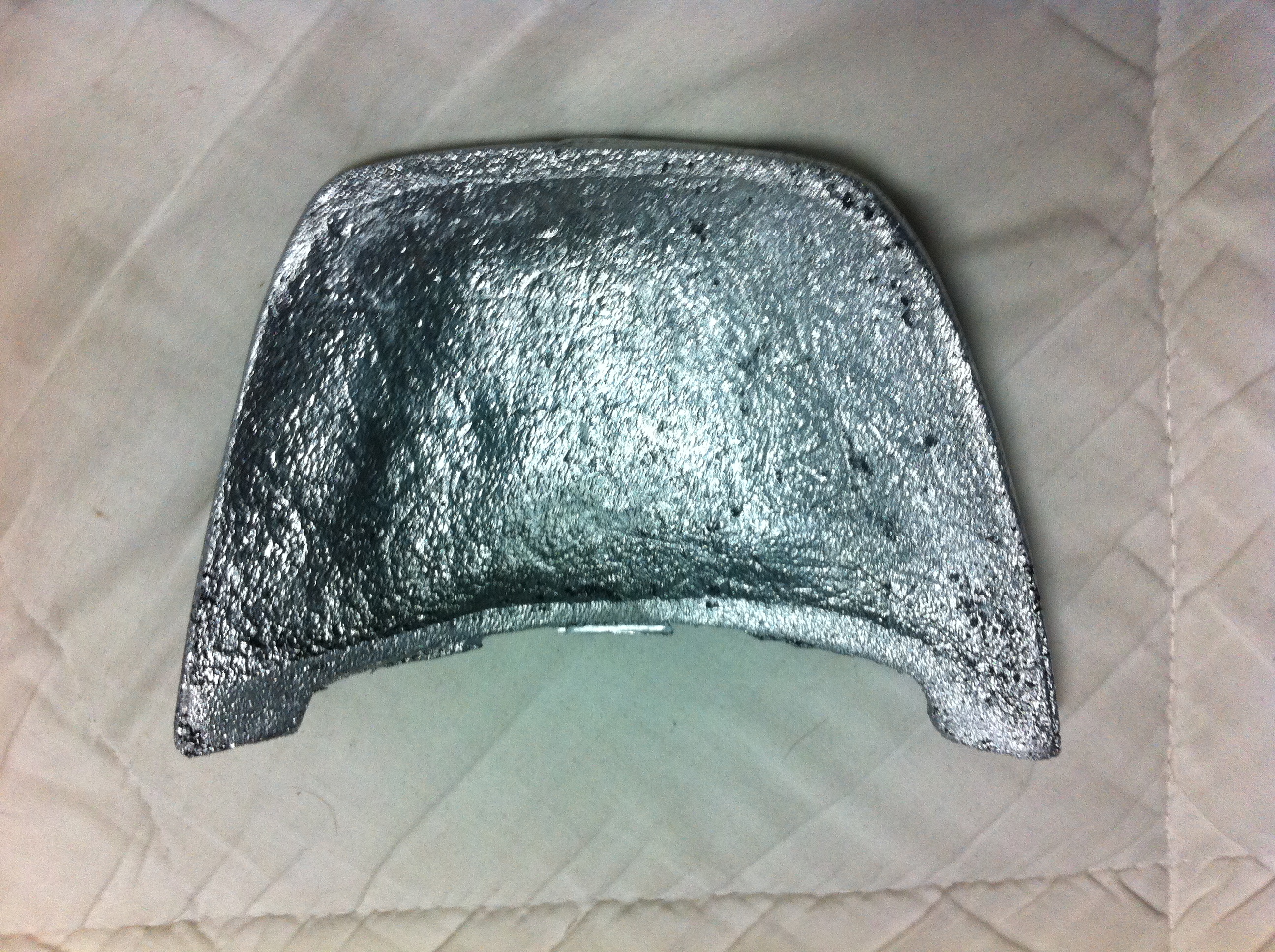

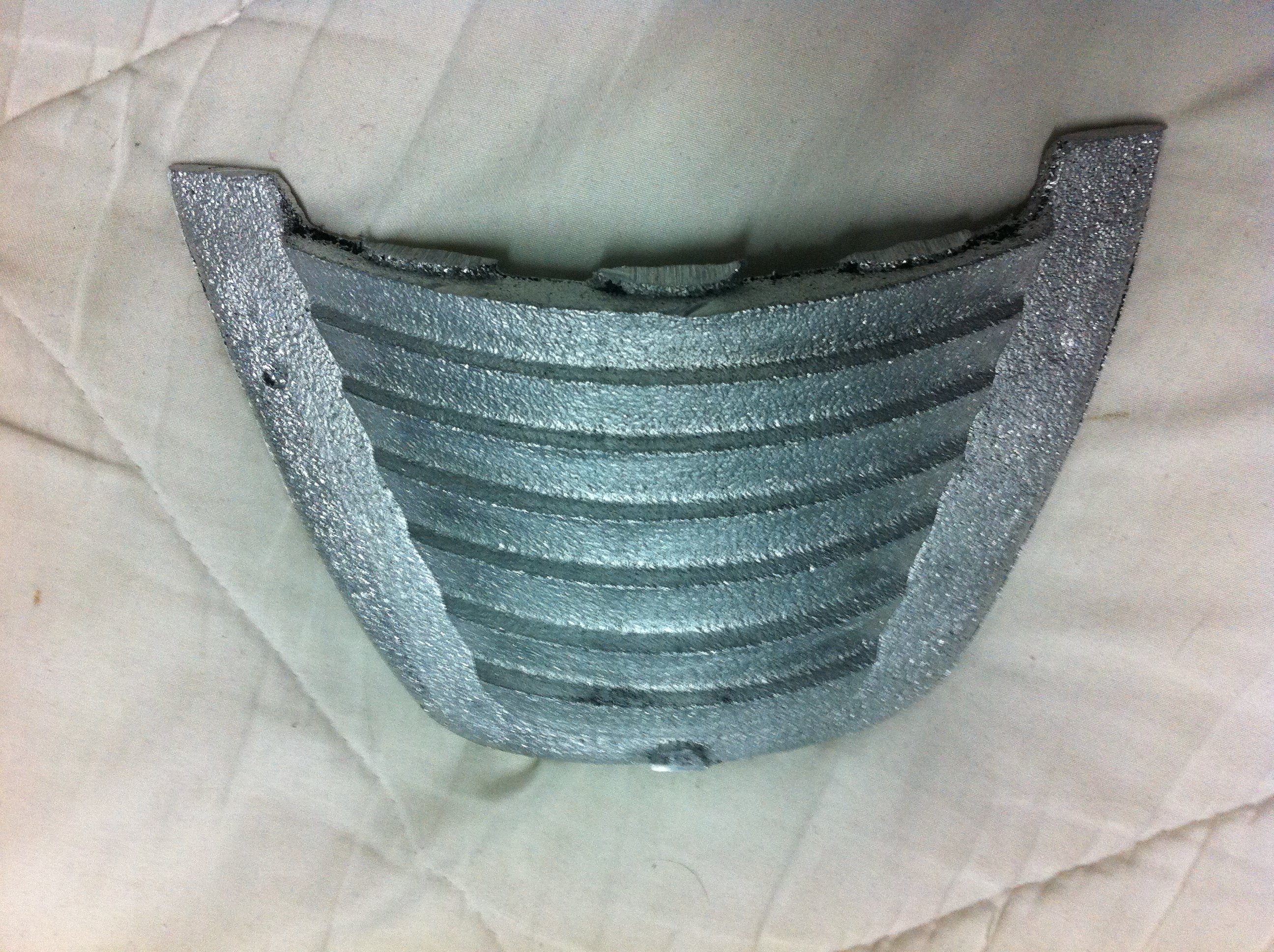

The first attempt at casting the mouthpiece. I wont have anytime to do more for a week or two. It will depend on when I do another run of aluminium. I have a few more pics that I will upload over the weekend. I have to sit down and work out how much these will cost me to make. They will only be a here and there thing but if anyone does eventually want one I will be able to do enough for everyone. I will also weigh it tomorrow. Out of interest, how do these things attach to the helmet? I havn't got that far with mine yet. Cheers Terry

Does your own copy of the mouth piece have a different kind of back to it or does it resemble this one? I only ask because it would be ideal if the impression of the backside were also there. Also, how easy is it to sand/buff the texture smooth? Is it possible to use a finer grade of sand to make the mold?

The back is just like mine. The aluminium is easy to sand and polish. Cannot use a finer sand. The texture is from the graphite paint used to seal the mould. I can make it a touch smoother but its time consuming. Cheers Terry.
