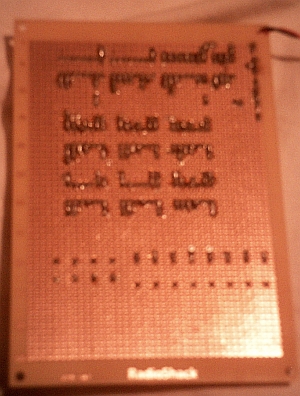

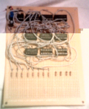

Cylon-Knight, All the mistakes I have found so far are mine, bad soldering and old equipment, and tight tolerance (and a 4yr old). The only problem with the actual final circuit diagram posted on Dec 3 has only 1 problem, the trailing capacitor size need to be experimented with to find the right size. I did a minor experiment, on the caps and found they are dependent on the speed, a large cap won't charge fast enough and a small cap discharges to fast. When I get more time, I will make a PC board, this will eliminate the mistakes I made. These are old pics, but it shows the mess.

Eye scanner contest $50 or less
Looks like an old fashion bread board. The goods days of me using those back in the 70's but they still work.
