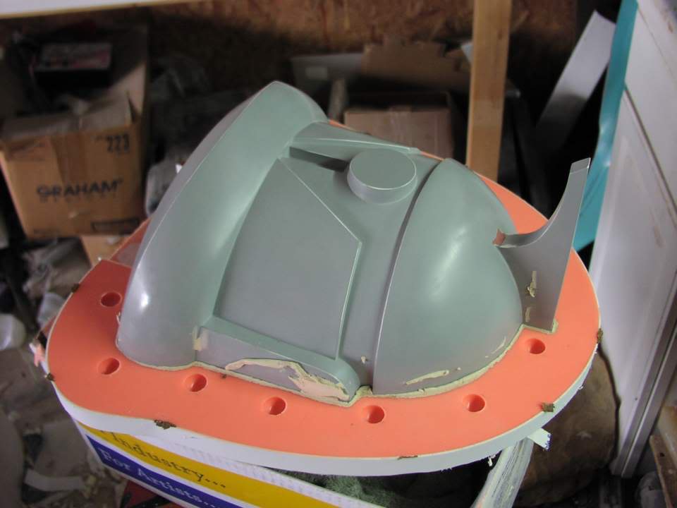

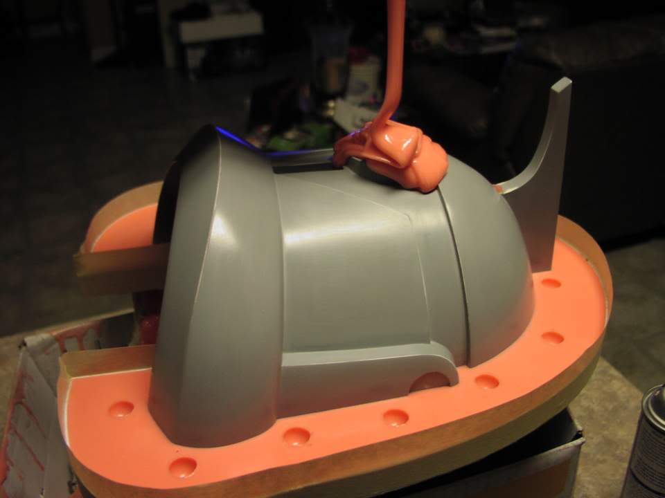

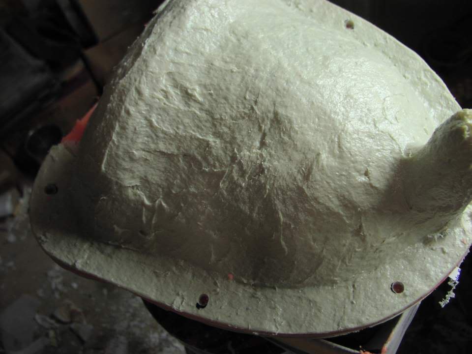

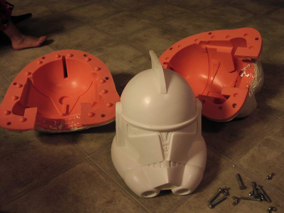

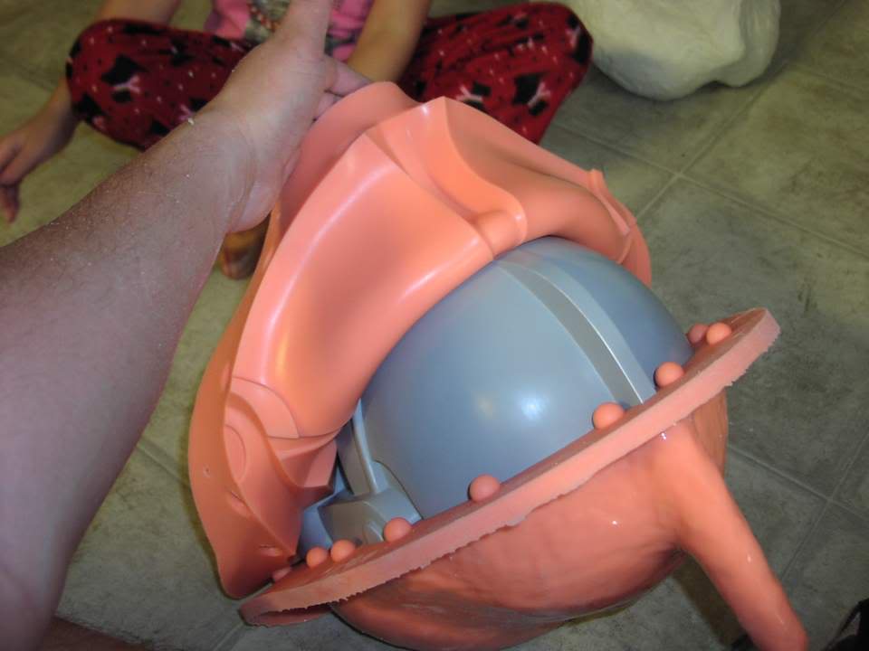

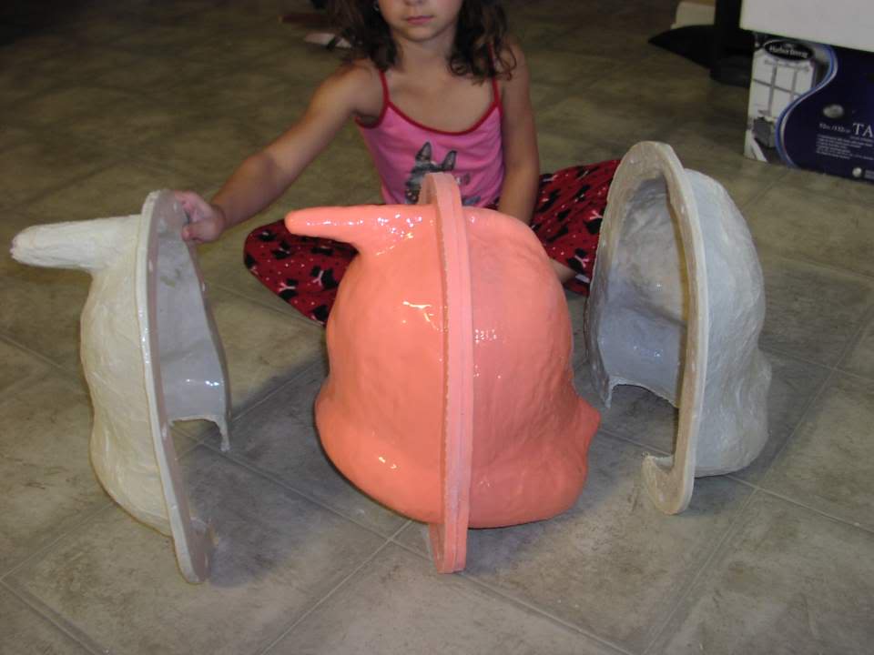

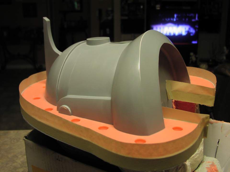

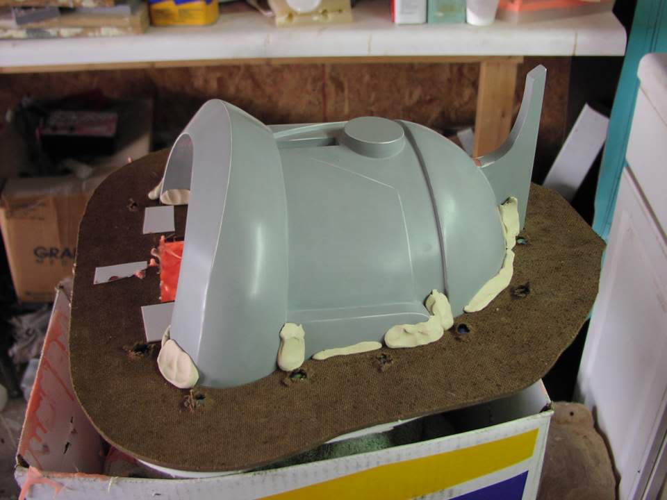

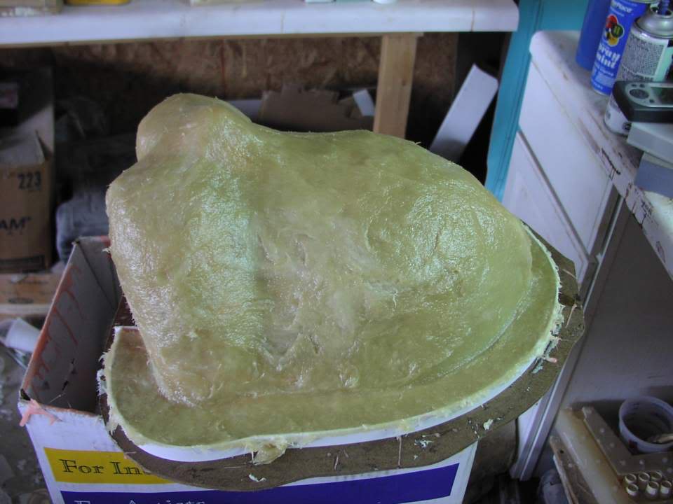

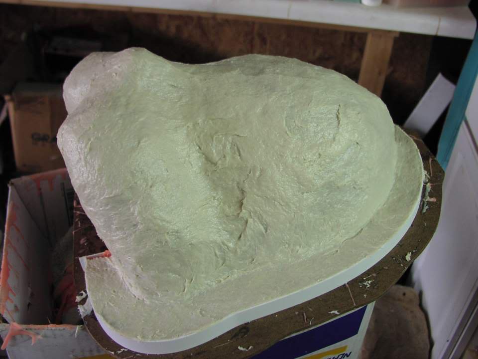

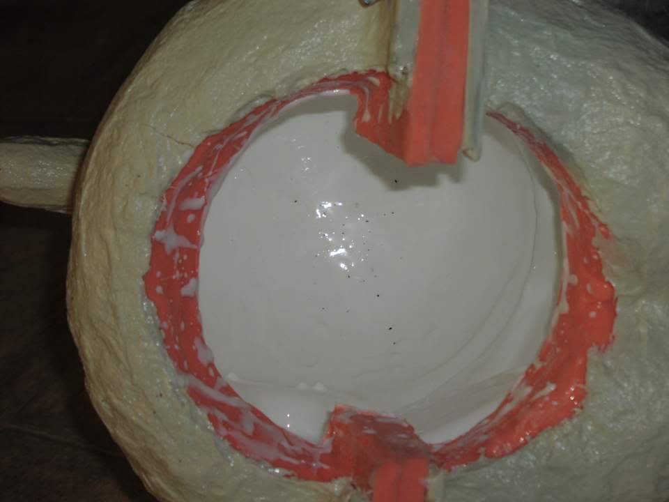

Post by Big Al » Fri Aug 05, 2011 4:00 am

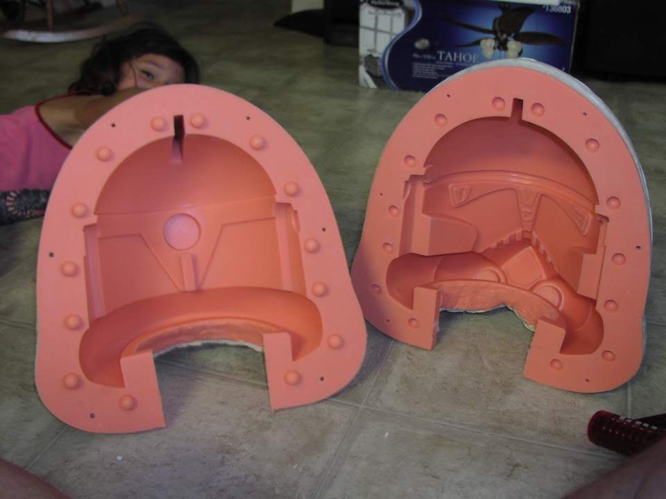

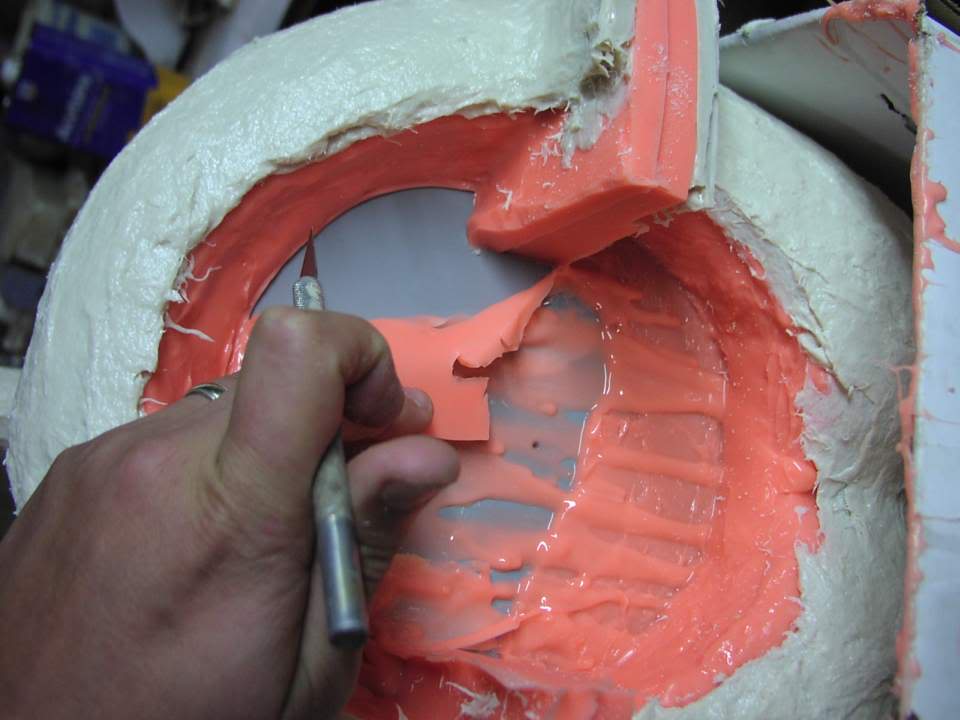

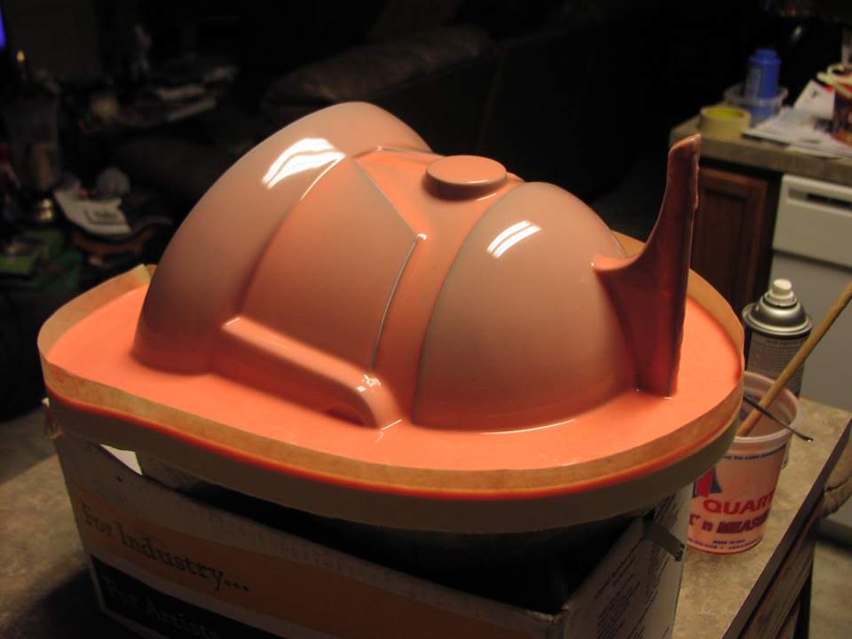

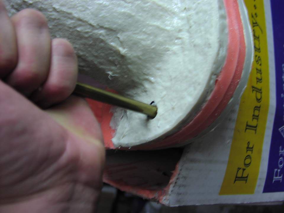

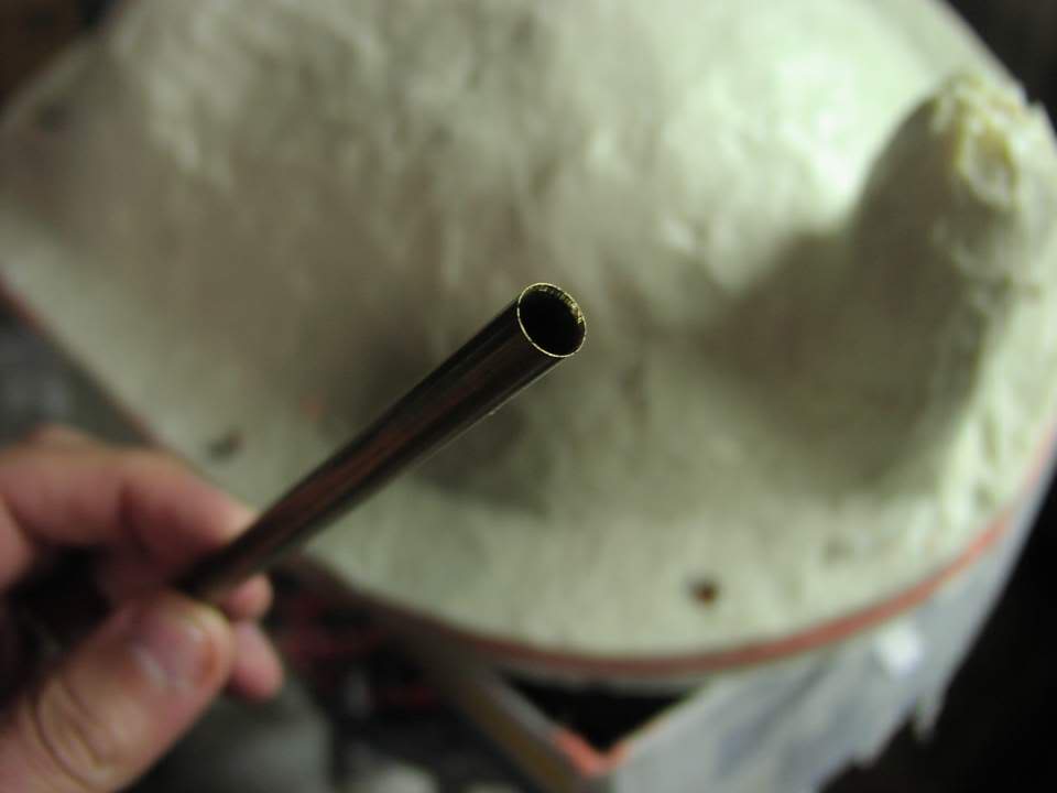

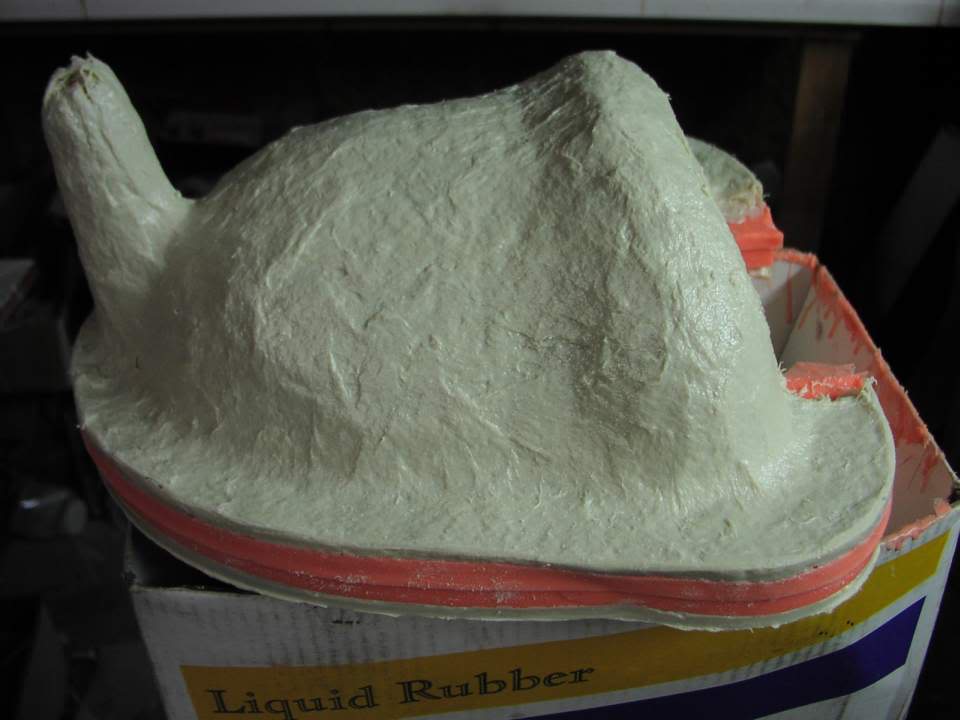

:cylongold: Clone Trooper Matrix Mold Build Pics 6
Re: DIY Rotocasting

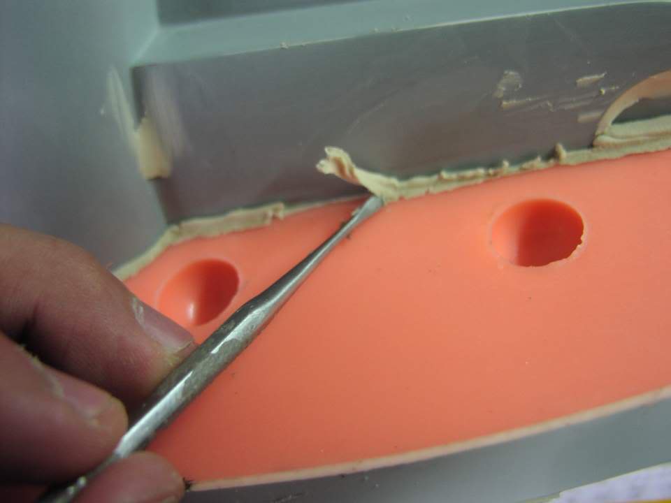

Post by Big Al » Fri Aug 05, 2011 4:07 am
:cylongold: Clone Trooper Matrix Mold Build Pics 7
Re: DIY Rotocasting

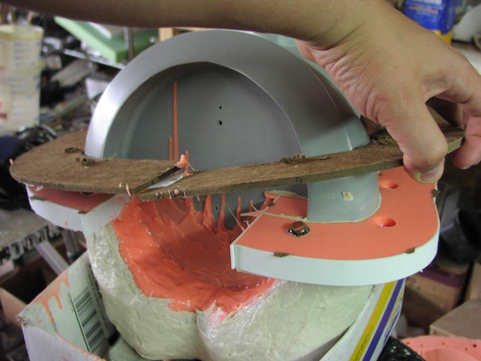

Post by Big Al » Fri Aug 05, 2011 4:09 am
:cylongold: Clone Trooper Matrix Mold Build Pics 8

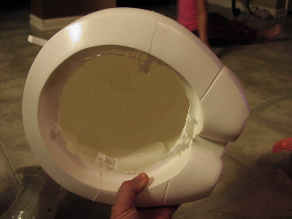

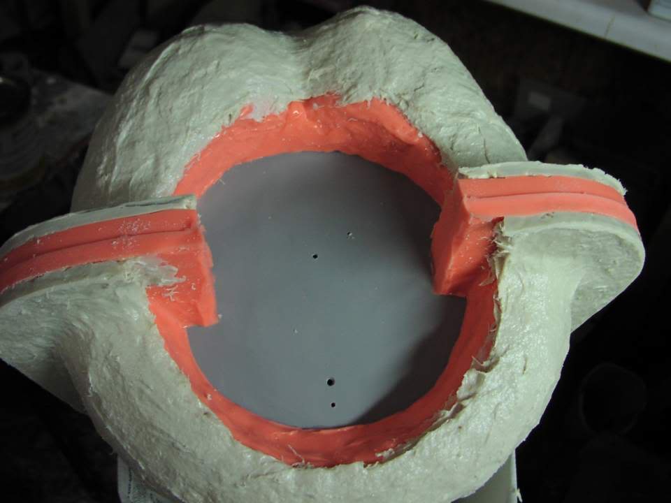

Re: DIY Rotocasting
Post by Big Al » Fri Aug 05, 2011 4:21 am
:cylongold: Clone Trooper Matrix Mold Build Pics 9
:cylon: These are all the pics I could find on this build and if you want to see the original thread on this build you can find it here at Clone Troopers.Net Very cool tutorial. :cool:

For your head? No less than one gallon. Be sure to save all if your matrix clay. Stuff it in a bucket and you'll need about that plus some for your mold. No less than 3/8 of an inch for your wall thickness. Make a clay cutter. use wetclay. Bondoresin for the first coat of the jacket. Finish with laminating resin and glass cloth. drill bleeders. Vaseline the inside. I recommend 1065 from silpack. The green catalyst has less shrinkage. Long lasting. Tin base. 12 hour cure.
- Die human!
DIY Rotocasting
Post by Skullbeast » Sat Aug 06, 2011 10:15 pm
Make sure your head is mounted to a base for registration so the closing up of the mold at a later time will be accurate for pouring the silicone. You don't want the mold to touch the head.
