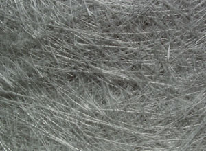

:cylon: Fiberglass is just that! it is glass that has been spun into fiber threads then then woven into cloth form. The weaves vary as well as the size and thickness depending on what you are doing with the cloth.
:cylon: This is a Chopped Fiberglass mat cloth
[attachment=3]fiberglass chopped mat.jpg[/attachment]

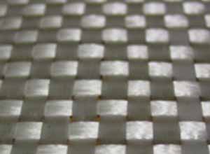

:cylon: This is a basic weave Fiberglass
[attachment=2]fiberglass woven roving.jpg[/attachment]

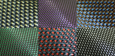

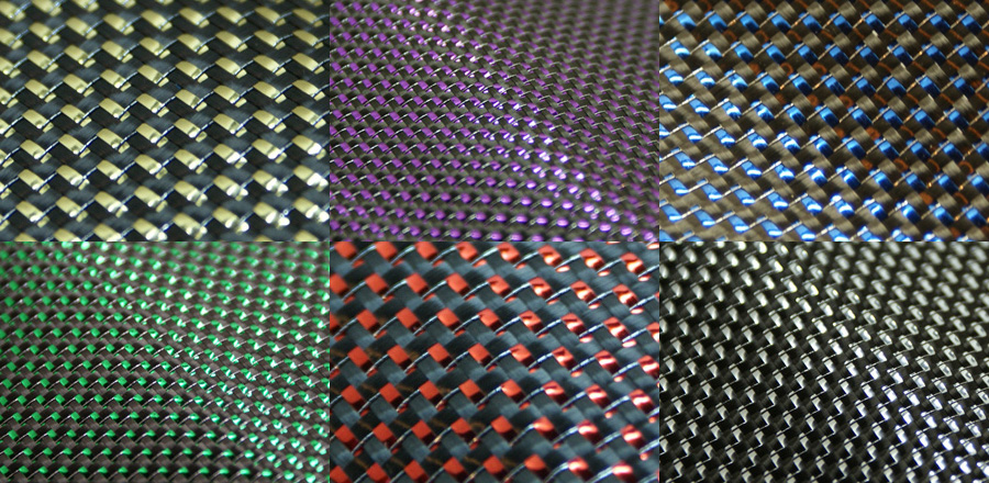

:cylon: There are tons of different cloth combinations and weaves from plain fiberglass with straight weaves to special composite cloth comprised of Glass, Carbon, Aramid, and so on.
[attachment=1]reflective carbon fiber fabrics.jpg[/attachment]
This kind of cloth is used to create strength while keeping the light weight advantage that cloth and resin will allow, Carbon Fiber can be as strong as steel while Aramid (Kevlar) is used to stop bullets! :wtf:
Basic cloth is the most common that is used to make props and armor and that's what we will start with.

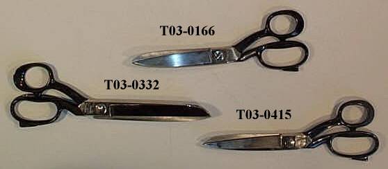

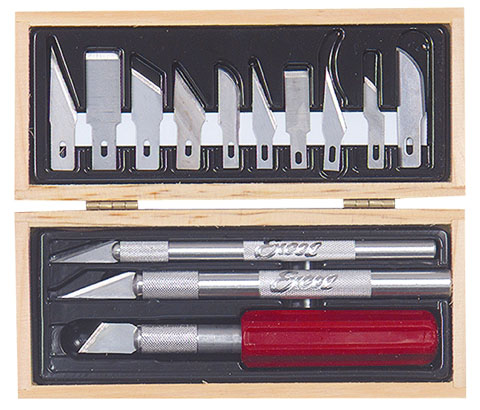

:cylongold: Tools
:cylon: You will need a variety of tools for making fiberglass molds and laying up parts.
:cylon: Laminating Tools & Supplies
Let's start with the shears and knifes
:arrow: Hand Shears
:arrow: Kevlar

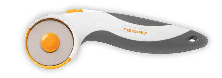

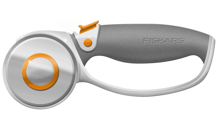

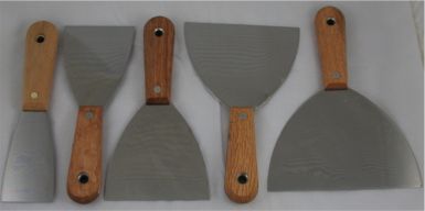

:arrow: Putty Knifes
[attachment=6]All_stuco.jpg[/attachment]

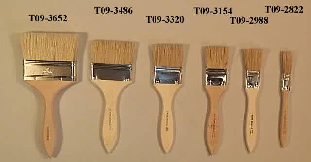

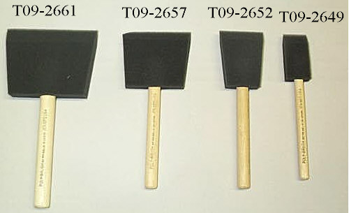

:arrow: Foam Brushes
[attachment=5]Foam_Brushes.jpg[/attachment]

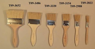

:arrow: Paint Brushes
Brushes, pure natural bristle brushes with non-painted wood handle, great for working with polyester and epoxy resins. 4" brush is industry standard for Hot Coating polyester surfboards and Sailboards.
[attachment=4]Brushes.jpg[/attachment]

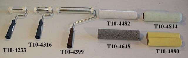

:arrow: Paint Rollers
[attachment=3]Rollers_and_covers.jpg[/attachment]

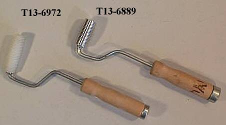

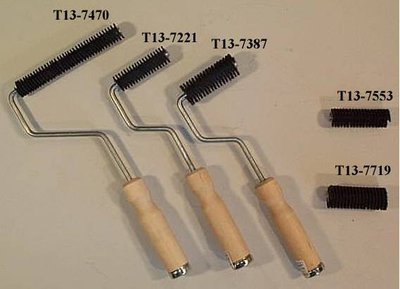

:arrow: Aluminium Radius Rollers
Aluminum Radius Rollers, designed for concave surfaces where flat roller bridge and are not effective. Wood handle that accepts extension and strong steel frame. Machined with deepest fins possible for efficient air relief and excellent lay up properties.

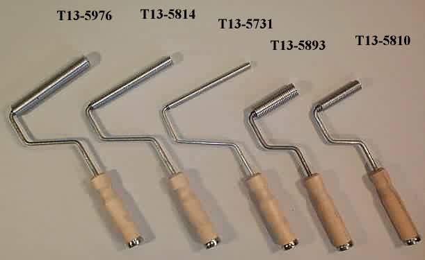

[attachment=1]Alum_roller_Radius.jpg[/attachment]
:arrow: Aluminium Econo Rollers
[attachment=0]Alum_roller-Econo.jpg[/attachment]

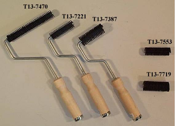

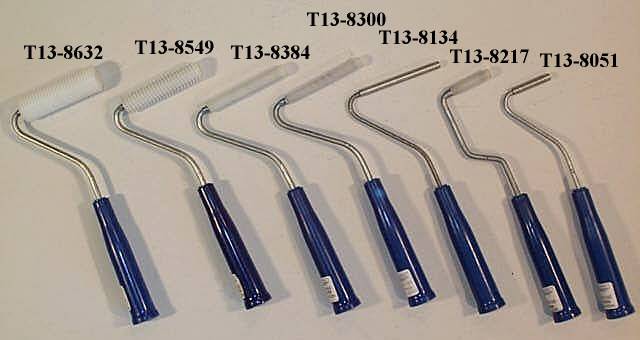

:arrow: Bristle Rollers
Quick Release Bristle Rollers, used when conventional finned rollers are not efficient at removing air in a particular laminate. Work well in knitted/unidirectional fabrics where air pockets can form. Quick release allows for fast clean up, strong

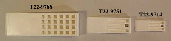

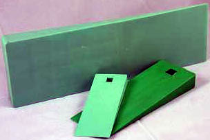

:arrow: Demolding Wedges
Demolding Wedges, use for removing parts from molds, prevents scratching and damaging mold surfaces.
[attachment=5]Demolding_Wedges.jpg[/attachment]
High Performance Demolding Wedges, longer lasting and tougher. Use for removing parts from molds, prevents scratching and damaging mold surfaces.
[attachment=4]IMG_4639_edited.jpg[/attachment]

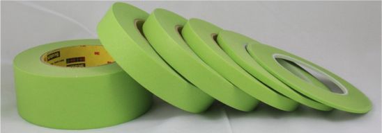

:arrow: Masking Tape
Tape is very important!
New Scotch 3M 233+ Masking Tape, an improved version of 233 that offers exceptional conformability, and a sharper edge for striping
[attachment=3]Picture10.jpg[/attachment]
Scotch # 2090 Long-Mask Masking Tape, Utilizes a synthetic adhesive system which provides ultraviolet stability and adhesive transfer resistance up to seven days after application. For paint and varnish masking applications.
[attachment=2]Blue_Tape.jpg[/attachment]
