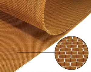

:cylongold: Vacuum Bagging Videos and Sandwich Core
:cylon: There's really no magic secret about sandwich core. The difference between sandwich core and basic lamination is the center material between the lamination. Sandwich core can be made from hundreds of different materials and combonations of materials.
A real easy example is one we use a simple sheet of 1/16th to 1/8th Balsa wood sheet between 4 layers of glass so the sanwich goes like this from top to bottom....... .75 Oz Glass cloth, 2 Oz Glass Cloth, Balsa Sheet, 2 Oz Glass Cloth, .75 Oz Glass Cloth. Then Bagged.
Another sandwich technique we use in the airplane world is the use of Nomex honeycomb between the glass. This makes very strong but lightweight parts
[attachment=0]Nomex Honeycomb.jpg[/attachment]

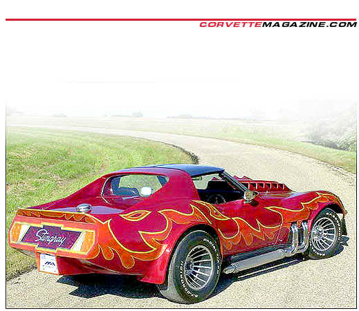

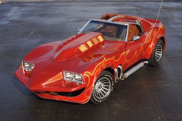

:cylon: I wanted to include this little tribute because for One, it is a great example of fiberglass artistry, and two...when I was a kid in 1978 my dad had a friend who was working for MGM and he got a call for us to come see them film the scenes where Mark Hammil is chasing his car down the road.
The story was set in Las Vegas but this scene was shot 3 blocks from our house in the San Fernando Valley.
In Breif, The story line is about the car (red) being stolen and the theives re-paint it gold but the reality was there were two cars.
The Gold car and the red car were both there that day and I got to sit in the gold car.
Here are a couple of pics of the greatest corvette that was ever made. The video is a high Q trailer.
The car still exists today and I think it's for sale

:cylon: Restored Corvette Summer Car
[attachment=3]Corvette 1.jpg[/attachment]
:cylon: Corvette Magazine.Com
[attachment=1]CorvetteSummer.jpg[/attachment]

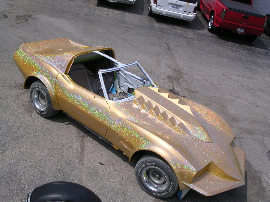

:cylon: This is the gold car and it looks just like it did when I sat in it, no interior, no windshield for filming.
[attachment=0]corvette_work_012.jpg[/attachment]
If you want to see the restoration, it was done by Performance Restorations here is the link with alot of pics
1973 Corvette Summer Car Restoration Project
