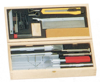

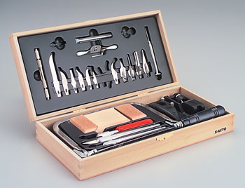

This next set is made by X-Acto and is a very nice set and you will use every tool in this box!.
The set includes, a draw knife, a variety of Knife blades and knife handles, small sanding block, Edge cutter, Razor plane and a coping saw!
[attachment=3]xacto set.jpg[/attachment]
You can get this set through Tower Hobbies

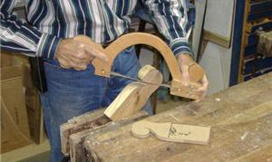

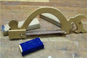

:cylongold: Razor Saws

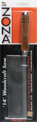

Razor saws are just as important as knives and other shaping tools. They come with course or fine teeth , wide and skinny and some are even made with a thin steel to make a minimum Cerf. (The amount of material that is removed by the saw blade)
Zona, Excel and X-Acto make Razor saws. X-Acto and Excel make a chuck handle with separate blades. Zona has a similar version of this except theirs is a clamp handel. Zona makes a 3 in 1 and a 4 in 1, and as handy as they are, (I have all 3) they are like a universal screw driver with changeable bits. Every time you need a different tool, you have to stop and change the blade.
Zona makes a variety of stand alone saws and I recommend these because when your in the groove, You can just set one tool down and grab another and continue your work.
:cylon: Here are some examples.
[attachment=2]Zona 14.jpg[/attachment]
[attachment=1]Zona 52.jpg[/attachment]
[attachment=0]Zona Saber.jpg[/attachment]
These can also be purchased from Tower Hobbies and here is the link
Tower Hobbies Zona Saws
All of these tools will help you make your plugs! you will also need a good colection of sanding implements and that's next!

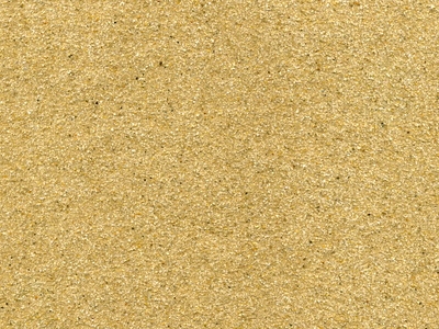

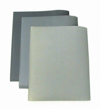

:cylongold: SandPaper
Sandpaper is a subject that can be discussed in great detail but isn't really necessary.
There is no perfect selection of grit when sanding. You just have to use common sense. :smile:
Grits vary, so start with a course to semi-course grit for rough shaping, then graduate to a medium grit for final shaping, and then a fine to super fine for a finished or polished surface.
If you are making your plug from a hard wood, the course grits are needed because you want to remove a lot of material in the beginning to form the shape of your plug.
The Grit numbers are representative of grains of sand per square inch on the paper.

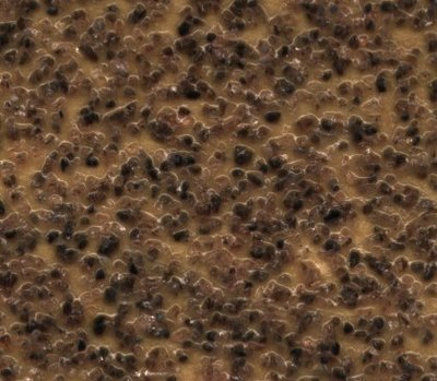

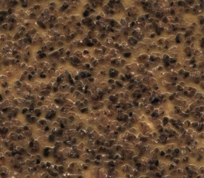

30 and 60 grit sand paper is basically boulders glued to paper and will tear up your material with one pass.
(Not recommended for this type of work.)
[attachment=3]60_Grit_Sandpaper_by_Dragonhead.jpg[/attachment]
A good starting point for Balsa or Foam would be 100, 120 to 160 for a starting grit.
[attachment=1]100 grit sand paper.jpg[/attachment]
A medium would be 200 to 600 grit
[attachment=2]200 grit sandpaper.jpg[/attachment]
Fine to super fine would be 1000 to 2000 grit for finish and polishing, 2000 grit is mostly used to polished headlight lenses on cars. and believe it or not, a paper grocery bag makes a great Super Duper fine sandpaper for polishing. (Is Super Duper a word?) :wtf:
[attachment=0]2000 sandpapers.jpg[/attachment]
Just remeber that a polished finished on your plug is not desirable and if your finished plug is polished, it will trap air and cause bubbles in your part.
You can read all of this info on sandpaper and still not know which paper to use. the best way is to just try it!
Next up: Sanders (Manual Hand Held)

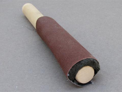

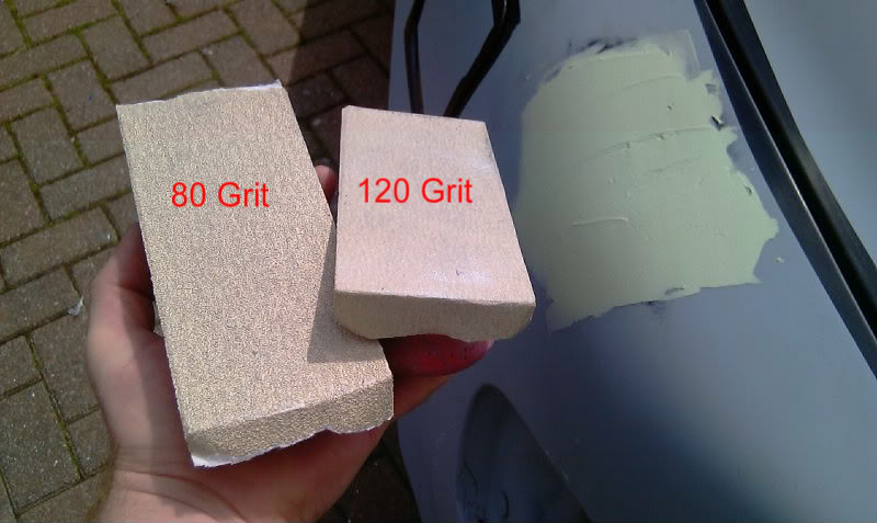

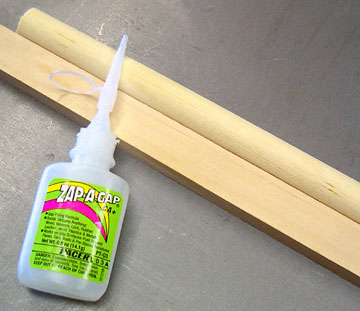

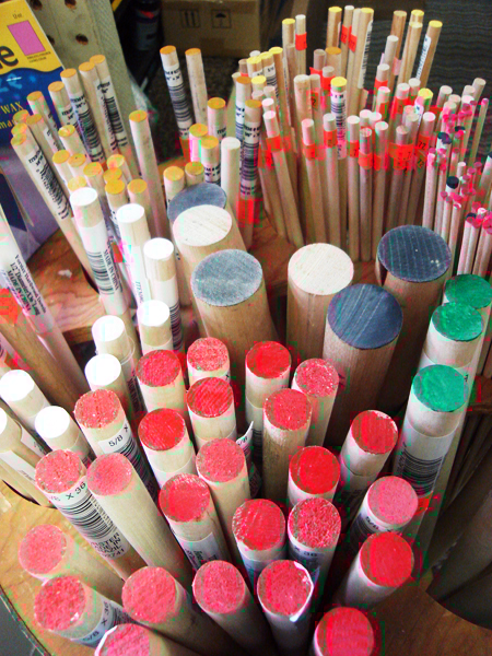

Sometimes I make my own custom sanders. Nothing fancy, A simple block of hardwood or a Dowel rod wrapped with sand paper of your desired grit. A couple of drops of Cyanoacrylate (Crazy Glue) and your in business!
[attachment=7]Dowel and glue.jpg[/attachment]
:cylon: DIY Block Sander
Depending on the dimensions of your block, you actually can have two sanders in one,
For example:, a 3

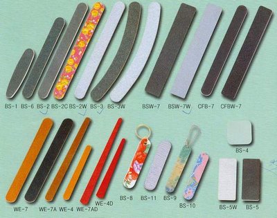

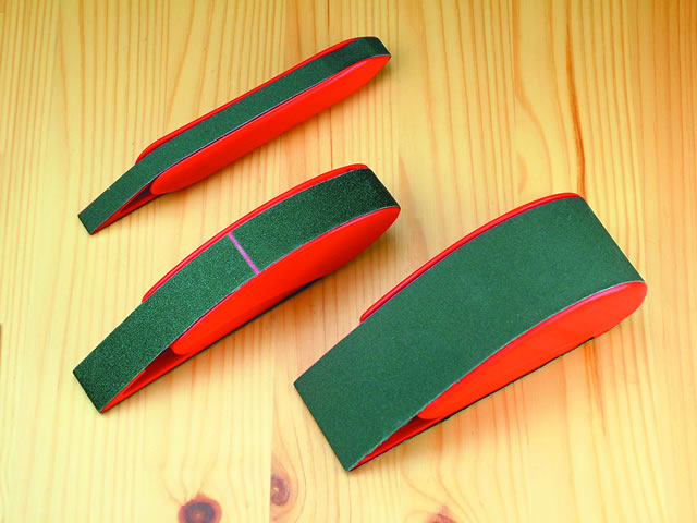

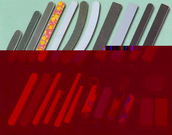

Post by Big Al » Wed Jul 06, 2011 9:23 pm
:cylon: Commercially Made Manual Hand Sanders
There are as many Block sander types on the market as there are screwdriver types.
Commercially made manual hand sanders vary from a simple block or a flat drywall sander to extruded aluminum bar sanders, to special small block and wedge sanders to small pencil sanders. All of which I recommend for your sanding arsenal.
Complex shapes or even, flat sanding and smooth finishes are only achieved if you have an arsenal of sanding tools to smooth and shape the hard to get to or seemingly impossible nooks and crannies of your part or achive even flat surfaces.
Sears is a great to get manufacured sanding blocks and they have a ton of them
Heres the link to their main page of Sanding Blocks
This is one of my favorites made by 3M it's a rubber block sander
[attachment=3]3M Rubber Sanding Block.jpg[/attachment]

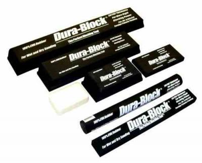

Here is a set of Ethylene-vinyl acetate (EVA) Foam sanders also from sears
[attachment=2]EVA Foam-Dura-Block-AF44L-7pc-Kit.jpg[/attachment]

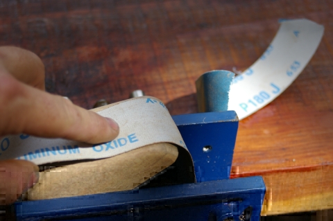

Some times you need a straight bar sander to cover a long area that you need to sand evenly all at once and a simple block sander will not suffice.
Great Planes makes extruded aluminium sanding bars and are available at Tower Hobbies.
They come in several lengths 5.5, 11, 22, and 33 inches. They are aprox 2" wide and the rolled adhesive backed paper comes in many grits. Also available at Tower Hobbies
[attachment=9]Sand Bar paper 220.jpg[/attachment]
[attachment=8]Sanding Bar 11.jpg[/attachment]

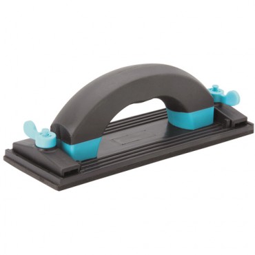

A drywall sander works similar to a block sander and has a handle for a more even flat pressure control.
[attachment=7]sander4.jpg[/attachment]

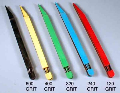

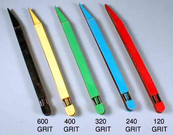

Pencil or stick sanders are very handy and also available at Tower Hobbies
[attachment=6]sanding_sticks_o.jpg[/attachment]
[attachment=5]Finger sander.gif[/attachment]

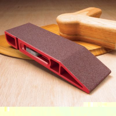

Here is a small block/wedge sander available from Sears
[attachment=4]Sears sander.jpg[/attachment]
Here is a very cool Teardrop shape set available at sears
[attachment=1]Sears sander block set.jpg[/attachment]
This is a Foam rubber (Scrubber) Sanding block ...Sears
[attachment=0]Foam Sander.jpg[/attachment]
These are just a few examples of manual sanders and sanding utensils that will help you when you are sanding your plug.
There is no one sander that will do it all!
Sears is a great place to start because they have a great selection of these type of sanders! other places for sanding blocks would be Lowes and Home Depot.
Next Up: Power Sanders

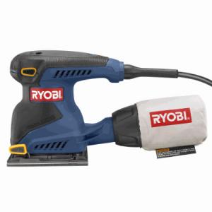

I stuck with pics of the Ryobi products because I'm not a pro carpenter and the ryobi products are the least expensive and are sutable for model work not to mention they work great!.
If you have deep pockets you can get these same tools in another brand such as DeWalt, Makita, Bosh. But as much as these brands are premium tools, It's really not necessary.
:cylon: Basic Palm Sander
Ok everybody has seen these so not alot to explain.
You put the paper on it, turn it on and and start sanding!
High Vibration does the work.
[attachment=5]Ryobi palm_sander.jpg[/attachment]
Draw back, the vibration is circular and can leave undesirable discernible swirling grooves in your work.
This sander is best used for initial rough shaping.

[attachment=4]Ryobi Orbital Sander.jpg[/attachment]
Draw back, Nothing is perfect. Hard to get close to edges and corners.
This sander is best for medium finish work.

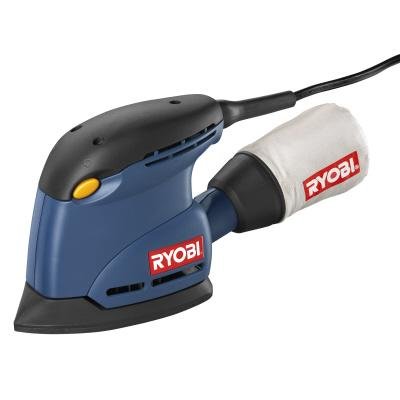

:cylon: Corner Sander
Great tool! vibration sander with a clothes iron shaped pad allows you to get into corners and some tight places you can't get to with an orbital sander.
[attachment=3]Ryobi Finishing palm sander.jpg[/attachment]
Draw back, can cause the same grooves as the basic palm sander.
This is a Great finish sander!

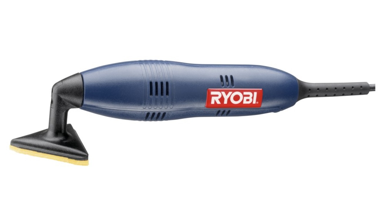

:cylon: Finish Sander
Much smaller triangle pad head with a 90 degree angle and a slender motor body.
Makes it very easy to finish sand and can reach places the other palms can't.
[attachment=2]Ryobi Finsh sander.jpg[/attachment]
Draw Back Versatility is limited to the triangle head (No other attachments)
Awsome finish sander!

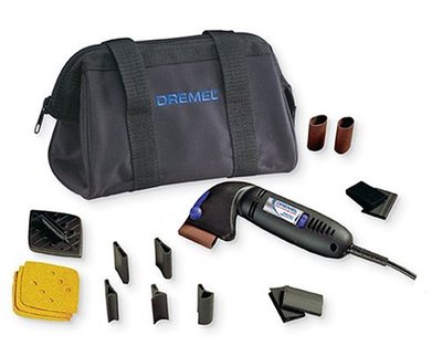

:cylon: Dremel Shaping sander
I got this one some years ago and I don't know if they still make it or replaced it with a new model but if you can find one grab it!
I use this for just about every shape you can think of and it works great!
[attachment=1]Dremel shape sander.jpg[/attachment]
This is a close up of the different shaped rubber sanding forms.
it also has an attachment pad for finish work!
[attachment=0]Dremel shape Sandingforms.jpg[/attachment]
Draw backs, Can't think of any.

:cylon: 1 Inch Bench Top Belt Sander
Great tool, used mostly on smaller parts.

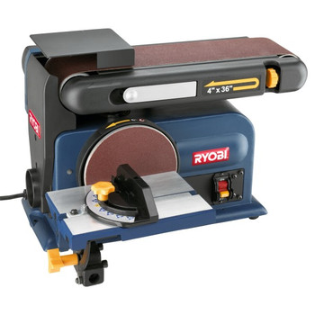

:cylon: 4x36 Belt/6 Inch Disc combo sander
Many uses for this one and is a must for any model shop.
The belt can be set to vertical or horizontal.

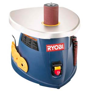

:cylon: Ocilating Spindle Sander
This is one of my favorites and is very versatile.
Good for straight edges but mostly for curved shapes.
Comes with a selection of spindles sizes for different radius curves.
One of the best tools I have ever owned! and I would recommend this to anyone modeling and fashioning parts of any kind! :salute:
[attachment=4]Ryobi Spindal sander.jpg[/attachment]

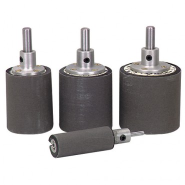

The reason I included it here is because you can buy spindels for it and Viola! it's another sander.
[attachment=2]Drill press sanding spindles.jpg[/attachment]

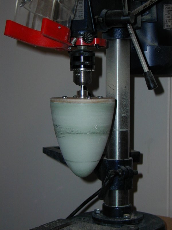

I have also used it as a vertical lathe for spinning things like nose cones or cylinder type parts.
As your part spins, you can sand it easily by stroking a piece of sandpaper up and down against your part by hand.
This is not my work but I have done this many times.
This is a Blue foam nose cone Plug for a WWII spitfire Model.
[attachment=1]spitfire02.jpg[/attachment]

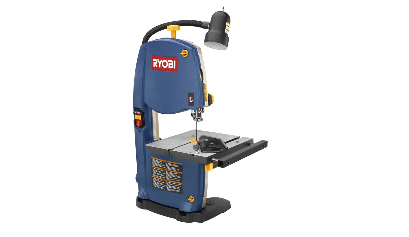

:cylon: Bench Top Band Saw
I use this one alot, Sometimes for pattern cutting but mostly for removing excess bulk material from my blank, starting the shaping process.
Works for wood and foam equally well.
[attachment=5]Ryobi Band Saw.jpg[/attachment]
Draw back, It will remove your fingers! (Be carefull :shock: )
Depending on your blade size, it is possible to do some limited scroll work. (Thin Blade)

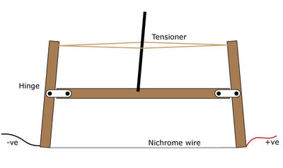

:cylon: Hand Held Hot Wire Cutters
When working with foam, carving or cutting, the hot wire cutter is the way to go.
you can make them yourself or buy commercial ones.
They are not that complicated. Hand held wire cutters are simply a bow to hold the wire and a power source to heat the wire.

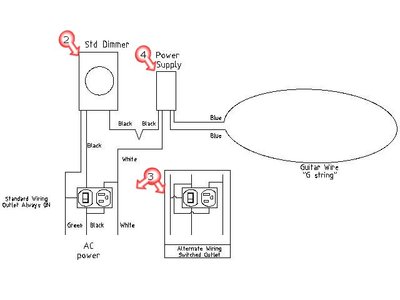

[attachment=2]DIY Hot Wire Cutter schematic.jpg[/attachment]
The wire can either be Nichrome (nickel chromium), Piano wire, Gutiar Strings etc.
Power source can be a simple door bell transformer, to a sophisicated regulated power supplies and I will cover those later.

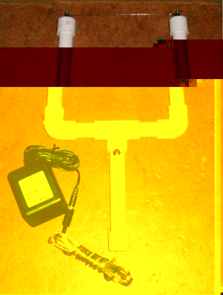

This one is a very simple economy Hot wire cutter made by Woodland Scenics and is available through Micro Mark
[attachment=3]Hand held Wire cutter Woodland.jpg[/attachment]

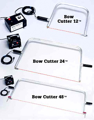

[These are long bows 12" 24" and 48" and are available from Abbeon Cal
[attachment=0]Long Bows.jpg[/attachment]

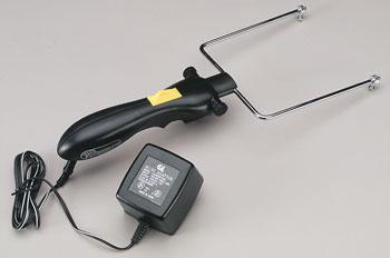

This one is made by Proxxon and is a premium cutter
You can buy as a set that comes with a rotory tool or you can buy the cutter by it self
I recommend buying the foam cutter separately because there are better rotory tools and I will cover that in a minute.
[attachment=1]Hobby-Hand-Wand.jpg[/attachment]
Check this one out at Proxxon Tools

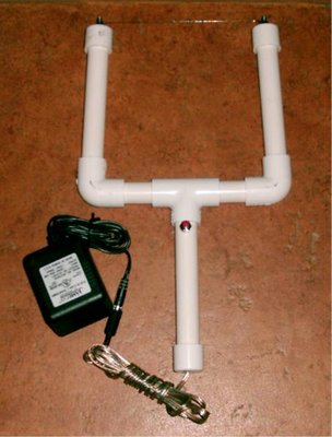

Here is a bow made from PVC. you can buy this one commercialy but is basicly a home brew.
[attachment=3]Hot Wire Cutter PVC.jpg[/attachment]
Here is the link
Moss Foam

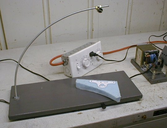

[attachment=2]Hot Wire hand_cutter_lg.jpg[/attachment]
Here is the plan

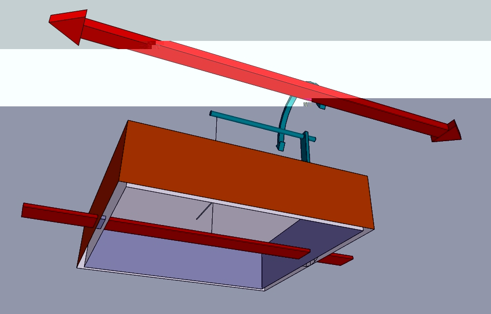

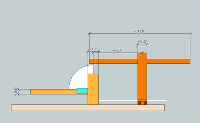

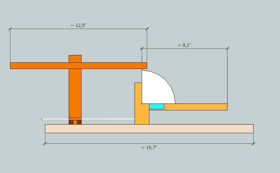

This is a typical bow with an opposing tension spring (Loop of twine twisted with a dowel rod)
[attachment=0]Hot Wire Cutter Bow Drawing.jpg[/attachment]
Here is the link for the plan

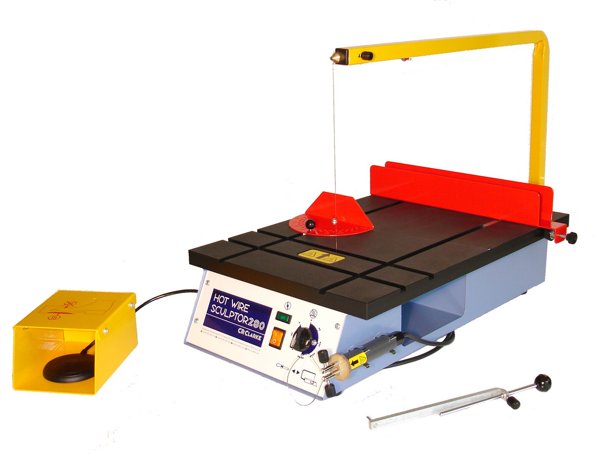

:cylon: Commercial Hot Wire Scroll Saws

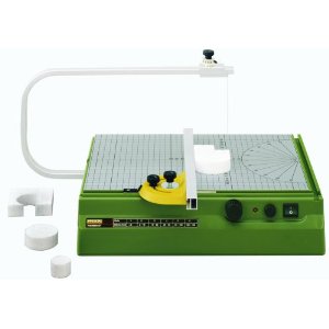

:cylon: This first one is made by Proxxon
and I have used this one many times and it is a great machine.
[attachment=6]Proxxon Hot scroll.jpg[/attachment]
:cylongold: This is a 3D Scroll Table by Hot Wire Foam Factory :cool: Very Cool!
It can be used as a Scroll, Mill, Lathe, very versatile machine!
[attachment=5]Scroll Saw 3D.jpg[/attachment]

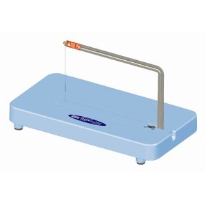

:cylon: This one is also from Hot Wire Foam Factory
and is a simple crafters scroll.
[attachment=4]Crafters scroll.jpg[/attachment]

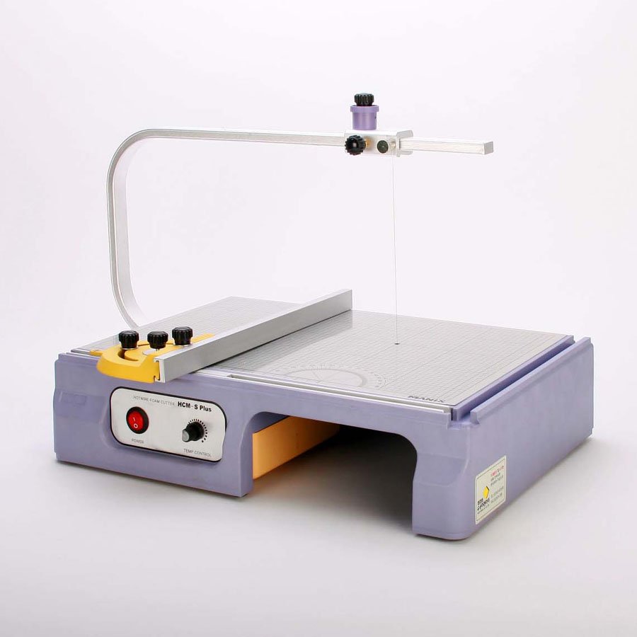

:cylon: This one is available from Alibaba.Com
and is unique in that it has a raised table with a cavity under the cutter for versitility.
[attachment=2]Hot_Wire_Foam_Cutter 1.1.jpg[/attachment]

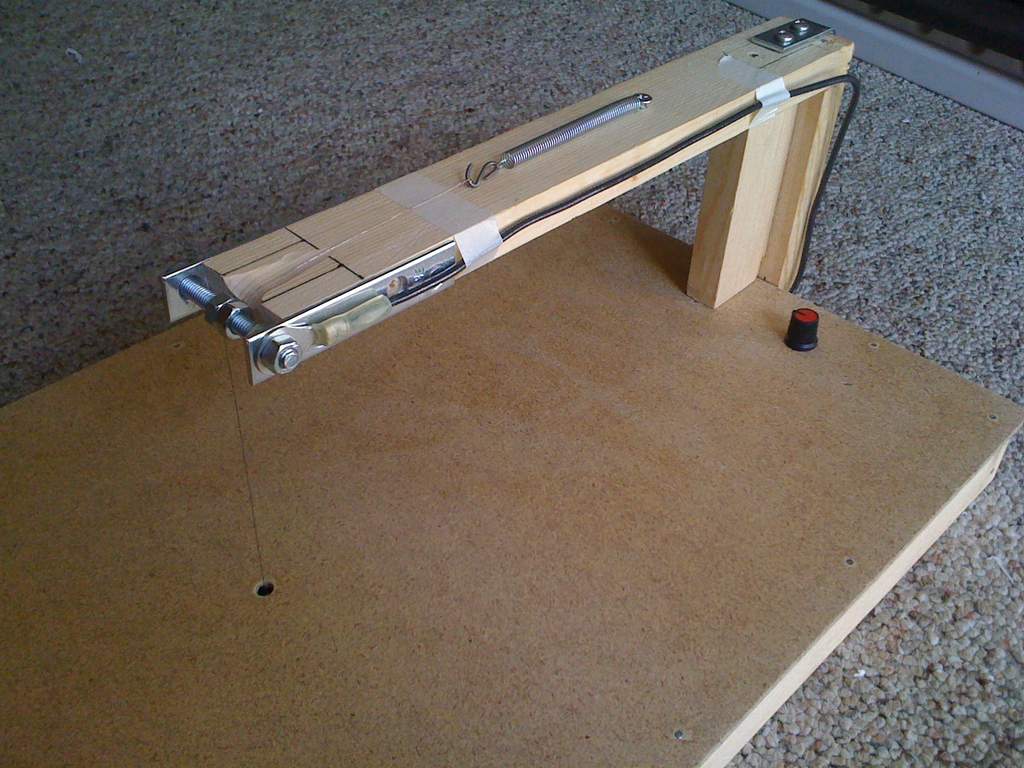

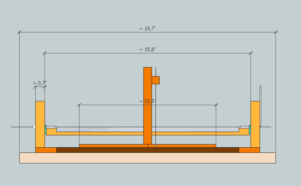

:cylongold: DIY Hot Wire Scroll Saws
There are alot of DIY blogs, articles, Discussion boards etc. on this subject
I found there are alot of designs for home brew units, from really basic slap together types to designs that were well thought out and designed like commercial units.
I have gathered some examples, some with links and plans and some I could only find pics of but if someone wated to duplicate them it wouldn't be hard.
I love making my own machines. I don't think you should have to spend hundreds to thousands of dollars for a machine that you need. Especialy Vacuum form machines or hot wire tools. besides it gives you a certain amount of satisfaction when you can create a part with a machine that you built! It's kinda primal to me like the tribesman who cuts the tree, makes the bow and arrows, hunts and kills the deer with his bow an arrow, then cooks and eats the deer. That meat will taste much better than if you just go to the store and buy it!
Maybe that's a little extreme, but that's just me. :nah:
Ok Enough blathering! :smile:

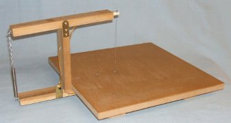

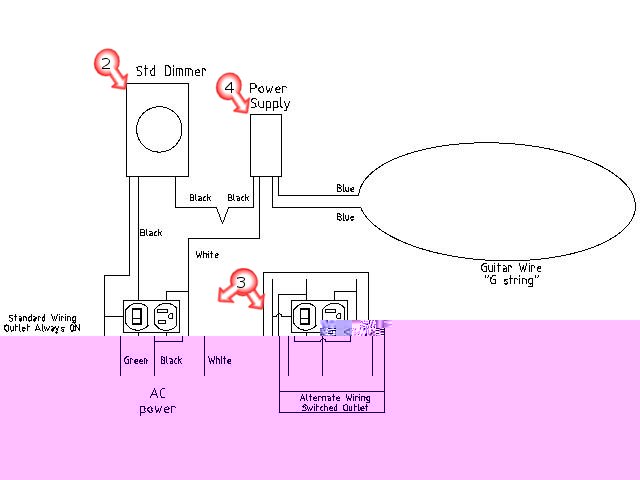

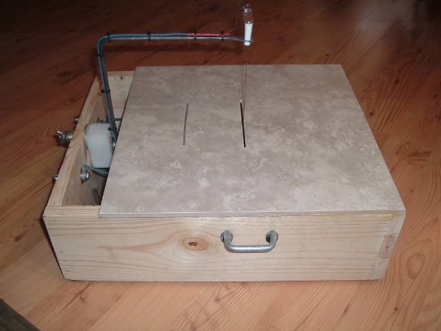

This machine was made by Andrew Tomasch
and is a good example of MacGyver-Ing :cool:
[attachment=6]Andrew Tomasch Hot Wire.jpg[/attachment]
This machine was made from parts bought from Home depot and the power supply is an old model train transformer

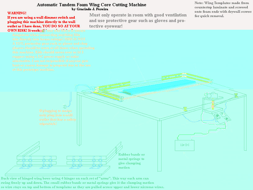

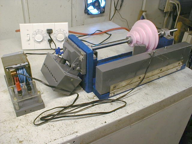

This next one is very popular with modelers and is made by joeboy@hhh. org
[attachment=5]hotwire_foam_cutter_joeboy@hhh.org.jpg[/attachment]

This one was built by Daniel B. Hartman and the name of his site is Dan's Workshop
[attachment=3]foam_cutting_table Dan's Workshop.jpg[/attachment]
Here is another Hot Wire machine Dan built and I thought is was so cool that it just went on my list! :cool:
[attachment=2]00-The_foam_cutting_lathe Dans Workshop.jpg[/attachment]
This one I found on The RPF site and was made by Rick Hanson
[attachment=1]table1rpf.jpg[/attachment]
Here is one I found at Model Airplane Pages.Com
Designer and builder Unknown
[attachment=0]vert_cutter_lg.jpg[/attachment]

Post by Big Al » Sat Jul 09, 2011 4:09 am

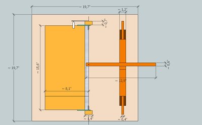

:cylongold: DIY Hot Wire Scroll Saws Cont.

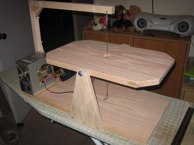

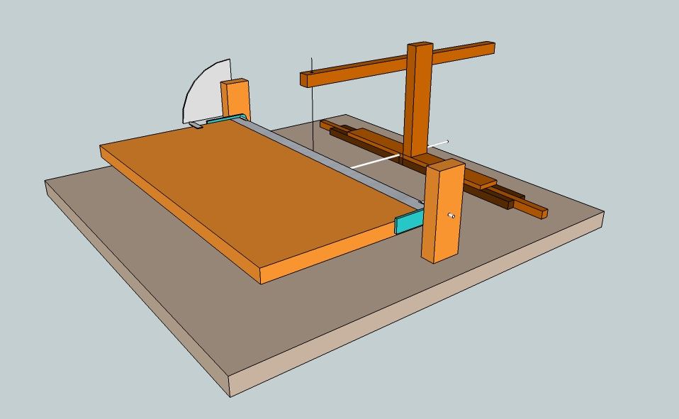

This next machine is awsome! I found it on R/C Group. I'm not sure who designed it or who built it.
But here are the cad drawings.
[attachment=5]Hot_wire_tiltable_table 1.jpg[/attachment]
[attachment=9]Cross_Table_1.jpg[/attachment]
[attachment=8]Cross_Table_2.jpg[/attachment]
[attachment=7]Cross_Table_3.jpg[/attachment]
[attachment=6]tiltable_table_top.jpg[/attachment]
[attachment=4]tiltable_table_back.jpg[/attachment]
[attachment=3]tiltable_table_right.jpg[/attachment]
[attachment=2]tiltable_table_front.jpg[/attachment]
[attachment=1]jig.jpg[/attachment]
[attachment=0]jig2.jpg[/attachment]
I like this one alot and if you want to put some time in on this build it will pay off in that the addition of a tilt table allows for miter cuts.
More to come

Post by Big Al » Sat Jul 09, 2011 5:05 am
:cylongold: DIY Hot Wire Scroll Saws Cont.2

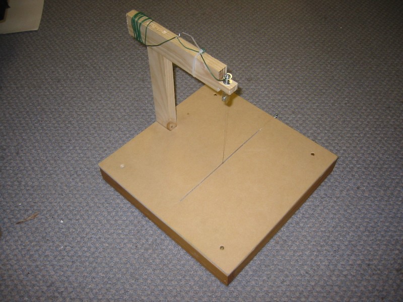

Here is another tilt table type. And here are the PDF Plans [attachment=2]DIY Foam Cutter Plans.pdf[/attachment]
[attachment=6]diy-hot-wire-foam-cutter.jpg[/attachment]
[attachment=7]Cutter w tilt table.jpg[/attachment]
Great looking machine! :cool:
and again the tilt table adds to it's versatility.
This one I found on R/C Groups. No Plans but very neat just the same.
You can use a battery pack or hook it up to a power supply.
[attachment=1]foam_scroll_cutter_table_002.jpg[/attachment]
It's a small machine But it's not the size that matters it's how you use it! :lol:
I'm sorry it's late and some times the jokes are just for me. :blush:

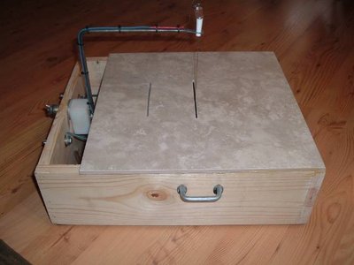

This machine is ok but it is a little small. Although you can make parts with it, if you want to make bigger plugs you will need a machine of a little more stature.
This table is battery operated
[attachment=5]Home made Battery scroll no Plans 1.jpg[/attachment]
[attachment=4]Home made Battery scroll no Plans 2.jpg[/attachment]
All of these tables are great for cutting foam and can be built from parts you can get from any Home center.
[attachment=0]DIY hotwire_foam_cutter_m.jpg[/attachment]
There is no need to go over power supplies because power supplies are easy.
Some designs use a doorbell transformer but you have to make some circuitry so you can control the voltage. or you can utilize a model railroad transformer with the control circuitry built in. If you have a regulated switching power supply it will work awsome!
This is a special machine that we use to make foam core wing for model aircraft. It's a cool machine and I wanted to included it in this section but I don't know how it could be used to make Cylons i just wanted you to see it.
[attachment=3]JPWingMachine1.jpg[/attachment]
More to come
