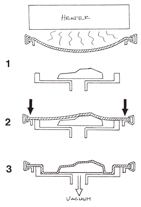

:cylon: Here is the Three step Process of Vacuum Forming a Part
[attachment=1]Vacuum_Forming_Process_pg6.gif[/attachment]
:arrow: Stage 1: Heat your Plastic untill it sags :twisted: Caution! :twisted: To much sag can ruin yer part!
:arrow: Stage 2: Transport Your Saggy Plastic to your Plug
:arrow: Stage 3: Vacuum pull the Warm Saggy Plastic over your plug forming your part.
Simple huh?.......Well let me tell ya that one wrong move or wrong plastic selection or under heating the plastic, over heating, or a number of things can ruin your part....
The most common deffect that occurs is webbing. This can be caused by lack of vacuum, Not applying your saggy plastic evenly over your plug during pulling, or premature cooling of the plastic (Thermal difference from one side of the plastic or spot cooling)
Blisters and bubbles can occur in clear plastics if you over heat the plastic or heat it to rapidly.

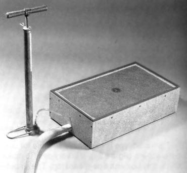

I do not recomend useing or building the "Vacuum Box" Type of machines because you have to use your kitchen oven to heat your plastic then move it over to your box and it can result in a bad part not to mention stinking up the house with melting plastic chemical smell. There is a risk of fire as well.
:cylon: Here is a Type 2 Vacuum Box with a modifide Bicycle Hand Pump. It Works! ....but has alot of drawbacks!
[attachment=0]Type_2_Vacuum_Box_pg64.jpg[/attachment]

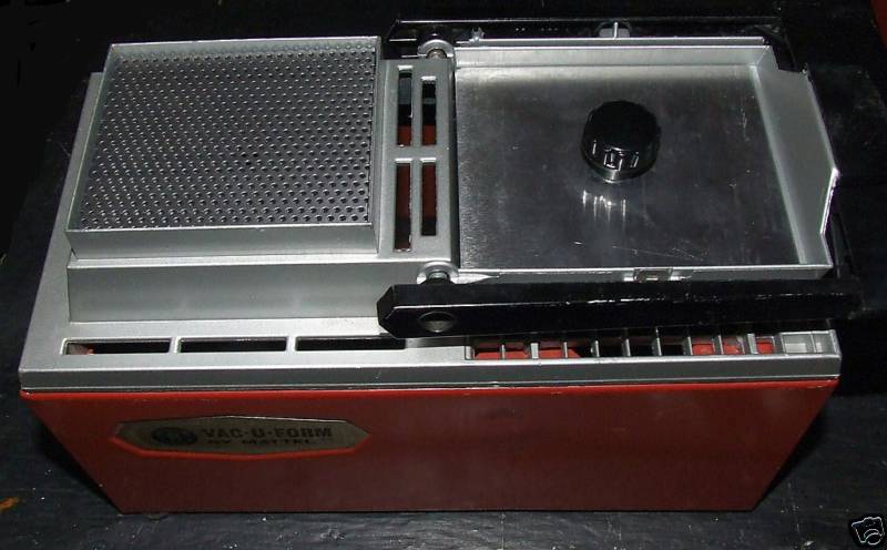

:cylon: This is the Vac-U-Form by Mattel and came out in the late sixties.
[attachment=9]Vac u form 1.jpg[/attachment]
[attachment=8]Vac u form 2.jpg[/attachment]
Cool huh?......It came with all kinds of plugs for making car bodies for your hotwheels as well as alot of other plugs for making many things.
[attachment=0]Vac-U-Form Poster.jpg[/attachment]
This machine, as small as it is, is a Flop Over style or also known as a Flip Flop style.
These are still available today and are a great introduction to Vacuum Forming.
You can get these on E-bay all day long!
E Bay Vac-U-Form Listings

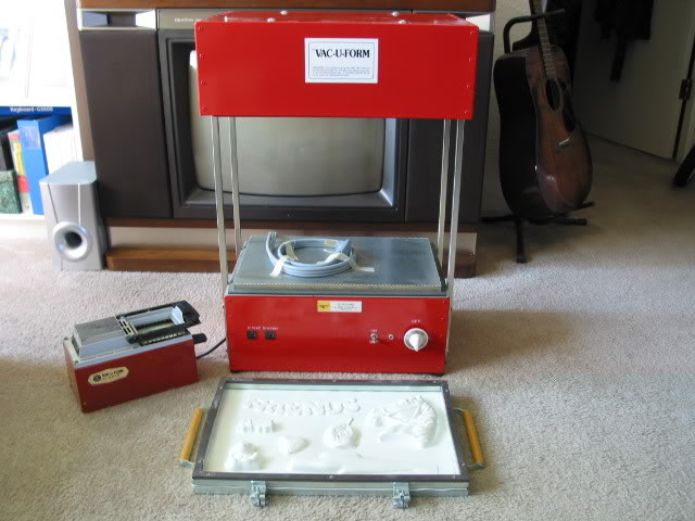

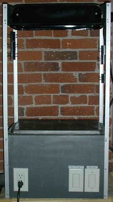

Later They made a larger desktop version similar to the machine I was looking for. The coolist part about this machine is the Heaters.
Unfortunatly they made very few of them and are hard to find. I found pics of this one on the net.
[attachment=7]RedVac-U-Formmachine.jpg[/attachment]

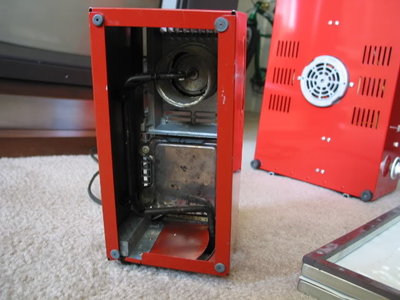

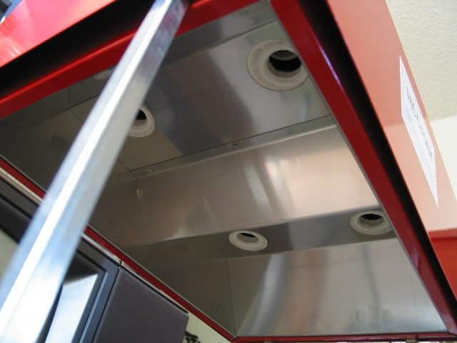

:cylon: Here is a shot looking at underside of the oven
[attachment=6]RedVac-U-Formoven.jpg[/attachment]

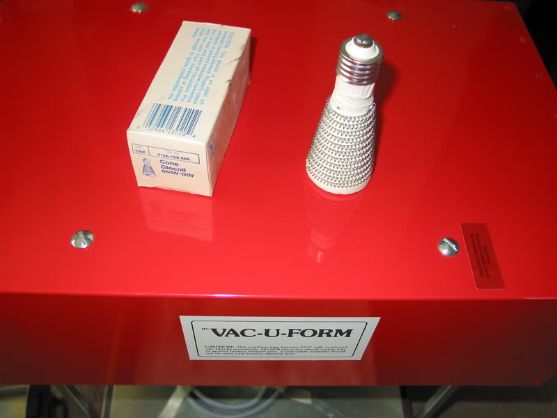

:cylon: These are the Heaters. they are a ceramic type that screw into sockets like a light bulb.
[attachment=5]RedVac-U-Formheatingelement.jpg[/attachment]

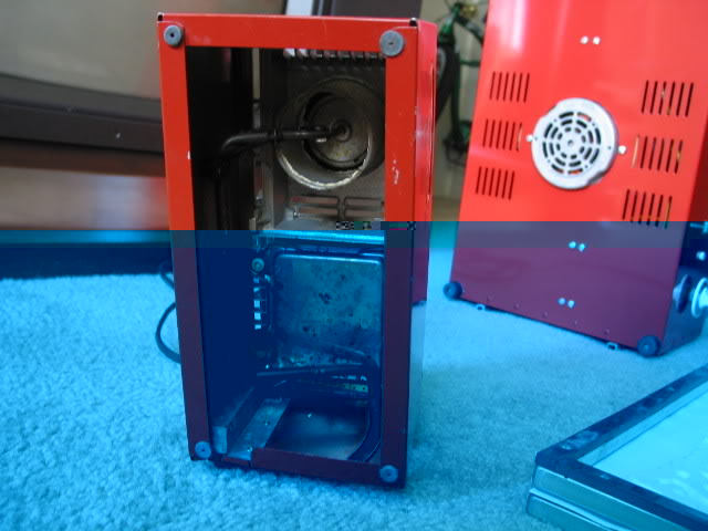

:cylon:The last one shows how the plumbing, electrical and Vacuum motor and how everything is contained in the base.
[attachment=4]RedVac-U-Formbaby.jpg[/attachment]

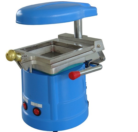

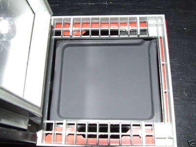

:cylon: This next Machine is used in dental offices for making teeth impressions and is a little pricey for the limited use.
:cylon: I like the Blue one! :wink:
[attachment=3]Dental Form.jpg[/attachment]
I have never used one of these machines and from the looks it appears to be a plunge type.

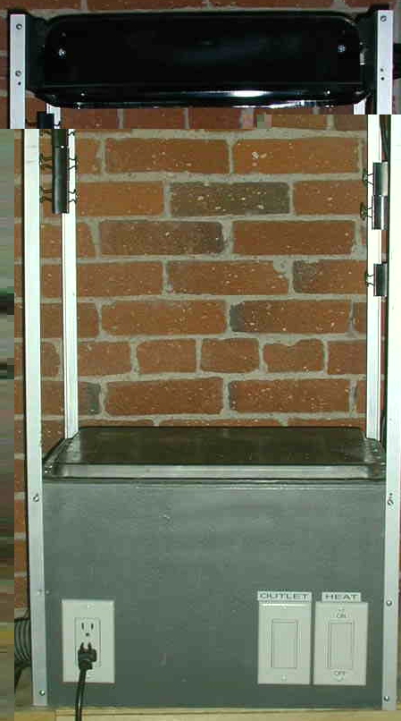

:cylon: Next is the Commercialy built Vacuum box. Too Pricey and Not enough features for my likeing.. However you can buy them in different sizes for larger plastics and they do work!.
[attachment=2]VF-12x12-VAC_FORMER-2T.jpg[/attachment]
Here is the link for the Vacuum Box if you wish to explore the sizes and pricing but again I do NOT Recommend these.

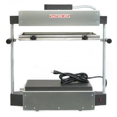

:cylon: Here is one I Like very much. :salute:
This is a Table top unit made by Centroform called EZ Form. Very cool machine but again a little pricey (Around $900).
[attachment=1]centroform-ezform-sv-1217-220v-tabletop-vacuum-forming-machine-B.jpg[/attachment]
You can purchase these machines from Robot Shop

If you noticed the machines have 2 methods of plastic transport the old Vac U Form has a "Flop Over" Operation but the Proform Dental has a straight plunge down over your plug. I found the latter to be the best for the most consistant pulls.
The flop over method, works good but in some cases you have problems because when the plastic is ready, the trasport flops over and makes initial contact with you plug at a 45 degree angle and pulls unevenly sometimes ruining your part.
Just my 2 bits

:cylon: The Next topic is the Ralis Kahn Machine!
The photo is Ralis Kahn's machine and This is the machine I decided to build and it works great!
It's been awhile since I read his bio and reviewed the plans but I believe he makes costumes and props and you can find out everything you want to know at the link below.
The link takes you straight to the building blog for this machine and it's worth it!
The best part is you can get all of the parts at your hardware store! The Oven/Heater unit comes from Wall Mart (Sunbeam Portable Electric Grill) and is a breeze to assemble.
Holloween Fear.Com, Ralis Kahn Machine
This is the Machine I would recomend as a first build instead of starting with small box type units an working your way up. to me it's a waste of time and money to build a unruly box type when what you need is machine capable of pulling all the size parts you need from big to small!
This is a great machine, I built mine to exact specs with the single stage Shop Vac and successfully pulled many parts, then I modified my machine for 2 stage operation.

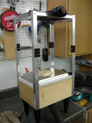

This is pic of a Ralis Kahn Machine built by a guy in New York [attachment=0]Ralis Kahn Mod 1 Large.jpg[/attachment] You can see he has modified the machine build to his likeing and it looks great!
This machine will make alot of large size parts but is a little small for things such as chest plates and back plates.
My main use for this machine was for making Clear Canopies and Cowlings for my models and worked Great!.
For really deep pulls, such as pulling a cowling for a 7th scale P-47, it was necessary to make a 2 section plug then cut and mate the parts using plastic fill to hide the seam, sand then paint. A little more work to get the part I wanted but still works great!

:arrow: Single Stage Vacuum Cleaner Motor 3.7 to 4
:arrow: Two Stage Vacuum Cleaner Motor 5.6 to 6.6
:arrow: Mouth Suction 15
:arrow: Hand Pump 27+
:arrow: Modified Tire Pump 27+
:arrow: Electric Vacuum pump 27+
:arrow: Air Vacuum Pump 27+
:arrow: Air Compressor (used as Vacuum Pump) 27+

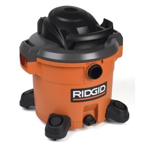

:cylon: SHOP VACS! Every man has one! or should have one and I don't mean the little apartment dweller kind, I mean at least a 12 Gal. these seem to have enough vacuum to pull some good parts as a one stage and they make a great first stage for a two stage!.......did ya get that? :wtf: LOL!
[attachment=7]Ridged Shop Vac.jpg[/attachment]
Here is the link Home Depot Shop Vac
You can pick up these kind of vacs around 50 to 80 bucks and they are well worth it!
Used ones arn't that bad either and you can get those for even less but the vacuum must still work good or you should just buy a new one. Used vacs somtimes have broken blades or cracked fans and will not provide a good suck! :nah:
I use one of these type of shop vacs and mine is a 10 Gal. but the new ones are 12 gal.
Most Shop Vacs pull between 3.7 and 4 inches of vacuum so you want the vac to be at the higher end and the bigger vac does the job!
There are alot of ways to create vacuum the shop vac is the first because it's the most basic.

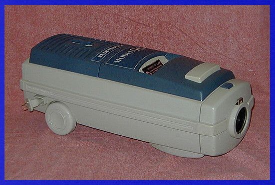

The alternate to the shop vac is the Electolux style vacuum canister.
[attachment=6]Electrolux3vac.jpg[/attachment]
I know guys who use these and get good results! I don't have the specs on the vacuum but my friends use them so they must be suitable. These are very easy to intagrate into a machine.
My Mother had one of these!... :lol:

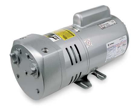

This next one is the one I have and it's a 3/4 HP Rotory Vane Pump and is awsome!.
This is a Gast Pump and can be purchased through WW Grainger.
[attachment=3]Vacuum-Pump-4F741_AS01.jpg[/attachment]
Here's the Link: Grainger/GAST-Vacuum-Pump

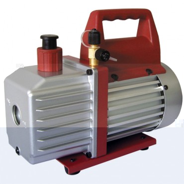

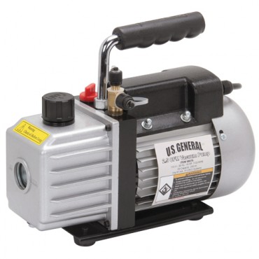

Although I would highly recommend one if you have the means, the gast is kinda high end and you can still get some great results with these type of pumps that are made for air conditioning system evacuation and the don't break the bank!
[attachment=2]image_1813.jpg[/attachment]
You can buy these pumps from Harbor Freight and they work extremely well!
Harbor Freight Two-stage-3-cfm-air-vacuum-pump
Here's their smaller one
[attachment=1]image_4020.jpg[/attachment]
25-cfm-vacuum-pump

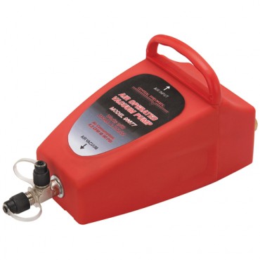

They also carry this particularly handy and extremely nifty device!
[attachment=0]Air Vacuum.jpg[/attachment]
This turns your Air Compressor into a Vacuum source! :blink:
Air to Vac Device
I have one of these and it works great if you have a med to large air compressor.
