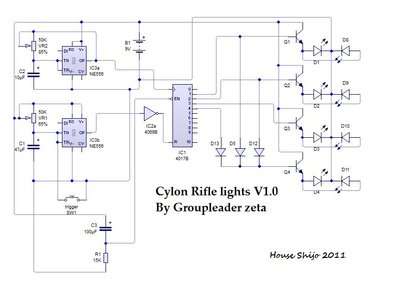

Due to me having little time to work on many items. I decided to post the circuit I designed for the rifle light sequencer for those that want to make one. Adjust VR2 for speed, VR1 is for the reset.
questions, I will do my best to answer.

That's really cool, unfortunately for me it looks like the way to grandmas house. Is that in Greek? Lol thanks! Maybe it's time for me to learn how to read schematics.

I guess my grandma was Greek, and I never knew it...LoL....I read it like a road map. Love it. Thanks. Can it handle the super bright white LED's?

possible, I have never tried them. The maximum current draw I have used was 40 mA on each output. The chips are inexpensive to test if damaged you out about $.40. For me I would use 2N3904 NPN transistors between chip output and LEDs to be on the safe side, they can handle 500mA. Don't forget at lease a 1 Ohm bios resistor between base of transistor and chip output!
