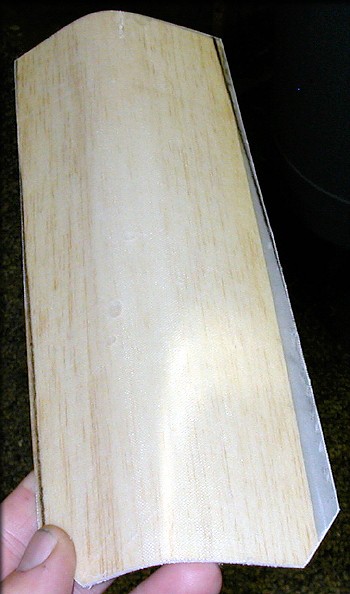

One of the basic concepts in composite construction is that if you can use a core of some kind, to separate your outer pieces a bit, you can increase it's strength and stiffness. Today, there are a huge variety of possible core materials you can experiment with, from some rather expensive synthetic foams, to something as simple as balsa. If you haven't tried this yet, you'll be completely amazed at how much difference a simple piece of 1/32" balsa can make on a molded part, for almost no weight gain.
:cylon: Another product that would be difficult to keep light, by hand. This landing gear door is a glass/balsa/glass sandwich, and weighs 2 ounces. Thanks to the 1/32" balsa core, it's extremely stiff.

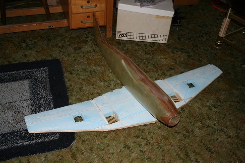

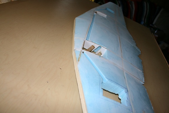

:cylon: Here is a plane we are building right now
WWII Russian Mig I-220
The Fusalage is simple molded fiberlass cloth vacuumed bagged around a plug ( we will insert flat wooden formers later for strength)
[attachment=2]IMG_1934.jpg[/attachment]
The wing core is cut from blue foam cut and constructed with bracing and spars (5/8' 5 layer plywood and 1/8th 3 layer plywood) and then it will get a layer of 1/ 16th balsa sheeting, Then glass cloth for a skin
[attachment=1]IMG_1940.jpg[/attachment]
[attachment=0]IMG_1942.jpg[/attachment]
The Balsa sheeting and the Glass cloth will be applied at the same time with the epoxy resin, then vacuum bagged creating a completly bubble free bonding also creating a very smooth, clean surface.
This process maks parts "STRONG LIKE BULL" !!! :cool:
