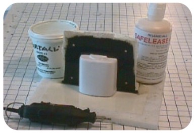

:cylongold: Making a Fibeglass Mold Cont.

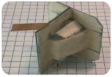

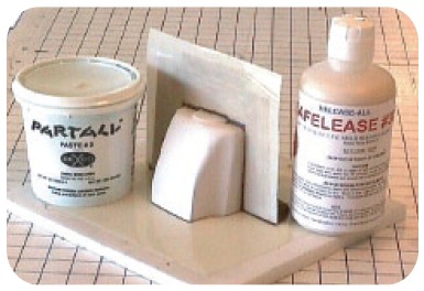

:cylon: Step 2

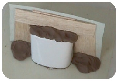

The parting board is simple, a few scraps of balsa wood glued together to form a U shaped partition that fits over the cowl. In order to achieve a smooth glossy surface on the mold, a piece of .014 Mylar is contact cemented to the balsa scraps. Similarly the mold surface along the back edge of the cowl is defined with a scrap of foam and a sheet of Mylar. The cowl pattern and the parting surface forms are held in place with Chavant modeling clay on the back of each surface.
[attachment=1]Cowl Mold 2.jpg[/attachment]
:cylon: Step 3

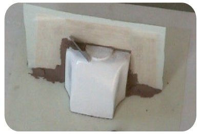

Around the edges of the cowl pattern the small openings must be sealed. This can be done with modeling clay by pressing clay into the corners and openings then trimming away the excess material with a model knife or razor blade. In this case, the light weight plastic pattern can be distorted if you press to hard. So be careful that the intended shape is preserved.
[attachment=0]Cowl Mold 3.jpg[/attachment]

:cylongold: Making a Fiberglass Mold Cont. 2
:cylon: Step 4

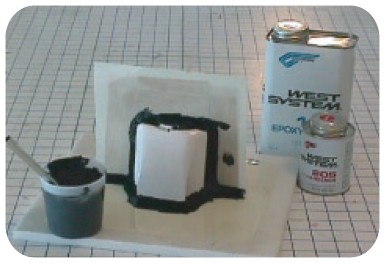

After all the excess clay is removed, the surfaces of the pattern and parting surfaces must have mold release applied. It is important to apply both Partall mold release wax and a liquid mold release. The Partall wax is applied by wiping on a layer waiting a few minutes for the wax to harden then buffing off the surface to a shine. The waxing is then repeated; the number of times will depend on the surface. If you have a glossy completely smooth surface like the Mylar plastic, two or three coats of wax will be enough. However if the surface has any potential for porosity or tiny bubbles in the surface finish, up to ten coats of wax are needed. These layers of wax will fill the tiny surface imperfections. If you have any doubt about the surface, add a couple more layers of wax. The epoxy will lock into these imperfections if you don't use enough wax. Then apply a complete layer of liquid mold releases. I recommend the Safelease products as they can be wiped on with a cloth and dry in about 30 minutes.
[attachment=1]Cowl Mold 4.jpg[/attachment]

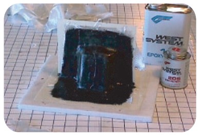

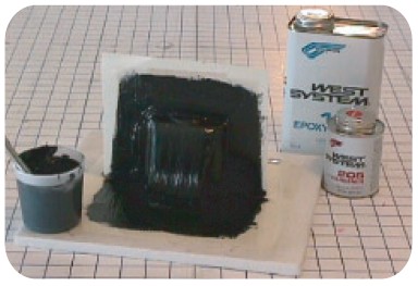

:cylon: Step 5
Now you are ready to start applying the layers of epoxy and glasscloth. Use the following West System materials: 105 Resin is a low viscosity resin that easily wets out the cloth and allows you to minimize air bubbles between cloth layers. 205 Fast Hardener allows you sufficient time to wet out each layer, then gels up quickly so that the mold building process can be completed in a few hours. 406 Colloidal Silica Filler is used to thicken the epoxy system to aid in applying epoxy to vertical surfaces and filling corners and details in the mold. 423 Graphite Powder is used to give the tooling gel coat layer of the mold a black color and a harder surface.
[attachment=0]Cowl Mold 5.jpg[/attachment]

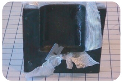

:cylongold: Making a Fiberglass Mold Cont. 3
:cylon: Step 6

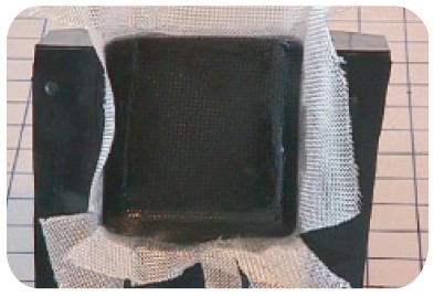

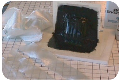

The black color is important when wetting out glass against the mold surface because air bubbles and dry places in the glass are white while the properly wet out glass is transparent showing the black surface. The high contrast makes it easier to produce high quality parts. Mix tooling gel coat from West System 105 Resin with 205 Hardener and about a teaspoon of Graphite Powder. Then stir in a little Colloidal Silica to get a mixture that has the viscosity of ketchup. You need to be able to brush on a thin layer, (.010" to ,020") and have a mixture that will stay on the vertical surfaces. Begin by brushing a thin layer in all of the corners. Be careful to not trap any air in the corners as you apply this layer, this is a common problem particularly if you mix the gel coat to thick.
[attachment=1]Cowl Mold 6.jpg[/attachment]

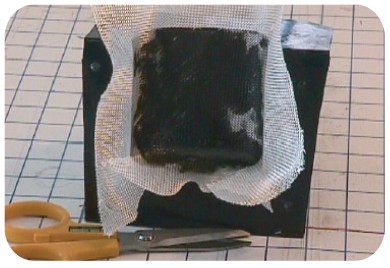

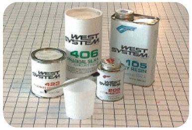

:cylon: Step 7
Now apply the gel coat layer over the remainder of the surface. Next mix a little more Colloidal Silica into the resin in the pot to increase the viscosity. Apply some additional gel coat to the corners of the mold to fill in any small radii corners. It is difficult to wet out the glass cloth and keep it in corners of less than 1/4" radius. By filling the corners now you are making the glass application easier.
[attachment=0]Cowl Mold 7.jpg[/attachment]

:cylongold: Making a Fiberglass Mold Cont. 4

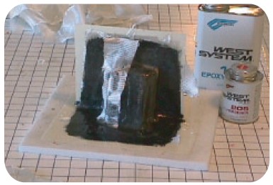

:cylon: Step 8
Use a coarse weave glass to lay up the mold. I recommend CST style G3733 glass, it is about a yard square. It wets out easily and builds up thickness more quickly than lighter materials. If the mold has a complex shape like the cowl mold we are building cut the glass on the bias so the fibers run on a diagonal and cut the material into strips 2 to 3 inches wide. This way the cloth will stretch and distort as needed to follow the surface.
[attachment=1]Cowl Mold 8.jpg[/attachment]
:cylon: Step 9
Let the gel coat layer of epoxy set up for about 30 minutes. The epoxy should have set to the point where the surface is only a little tacky. Now mix up another batch of West System Epoxy 105/205 and brush a liberal layer on top of the gel coat layer and begin laying strips of glass on the surface. Whenever possible, apply the epoxy first then lay the dry cloth down. This wets out the glass from the bottom displacing the air in the fabric with less chance of trapping air under the layer of fabric.
[attachment=0]Cowl Mold 9.jpg[/attachment]

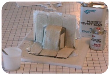

Because the mold will need to be strong and rigid, we need to build up the thickness of the mold. An easy way to do this is to add a layer of Coremat. It is about 1/10 inch thick and can be easily cut to any shape. Cover most of the area with Coremat or a thin chopped strand mat could also be used. Wet this layer well and let the epoxy set up for about 30 minutes then apply another layer of glass cloth as you did previously.
[attachment=0]Cowl Mold 11.jpg[/attachment]

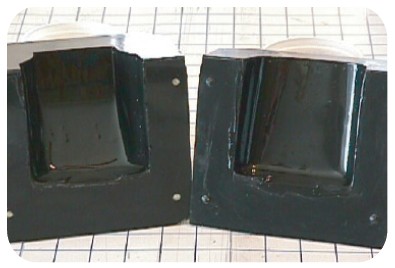

:cylongold: Making a Fiberglass Mold Cont. 6
:cylon: Step 12

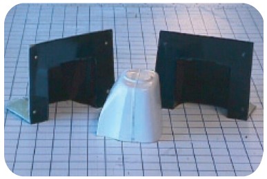

Set the mold aside and let it cure overnight. The next day remove the vertical parting board that the vertical surface of the mold was built against. Clean up any clay that may be left on the pattern.
With a Dremel tool and a 1/4 inch ball cutter, cut four small recesses into the vertical parting surface corners about 1 inch away from the pattern. These will key the second half of the mold into the first half. Now repeat steps 6 through 11 above to build a second half of the mold against the first half. Mold release, gel coat, glass cloth, Coremat, glass cloth and let it cure overnight.
[attachment=1]Cowl Mold 12.jpg[/attachment]
:cylon: Step 13
The next day remove the foam base and Mylar layer from the aft edge of the cowl. Then use a Dremel tool with a reinforced cut off wheel to trim all the rough edges off of the molds. Now carefully separate the mold halves. You may need to use a model knife in one corner to start separating the molds. Twist the knife a little then put a thin strip of wood or plastic in the space and run it around the mold to separate the halves. The mold is now completed and you are ready to start molding fiberglass cowls.
[attachment=0]Cowl Mold 13.jpg[/attachment]

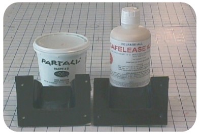

:cylongold: Molding Fiberglass Parts
:cylon: This is the next tutorial after you make your mold is to make a part.
:cylon: Molding Fiberglass Parts

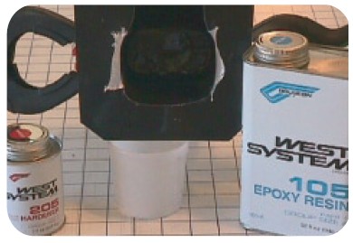

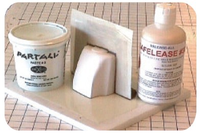

Apply mold release to all the surfaces of the new mold. If this is your first mold, it is likely that you will have some small air bubbles in the corners. These must be filled with the mold release wax. Make sure that all surfaces are covered, including the edges and back of the mold with a few coats of wax. When you are making parts the epoxy can go everywhere and this makes it easier to clean up the mold. Use many coats of wax. If you need a number that will work in all cases, apply ten coats of wax. Then apply a liquid mold release to the mold surface.
[attachment=2]Molding 1.jpg[/attachment]

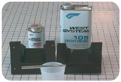

:cylon: Step 1
Use the same West System Epoxy that was used to build the mold for the parts. Mix up a small batch of West System 105/205 for the gel coat layer, and brush it over the mold surface. If you have any small radii corners in the mold, mix a little 406 Colloidal Silica Filler into the remaining epoxy and fill these corners. Glass cloth will not stay in these tight corners and as it pulls away it will pull in air to form a bubble.

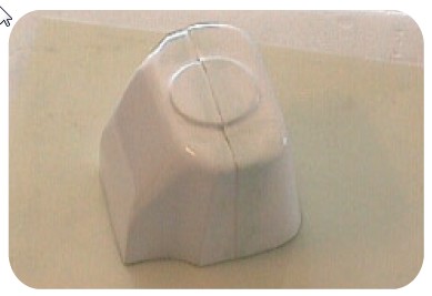

:cylon: Step 7

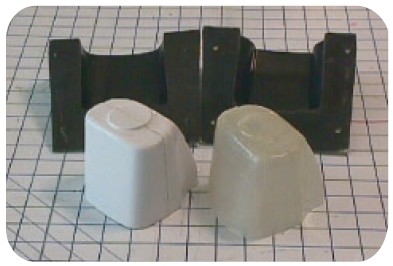

Let the cowl cure overnight before you remove it from the mold. Start at one corner and separate the mold halves with a model knife. As soon as the corner starts to open use a thin strip of wood or plastic to open all the edges of the mold. Now carefully remove the part from the mold.
[attachment=1]Molding 8.jpg[/attachment]
:cylon: Step 8
You now have a fiberglass part that is an exact duplicate of the pattern. It
