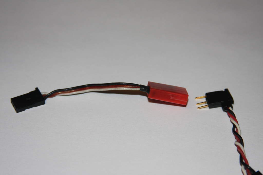

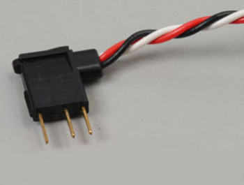

:cylon: I know I'm late with this info but you said you did a quick search and couldn't find anything and this is a subject I am all to familar with. So maybe this will help for future instalations or anyone else who wants to tackle a project involving R/C and servos.
All sevos will work with any system if the wires line up correctly!
For years the Radio companies had no other way of prioritizing their servos to their equipment other than a distinctive plug for each manufacturer.
For the hobby guy's, this is a pain in the @$$!....unless you know their dirty little secret! :nah:
All sevos, no mater how old, have 3 wires, Positive, Negative, and a signal wire.
Sometimes it's just as easy as removing the wires from the connector block then re-aranging them to the correct configuration for that particular manufacturer.
Conversion jumper leads work fine! with one draw back in that it makes more connection nodes for something to go wrong. :erk:
This is a big concern for model aircraft but not so much for robot dog's :salute:
With that said, Here are the different servo plug types
:cylon: 1970's Futaba "G" type Connector
[attachment=7]Futaba G 1.jpg[/attachment]
:cylon: This is a Futaba adapter from Old "G" type to new "J" type
[attachment=6]Futaba G adapter.jpg[/attachment]
