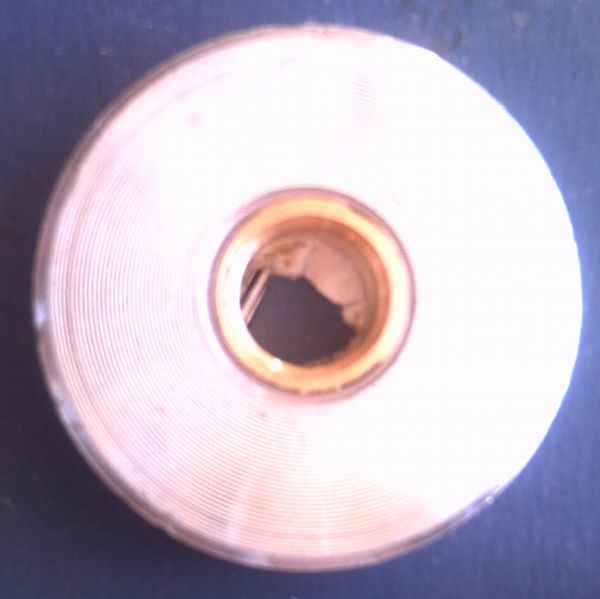

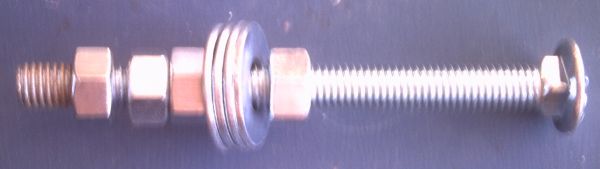

Post by groupleaderzeta » Sat Aug 27, 2011 4:45 pm

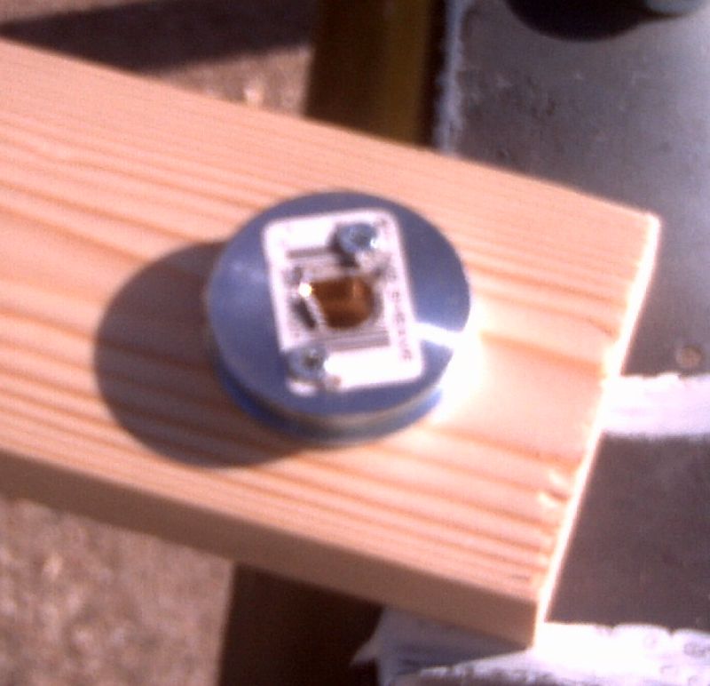

My next big project is a roto-caster.
My inspiration...
I will be making a 24 inch machine from wood.

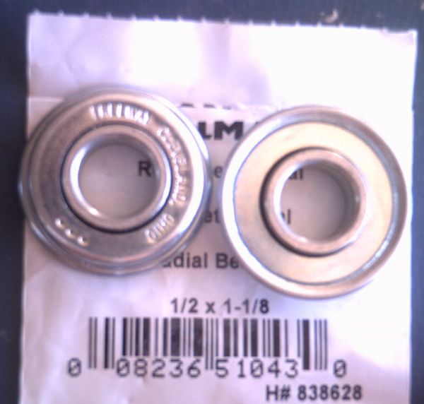

Bearings, large pulleys, and bolts (shafts) came from my local tractor supply store.

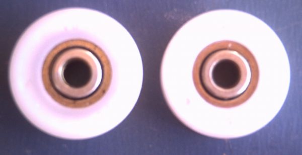

The small plastic idler pulleys are from the hardware and are for screen door repair.
It will be hand crank at first, I can add a motor later.

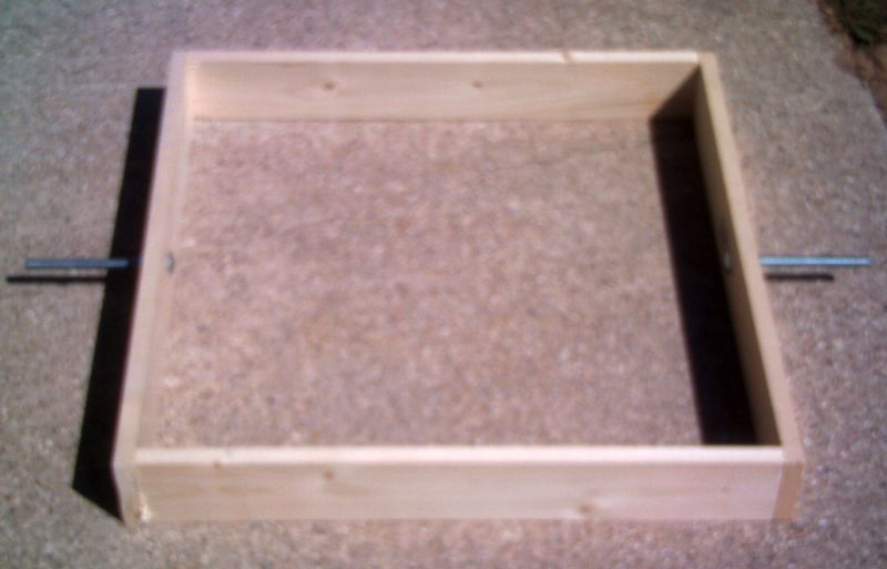

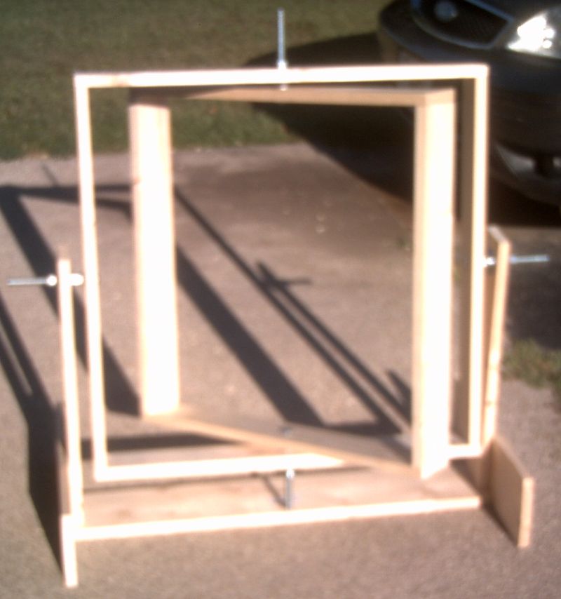

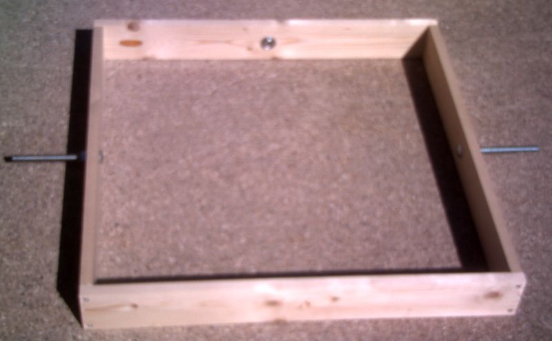

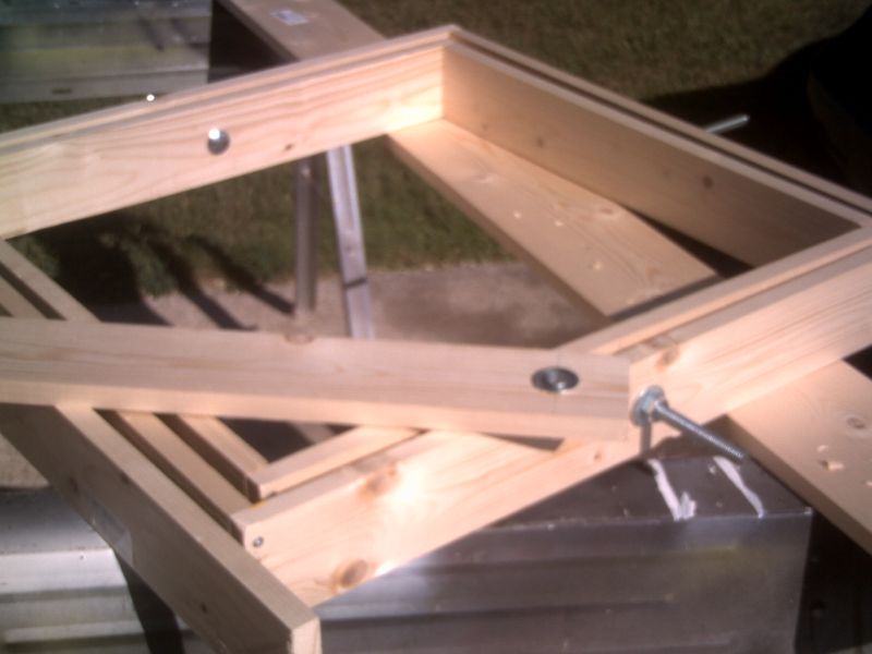

caster started. frame is done.
just need to cut off bolts, seal wood, and get the drive belt on.

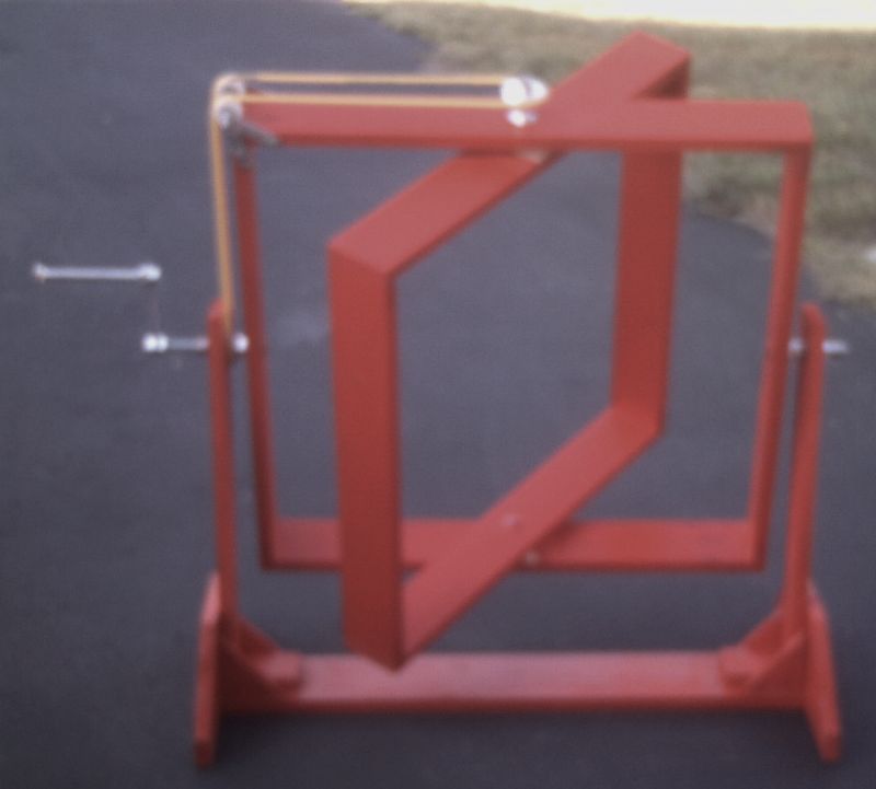

Post by groupleaderzeta » Thu Sep 01, 2011 7:47 am
The caster is nearly done. second coat of paint and counter weights and its done. :byyourcommand: :cylongold: :cylon: :salute:

groupleaderzeta wrote:The caster is nearly done. second coat of paint and counter weights and its done. :byyourcommand: :cylongold: :cylon: :salute:
Great Job!!!! What did you use as a drive belt?
Re: Zeta's Roto-casting machine build
Post by groupleaderzeta » Thu Sep 01, 2011 11:53 am
Its a round Rounthane Belt 1/4" dia. sold by the foot. Ordered it from Stock drive products.
the belt is like a tube, cut it to what length you need and use a metal connector to make it a endless belt.
https://sdp-si.com/eStore/PartDetail.as ... roupID=510
